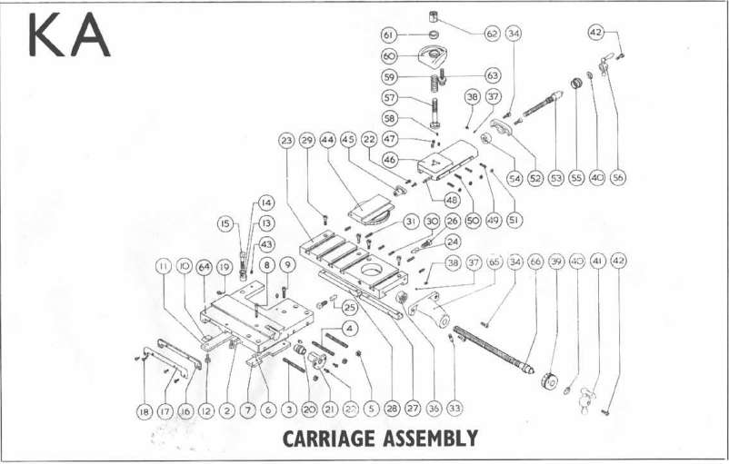

        The ML7-R was non Power Cross feed, and fitted with a 4 T-Slot Cross Slide as standard (Together with the ML-7 style of compound/topslide), with a longer 5 Slot version available as an accessory.
        The Super 7, both non and power cross feed, was fitted with a longer 5 slot cross slide as standard.
        Also on the Myford Ltd website, the excerpts from the Super 7 Power Cross feed model manual, on the Carriage Assembly spares page, shows the 5 slot cross slide as standard, so sort of shooting themselves in both feet!

          Yeah I saw the 5 slot in the parts catalogue and assumed it came from the factory that way. However the email from myford has raised doubts that it will fit.
          I’m inclined to think that it will fit my lathe though.

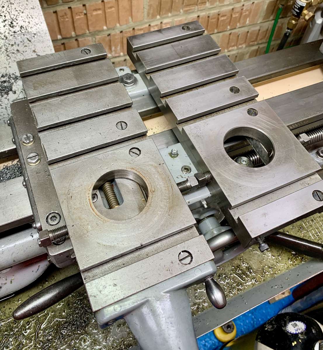

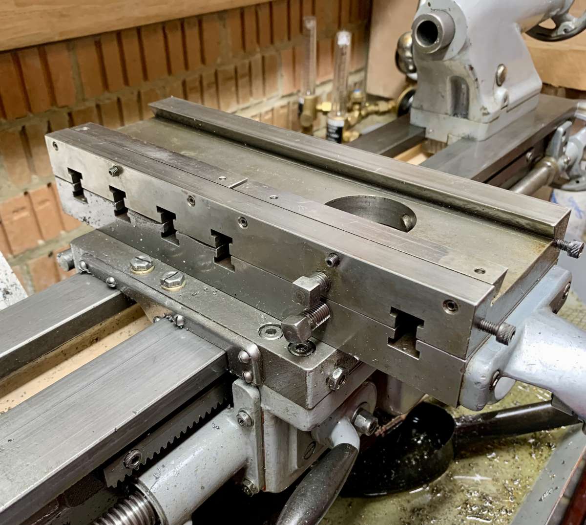

                  iI don’t know if this helps, but I have a standard Super-7, and wanted to find a replacement cross-slide for it, as the original had been abused in the past.
                  I bought a s/h item from a later power cross-feed machine, and it’s identical…. It also shares the same part#’s in the Myford parts lists too.
                  IMG_4922IMG_4921

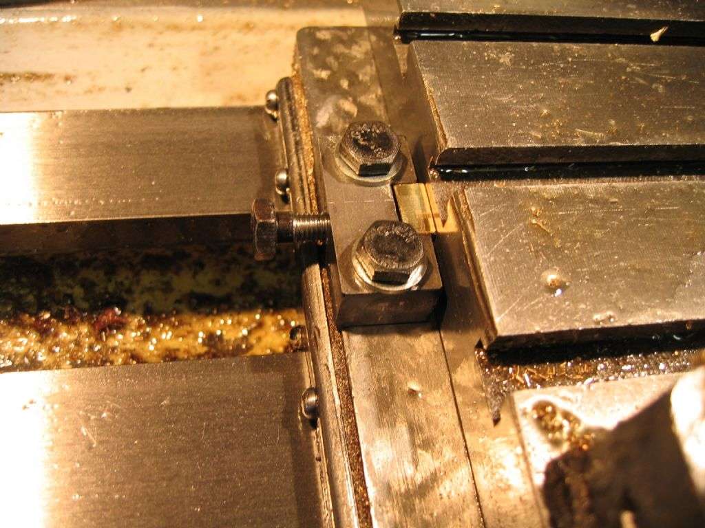

                    Just curious whats the second threaded hole for in the saddle which has the hex bolts with slots in for?

                      The bolts are there just to blank off the holes, the first is I believe for a travelling-steady… the 2nd was there when I purchased the lathe; but I plan to use it to fix a cross-slide clamp to…. Similar to the one in the photo ….IMG_4588

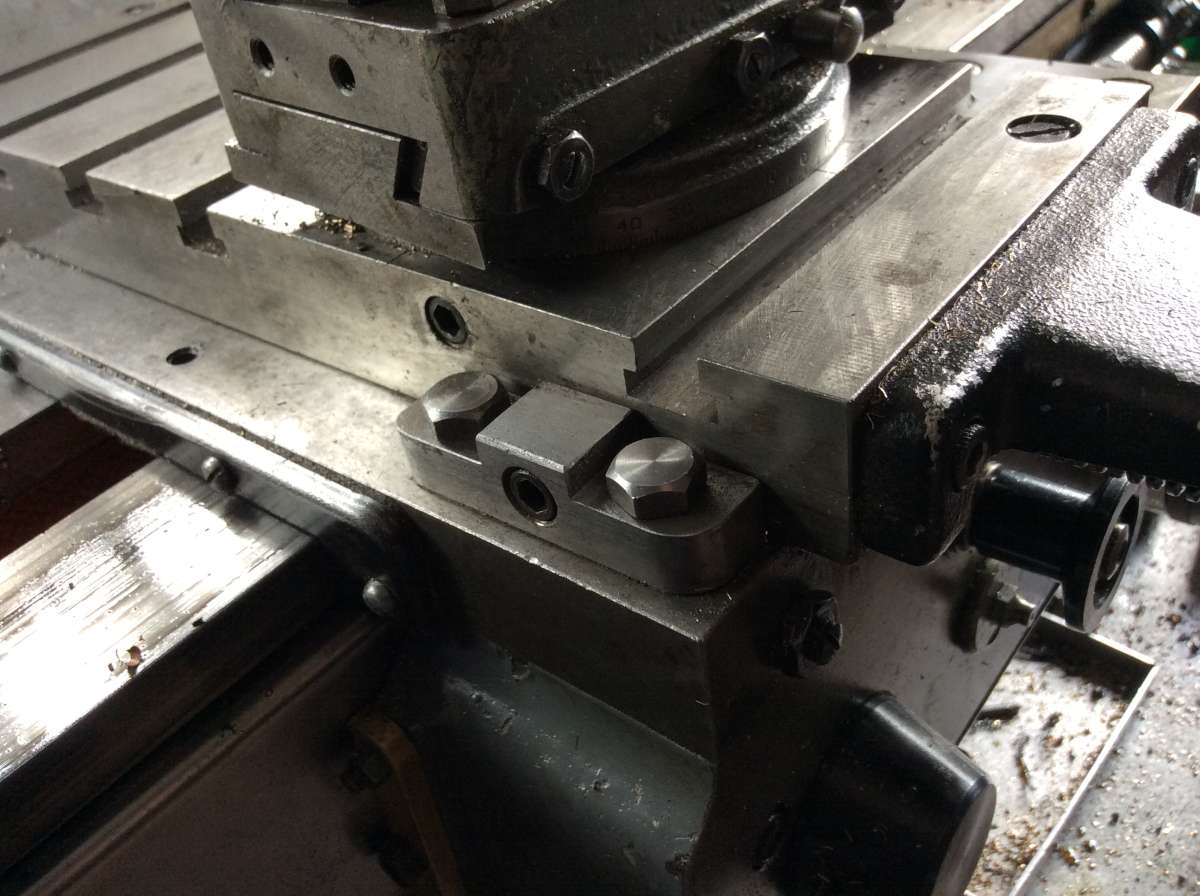

                        Ah right, the crosslide clamp is handy mine is fitted using the two front saddle bolts and the square headed compound screws changed for socket heads.IMG_3856

                          Many thanks for the photo, that’s a far more practical location 😎🇬🇧👍

                              Why do you need that clamp? There are two locking grubscrews provided on the other side that press against the gibs. They do the job perfectly well.

                                I’d be inclined to change the bolt in that clamp, for one much shorter so it does not project forwards of the wiper. There are times when using a four-jaw chuck or the faceplate when the saddle is close-to and any projecting bits are not a good idea.
                                Or better perhaps, take Charles’ advice!
                                The second hole is probably just another location for the travelling-steady, allowing a larger work radius. It could be a previous owner’s modification.

                                  The reason is that using the screws the other side tends to bend the gibs the one on the ther side does not. there are several ways to skin a cat!!!

                                    If I recall correctly, the small block for locking the cross slide was an idea that won a small cash prize from MEW a few years ago. I fitted it to my ML7R as I thought it would be useful to have, which indeed it is.

                                      I am not sure what ‘tends to bend’ means. The gib is merey sprung a bit, requiring little force and, way, way within any risk of bending. They are, after all, provided for the purpose by the manufacturer. But, sure, you do what you like!
                                      I will have a think about using grub screws for the top-slide swivel clamp anyway. It is often a mild annoyance getting the spanner to those square headed screws.

                                        Another plus to using the LH side is that it is solid and requires little force on the screw.
