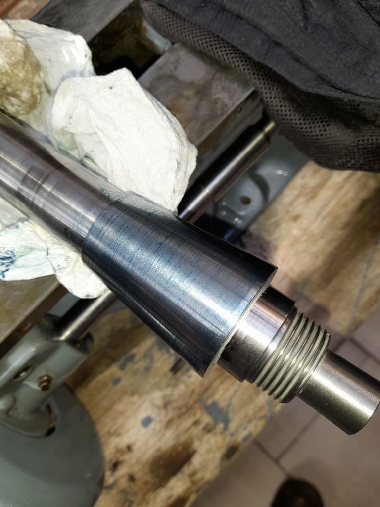

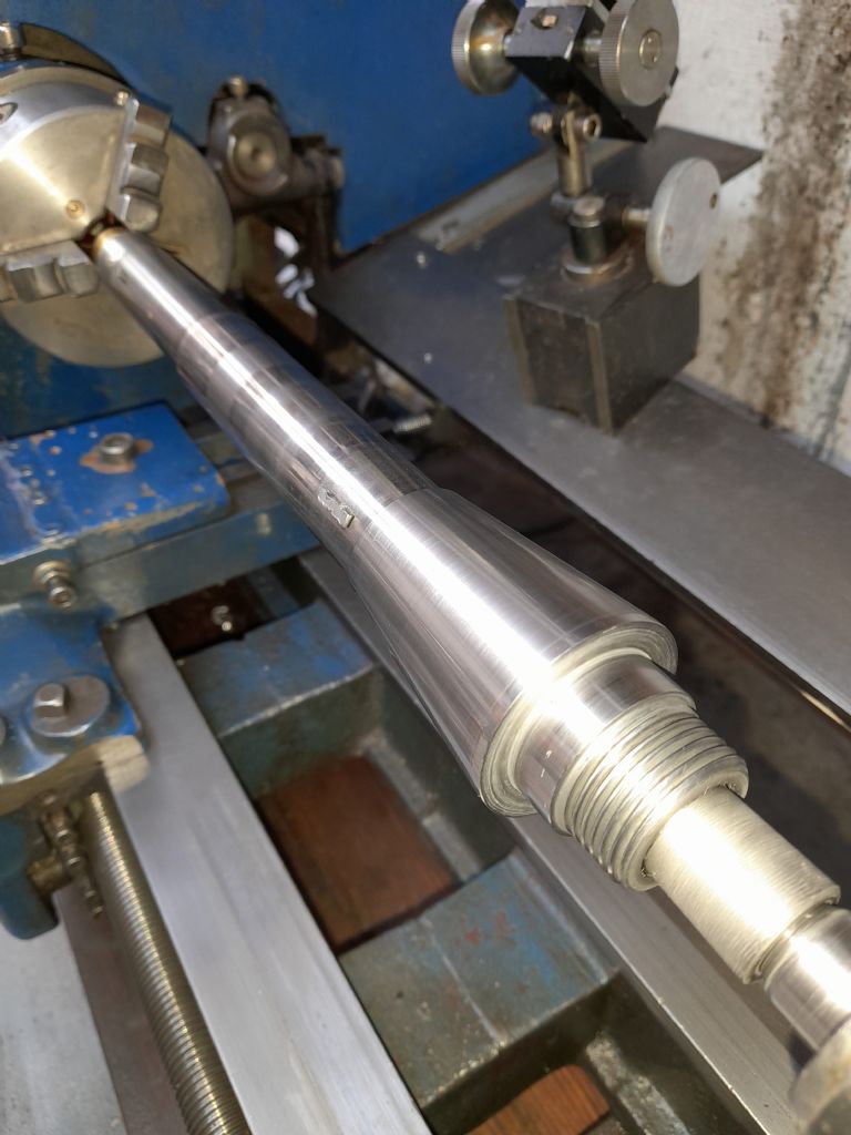

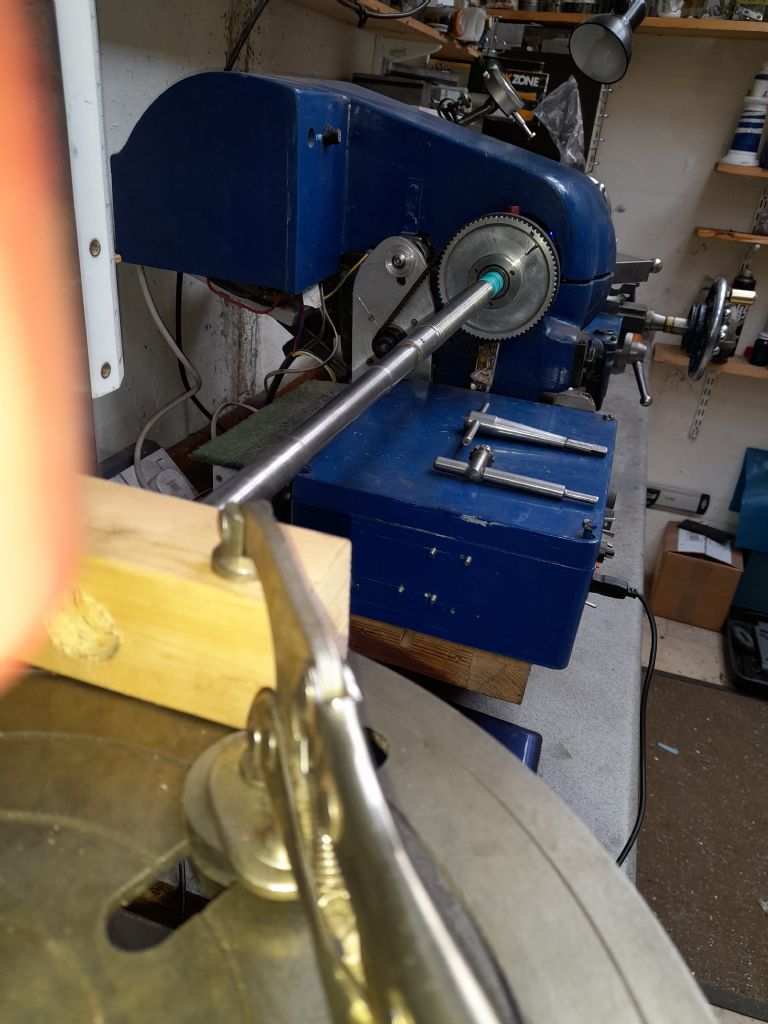

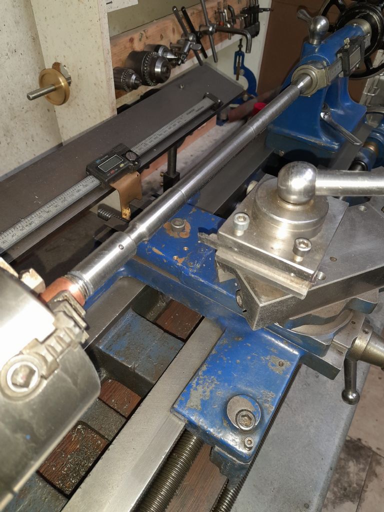

Headstock spindle.
The front bearing is cone shaped rotating in a bronze bush, on examination I noticed that there were defininte 'ripples' along the surface of the cone, not easily seen but could be felt with finger running along it, there was also a raised portion at the front end where the bronze bush ended its connection with the cone.
I tried to feel if there were the same ripples on the bronze bush but to my surprise it didn't appear to have any problems.

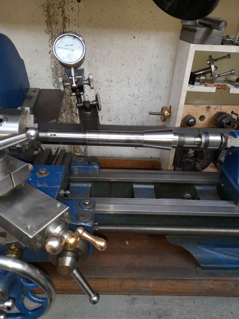

Putting the spindle in the lathe is quite easy, I fitted an M2 – M1 adaptor and the open end of the M1 used with a live tailstock centre.
I used a flat stone to take off the raised section and again on the cone area with the spindle rotating at a slow speed, the stone was moved against the bearing cone area to and fro and with a constant supply of lubricant in the form of white spirit.
The theory being that the form of the cone would be preserved so long as the stone was kept held in place by hand with equal pressure over the surface whilst sliding the stone, I had looked into the process of lapping and the question of embedded particles should not be a problem with hardened steel.
A good washing in hot soapy water then ensued, I also used an ultrasonic cleaner but I don't think it necessary.
The next stages of lapping required using emery on a flat steel bar going down in grit size, and the same processes repeated. Finished off with Brasso on a cloth and got a nice shiny finish.
Testing the bearing in the bronze bush with blue and turning 1/4 turn showed a complete surface connection. On running the lathe when completed everything appears to be running true and free.
I will at some time be having a look at the bearing again to make sure everything is ok.
Some pics below.
