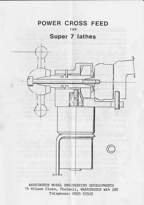

      I am thinking of adding power cross feed to my Super 7B.
      Does anyone have any experience of the device that was made by WMED? Is it any good?
      Does anyone know of any other commercial products that were, or are available, that they recommend?
      Does anyone know of any articles that have been published for a DIY system that they can recommend?
      I do not really need CNC control, but if a product/design has this and allows a speed controllable power crossfeed, then that is no problem.

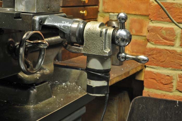

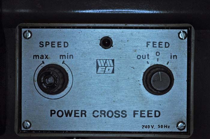

          I've got one:
          I've had it for 25 years or so. Brilliant bit of kit – I wouldn't be without it. The drive appears to be via a pair of bevel gears but I assume that there is also a gearbox on the end of the motor. The control box governs speed and direction so I assume the motor is a 12 V (?) dc unit. I noticed that Maplin have some low voltage motors with built in gearboxes – might provide the basis for a home brewed version.
          HTH
          Rod

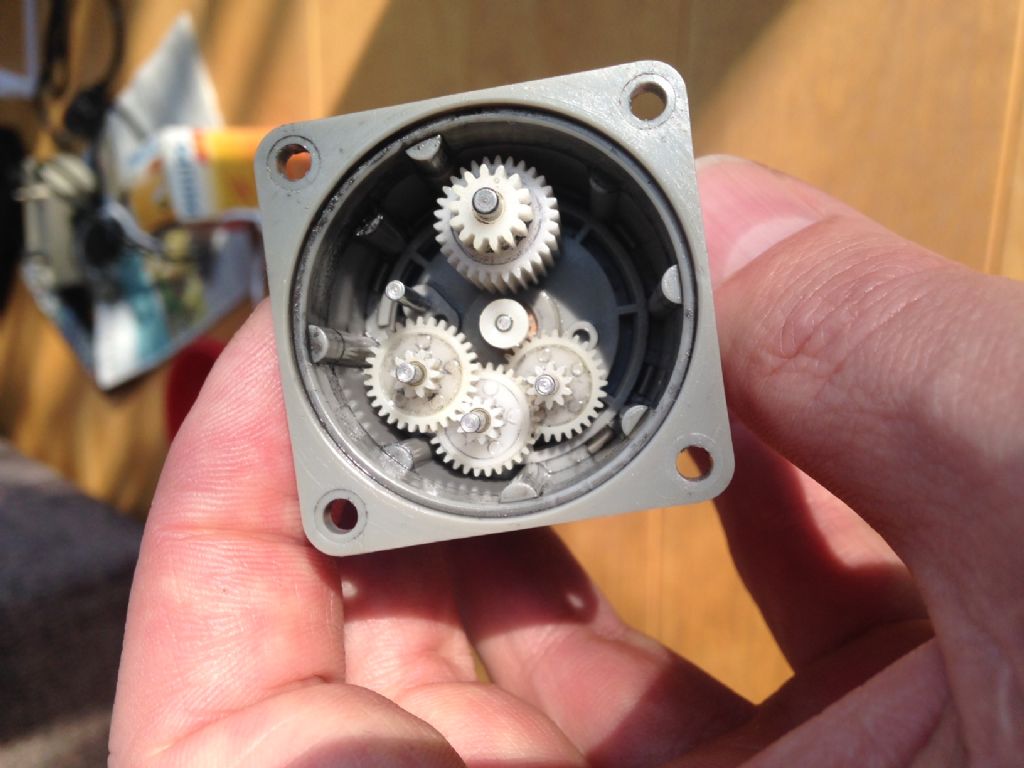

              Hi All,
              I actually bought this unit off ebay, which Ziggar is referring to. But it has got an issue. When there is a little bit force on the crew that turns, the gear slips. When I took it apart it appeared that the conical gear on the top is a bit worn out (it is from nylon I think). Does anybody know if there is a spare part out there for this power cross feed?
              Thanks for your help!
              Kind regards, Joost

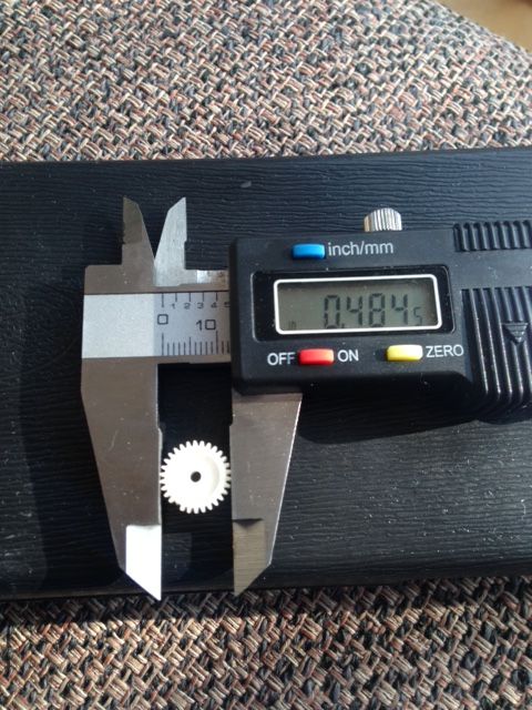

                                Hi All,
                                I tried the solution from john kennedy 1, but it appeared that the problem of the power cross feed was much more down in the device. See the picture…
                                The gear that is missing in the picture has one broken tooth. See below:
                                The diameter is 12.31mm or in inches:
                                The gear has 30 teeth, and the hole in the middle is 2mm. I tried to find one but without succes sofar. I contacted HPC gears today, so will see if they have one.
                                KR, Joost

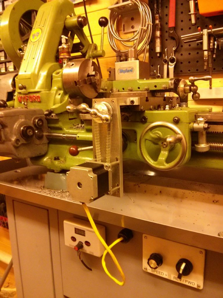

                                            Homebrew ML7 power feed for less than 50 squid
