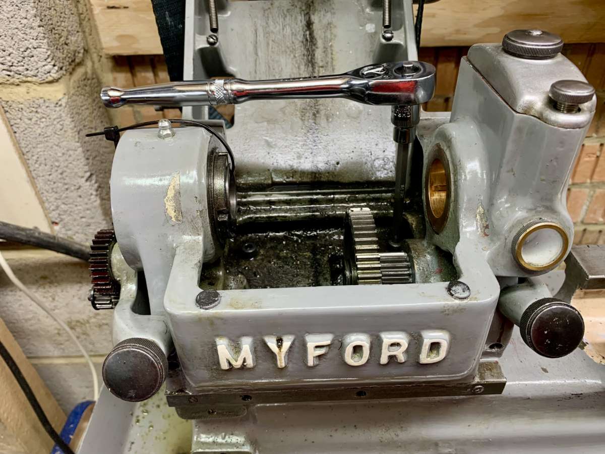

      I am still very much a beginner and have had my Super-7 since May last year…. I have learnt enough to understand that now is the time to get the bed, saddle & cross-slide re-ground…

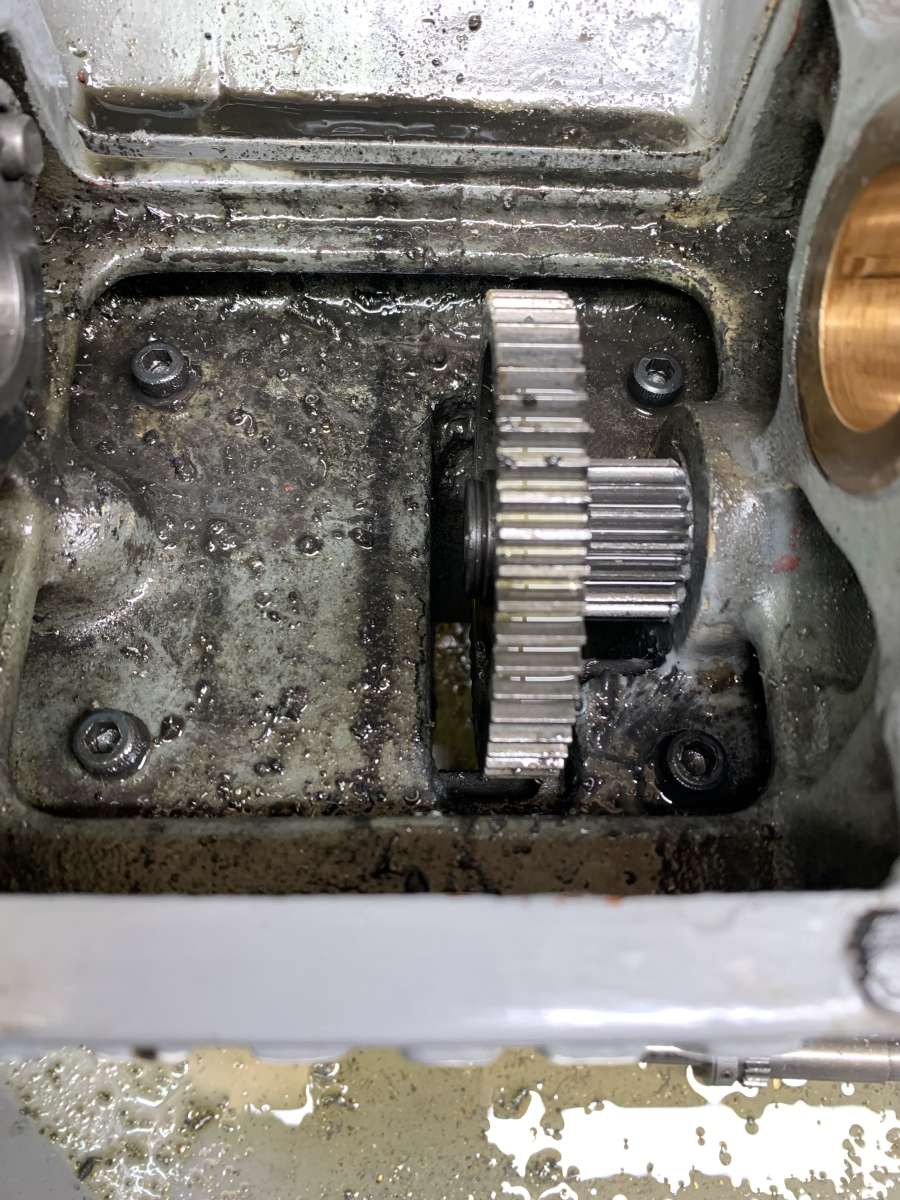

      I have disassembled virtually everything, and am down to the last 4 bolts/cap-scews that hold the headstock to the bed.
      So far I have got away with a selection of metric & AF tools, but these last 4 definitely need the right tool for the job.
      Can anyone tell me what size Allen-socket I need to undo these please??
      Many thanks.. 🙏

                  A quick look on Myford’s site tells me they are 5/16BSF fixings. A google for that size screw spec says they are 7/32″ nominal hex so that is what you need. Sanity check 7/32″ is 0.218″ so close to the one you have

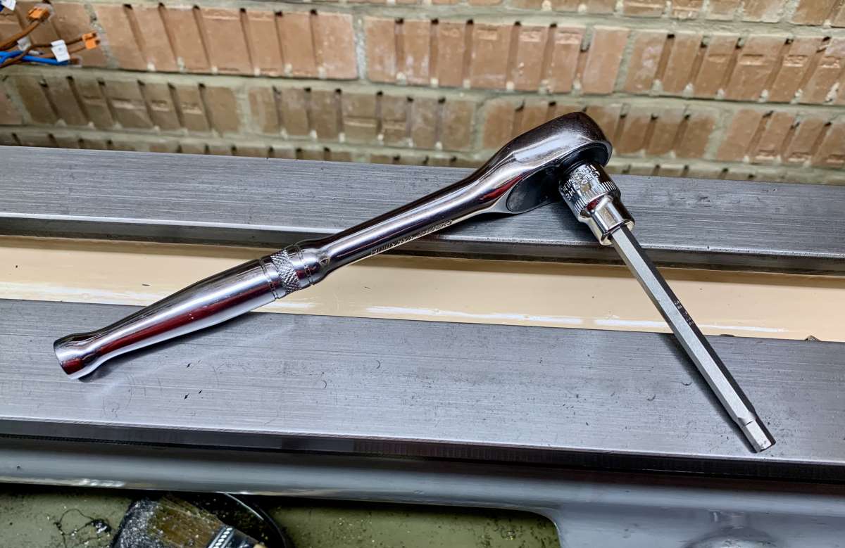

                        I’d go with a 1/4 or 3/8 drive with 7/32″ hex, a ratchet or tee bar will give more leverage than a tee or L shaped key and extensions will give you the reach needed.

                                  Provided you use the right imperial hex bit, not an almost-there metric one, I’m with Jason on this: use a 1/4” or 3/8” breaker bar, sliding T or ratchet with extension if necessary. For tight spaces, wobble extensions are a good alternative to standard ones.
                                  You’ll just need an imperial hex bit set (surely indispensable if you have a British lathe) and the relevant 1/4” or 3/8” square to 1/4” hex adapter.

                                    A set of long-reach hex-sockets purchased today, the 7/32” fitted perfectly & the headstock was removed within a few minutes.
                                    many thanks for the advice 😎🇬🇧👍
