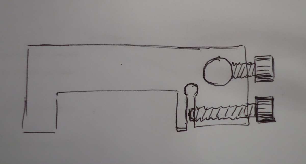

      I have made a saddle stop for the museum’s Atlas 12 x 24 which is not easy to use. It locks and is fully adjustable, but I think that the designs used on Myford lathes which have the same type of bed as the Atlas would be an improvement. Hopefully, some kind members could show me their designs for inspiraion.
      #710056
      Diogenes
        @diogenes
        ..to clamp across a shear?.. ..I made one similar to Harold Hall’s –
        http://www.homews.co.uk/page152.html
        – but instead of using a separate ‘jaw plate’ and pin, simply drilled a hole & made a cut to leave a little ‘tongue’ to stop the point of the locking screw chewing the side of the shear.
        Obviously you can adapt the ‘body’ design to hold a simple stop, clock, or turret. I use a plain rod with a collar on it so that I can use a gauge piece between that and the body to set depths etc..

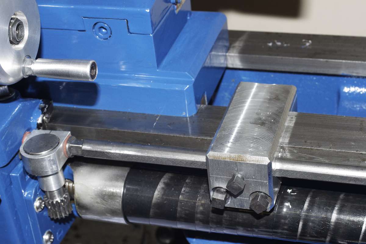

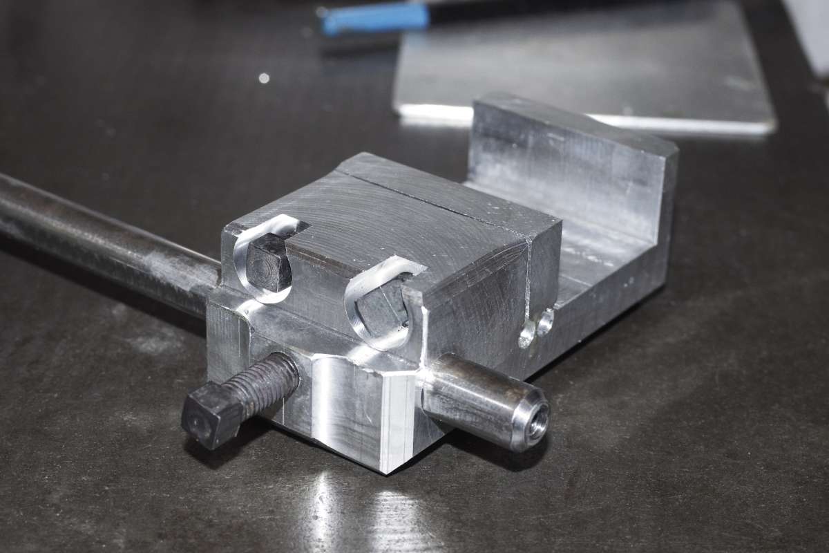

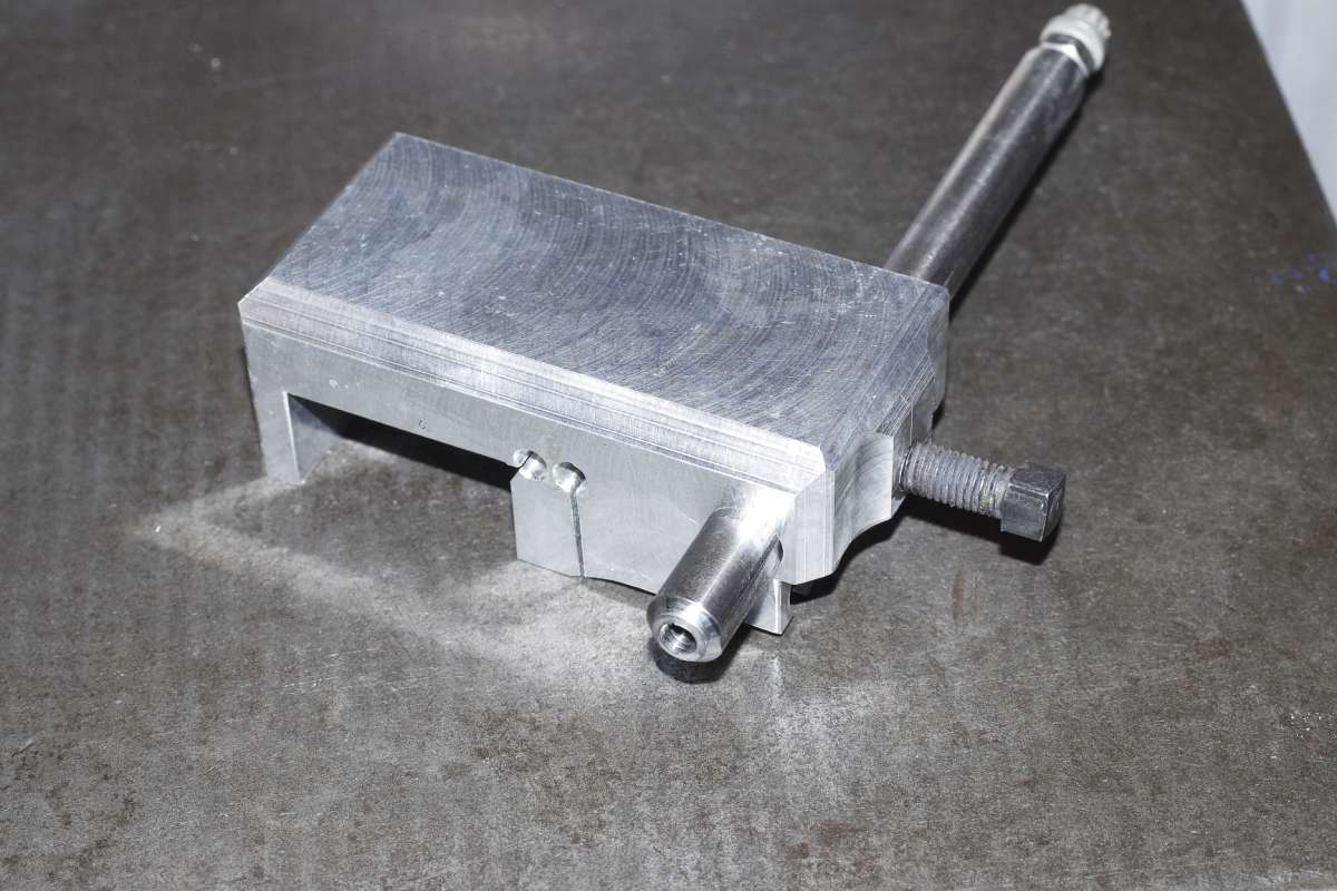

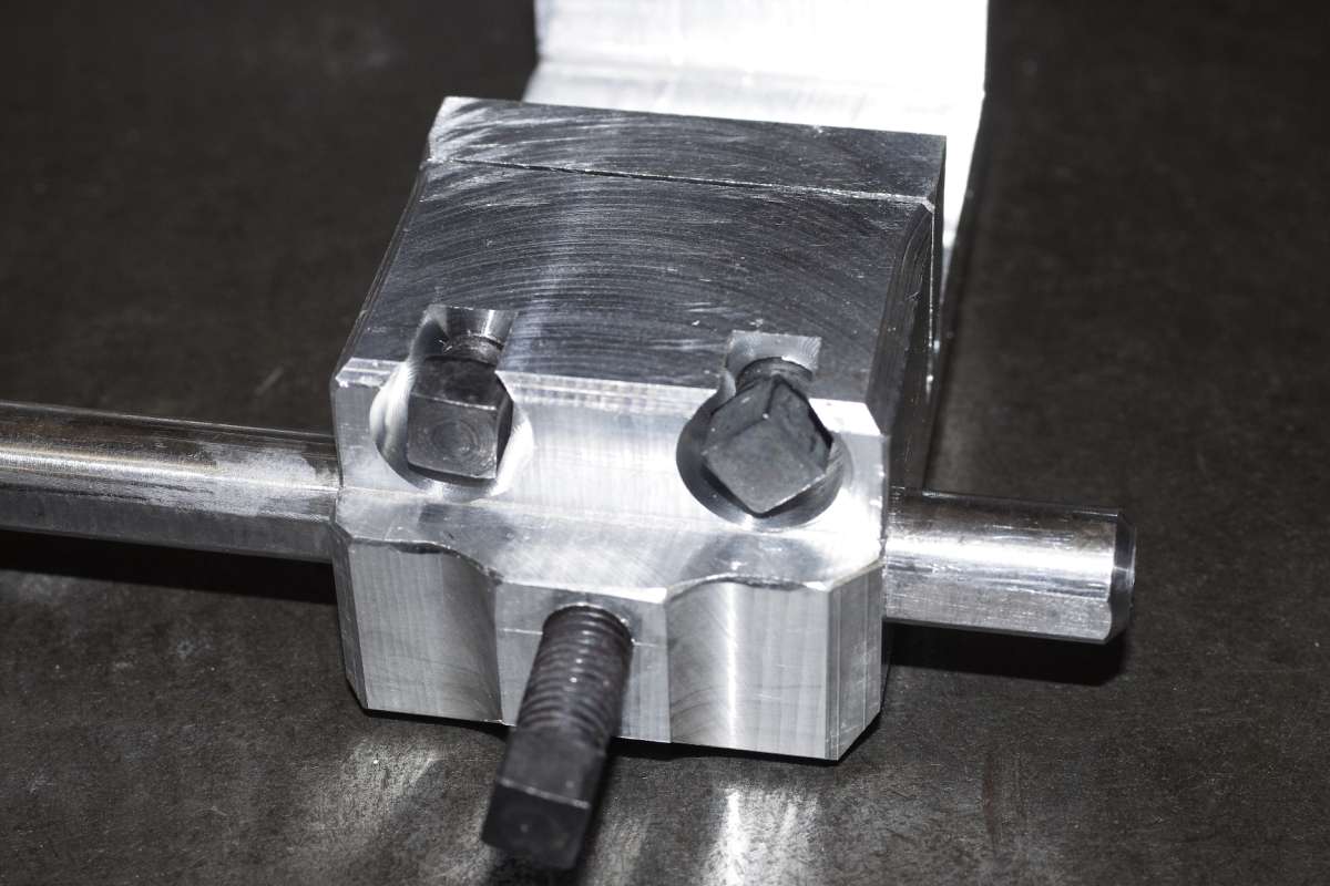

                      I have almost finished the saddle (carriage) stop for the Atlas. Here are some pictures, the centre screw will need shortening. It locks to the bed very well, and id so much easier to set up than my wedge design.

                        That’s neat! I like the recessed screws. Do they share a key with a QCTP with square-headed tool-clamping screws?
                        #711365
                        old mart
                          @oldmart
                          The screws were spares left over from dumping the SHCS swarf trapping screws in a four way toolpost. They weren’t long enough without an added pin, so as there was enough metal to mill back and put a 9/16″ slot drill in to clear the 1/4 drive double square socket , I did that. The Atlas and the Smart & Brown both use 5/16 square screws on toolposts, stops, compounds, saddle (carriage) locks and the Atlas thread dial. One tool fits lots of things, makes life simpler.
                          The adjustable rod just clears the Norton gearbox on the Atlas, so I could fit a longer one if needed. The stop could move about 3/4″ further to the left on the bed if a chamfer was taken out of the left hand rear of the stop.

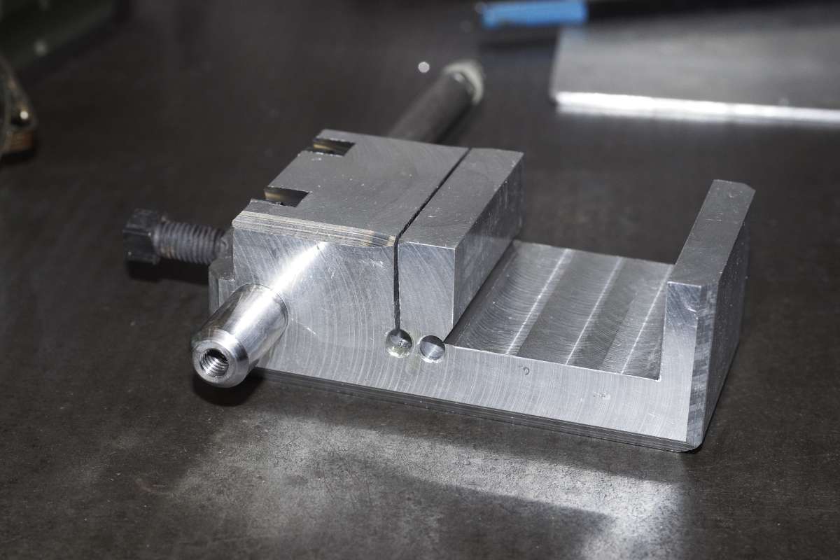

                              old mart
                                @oldmart
                                I have just finished the stop for the right hand side, it is similar to the first one, both made from a bit of odd aluminium offcut. The picture shows it outboard of the tailstock, probably the commonest position.
