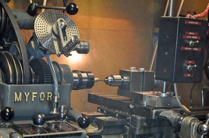

                                    Even though I have a milling machine it is sometimes much easier to use the lathe and vertical slide. Drilling a pair of holes in this nascent flange is much easier and quicker for me than setting up the rotary table to hold the chuck in the mill.
                                    Milling a helical gear is only possible in the lathe since I need the lead from the change gears to rotate the gear blank under the cutter and have the milling spindle held at the helix angle.
                                    These facilities are not unique to the Myford but the availabilty of 2 types of vertical slide, the long cross slide and the ability to easily adapt the gearbox to cut a 5" lead all add to the desirability if your tastes run to these sort of envelope pushing exercises. The fact that the likes of Radford and Thomas designed things like the Headstock Dividing Attachment explicitly for the Super 7 because of its easily accessible bull wheel just add to the charm in my opinion.
                                    smiley
                                    Rod

                                      Hi Rod,
                                      Slightly off topic, but thanks to your photos I now realise what the threaded hole in the casting next to the headstock oiler is for. I must make a Thomas Dividing Attachment to go with the Potts Milling Attachment which came with the Super 7. My next project is some form of clock with remontoire compensation.
