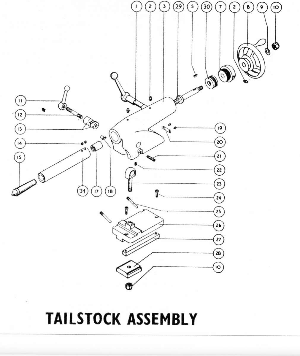

      I find myself needing to adjust the tailstock on my Myford super 7, I have never tried to adjusted up to now and cannot seem to find any instructions. I have seen the to adjusting screws at the front end and the one on the righthand side at the rear but I thought I would ask for advice/instructions before I had a play and messed something up so if anyone can help I would appreciate it.

              There are two slotted grub screws, front and back, just below the bed locking lever. To adjust the tail stock slack them both off and just nip up the tailstock to the bed. Then tightening the front screw moves the tailstock toward the front, tightening the rear one moves it toward the back. To move it one way or the other the opposite screw must be slacked off. Once set where you want it, tighten both. Note, they are very stiff to move, at least on my lathe.

                  To add to my last, the reason I say to “just nip up the tailstock to the bed” is to just stop it from moving while making the adjustments. If you lock it solidly to the bed it is then extremely difficult if not impossible to adjust the tailstock with the grub screws. This is because as can be seen in the diagram below the action of locking the tailstock to the bed not only does that but in the process applies the locking force between the two halves of the tailstock  body.
                  JohnTailstock
