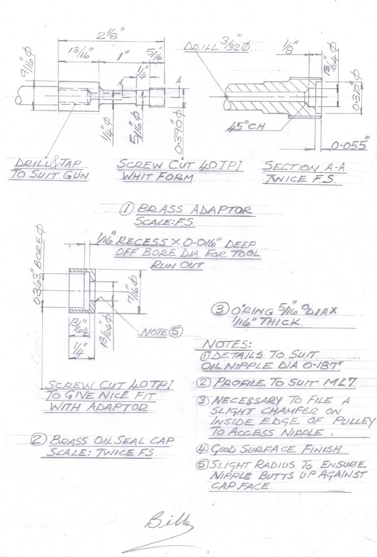

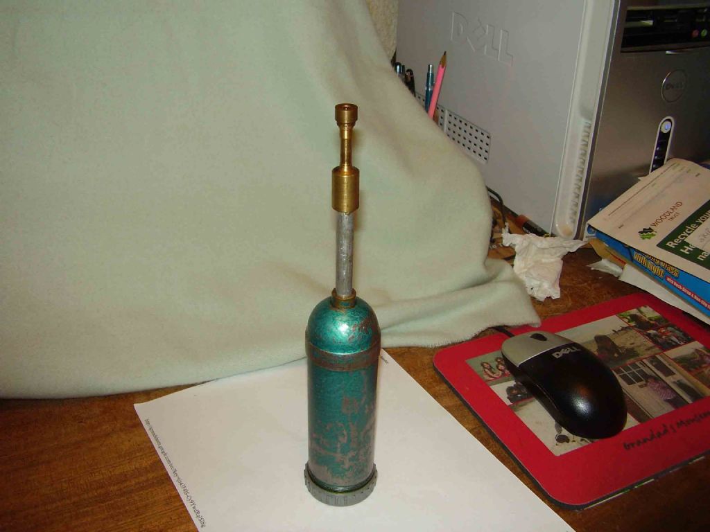

                              #79416
                              William(Bill) Poole
                                @williambillpoole97014
                                Hi,
                                I converted an old telcalemit grease gun some eight years by making a brass adaptor
                                housing a very small O’ring to give a snug fit over the oil nipples on my ML7, no problems with oil leaks and cost effective.
                                Bill.

                                        #79527
                                        William(Bill) Poole
                                          Hi Doug,
                                          Ive just come in from eating an Indian so I have only just picked up your post.
                                          Conversion was fairly straight forward, I have only made the brass adaptor to fit on
                                          the grease gun as I have not had any problems from the filling side.The adaptor
                                          was profiled to access the reduction gear and pulley .( I can just hear my wife moaning
                                          about the time//). Doug, I can send you details if required together with an image tomorrow . Must go.
                                          Bill.

                                                #79613
                                                William(Bill) Poole
                                                  To Doug Johnston,
                                                  Hi, Bill here.
                                                  Iv’e just sent you a reply to your query but I think its failed so here goes. I have a 2 inch
                                                  filler cap on the bottom of my gun for filling purposes, there is a small vent hole in the upper part of the cylinder for venting the air when operating the gun , if oil is coming out of the vent hole then I would anticipate that the main oil seal has failed,this is easily replaceable. I’m not sure I understand your problem exactly but I hope this is of help to you.
                                                  Bill.

                                                    #79868
                                                    Redpiperbob
                                                      @redpiperbob16487
                                                      Hi All
                                                      Bill was having a problem loading the drawing for the adapter so I said I would load it for him so her it is.
                                                      And the gun he fitted it to.
                                                      Bob
