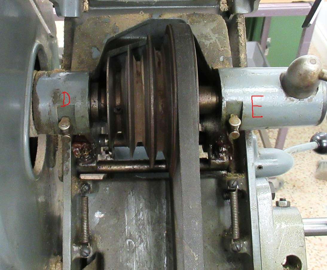

      some advice please on the lubrication of the main bearings on this Myford Super 7
      two images below.
      with B D & E,  i take it you drip a thin oil (hydraulic 32) until it creates a resivoir, then repleish when it disappears ?
      With ‘A’  is this oil or grease, and if it is oil, is there an oiling gun?
      And is  ‘C’ just a normal greased roller bearing that is maintenance free?
      And with ‘B’  what is this lubricating, the back gear spindle ?
      xMyford_5908xMyford_5907

        All of those points are the same oil, I use 20 weight hydraulic oil; none are grease nipples
        Yes you need an oil gun for the oil nipples, and to prevent leaks, it helps to pump through a single layer of paper towel.
        The front bearing C id lubed via a wick from B
        Backgear spindle lube you’ve not shown, there is a separate oil nipple in the middle of the engagement lever’s pivot, just below the spindle nose, and perhaps obscured by the chuck.
        The 4 step V pulley also has an oil nipple, don’t forget that one either.
        It should all be covered in the manual, which is available from Myford, or readily viewable on line.
        If you have Facebook, join the Myford Lathes group. where you will find a wealth of information in the files section.

            Oil never leaves ‘B’  does the wick fail, can it be removed / replaced

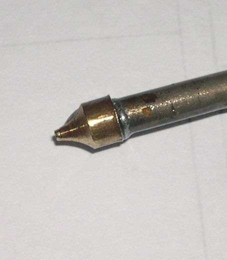

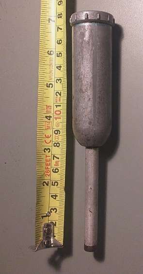

            What type of oil gun do I need.   are the oil nipples 2BA ?   are these oil guns really £40

              I use one of these, which works fine, and one of these

              You can remove and replace the wick by removing the main spindle, but you really do need to read the manual.
              It shouldn’t consume too much oil; you should see a feint ring around where the spindle goes through the bush behind the chuck.

                      The Myford oil gun ensures that nothing rusts, but puts very little oil where wanted, in my experience.
                      Buying a Reilang improved matters, (Both lubrication and oil useage)

                            If the oil level at B never goes down then you have a problem. If you top the cup up to the brim you should see the level drop at least a little. It may well not use much, but it must use some. If not, then the bronze bush front bearing is going to suffer.
                            Making sure the oil cup and passage are not blocked would be good first step, because replacing the felt wick is a spindle-out job.
                            You also have to remove the back-gear lever. Behind it is a socket grub screw plugging a hole. On re-assembly you have to poke a sewing needle up that hole to hold down the spring loaded wick so that you can put the spindle back in without trapping the wick.

                              Like most people I gave up on the Myford oil gun almost immediately and modified a normal pump oil gun by soldering a brass adapter on to the end of the spout as in the pictures below.  The end is contoured down to a diameter that just fits into the oil nipple and is drilled #60, then a small slot is filed in the end. In use the end is pressed into the oil nipple, sealing on the conical end, pushing the ball down and when the oil gun is pumped the oil flows in through the small filed slot. No mess.

                                But first things first, how do I establish if the wick is working ?
                                I have filled the cup up to brim full with a 32 hydraulic oil,  and after two days it is still brim full.  I have run the lathe for a few minutes and the level does not change.
                                Don’t want to run the lathe for half an hour to see if that alters the level, and bugger the bearing because the wick is not working.

                                  You won’t see the cup level drop visibly in such a short time. When I check mine, the cup initially appears full, but adding several drops from an oil can the level doesn’t change much, then the level raises sightly to be just proud of the top of the cup. Close the cover & that will be fine for another several hours running. This isn’t a pumped or recirculating system – the wick just keeps the bearing “wet”.
                                  The only way to check the wick is to remove the spindle. To check the oiling, check under the headstock area / top of the raising block – this is a “total loss” system & on my “Beeston OIl Leak” the lost oil works its way out to accumulate here.

                                        Yes – hence my reference to my “Beeston Oil Leak” ! In my epxerience, Myford S7s are oily machines –  maybe I go overboard, but I don’t get through huge quantities of oil. All the oil you apply to this machine will eventually end up in the coolant / swarf tray.
                                        So I should see some emerge from the bearing ?
                                        Not necessarily. If you could see some oil coming out whilst running, it will probably be inside the headstock at the rear of the bearing – from memory oil moves through a tapered bearing from the large end to the small end. Bear in mind that the felt wick is smaller than you might expect. I knew I had a new spare wick somewhere & found it whilst in the garage just now. It is only around 1/4″ diameter at the end that contacts the spindle (around 3/16″ diameter in the section that sits inside the contact spring) & the oil flows by a wicking action through the dense felt. You will not (and should not) see large quantities of oil emerging from anywhere after the short runs you are doing. This is what the wick looks like as a spare part
                                        not sure exactly where you meant by “headstock area / top of the raising block”
                                        The area underneath the bed beneath the headstock casting, where the bed casting sits on the raising block that sits on the coolant / swarf tray – where you would reasonably expect that oil would drip out from the vicinity of the front spindle bearing.The headstock casting is open where it bolts to the bed & the bed is also hollow / open, so any oil that esacpes within the headstock area works its way out there.
