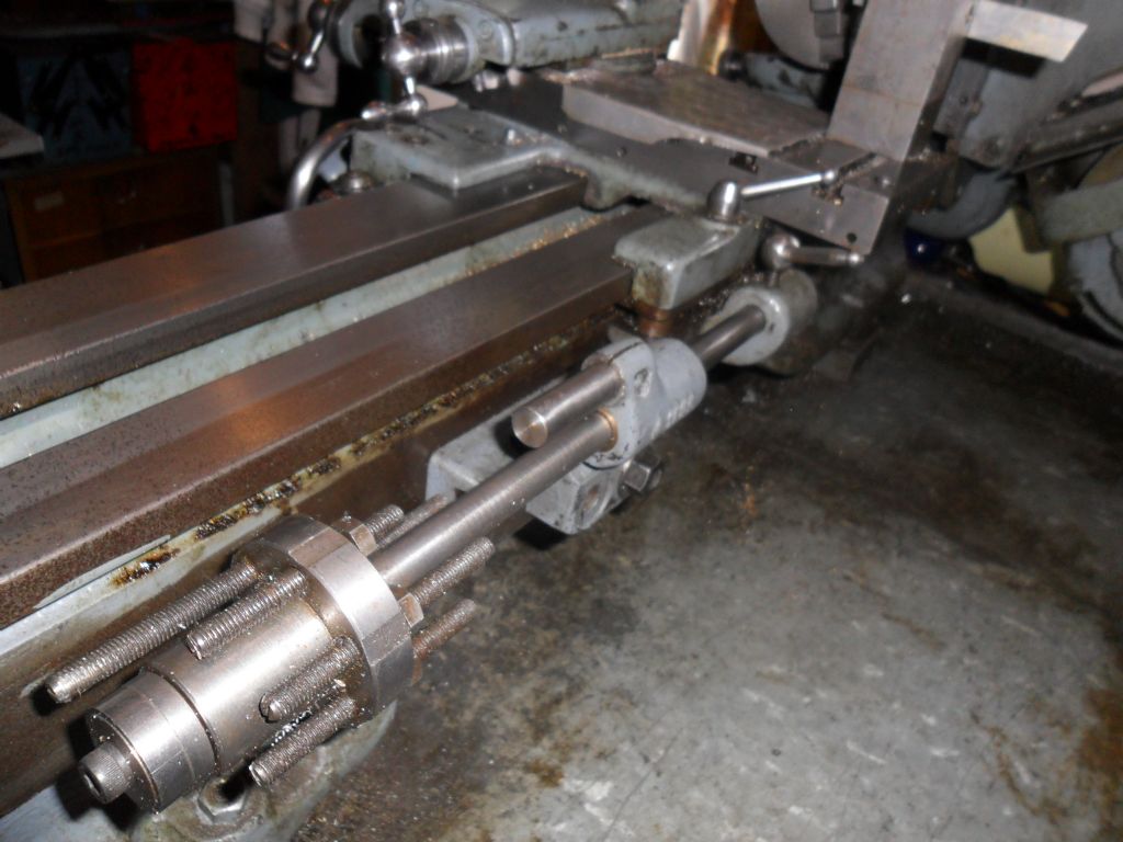

          Here is a photo the part you are missing you can just see it in this photo . I can post details measurement later. Regards Nobby
          6  position  stop

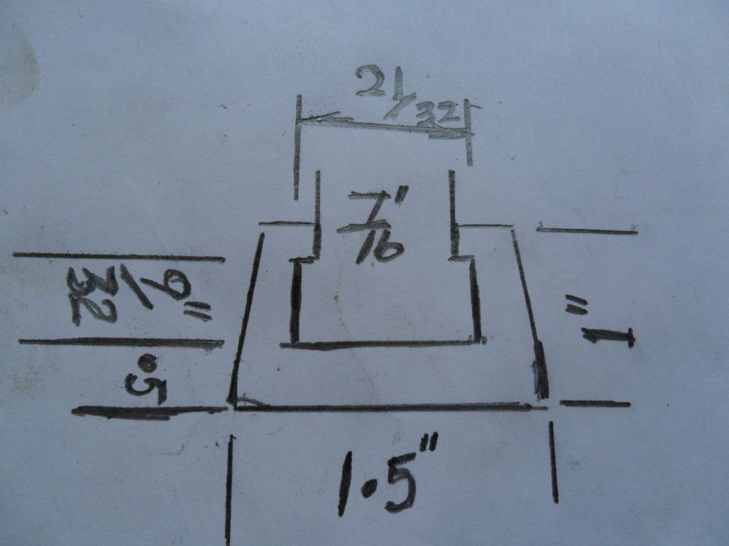

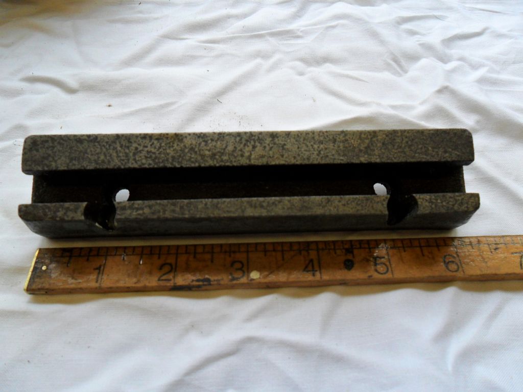

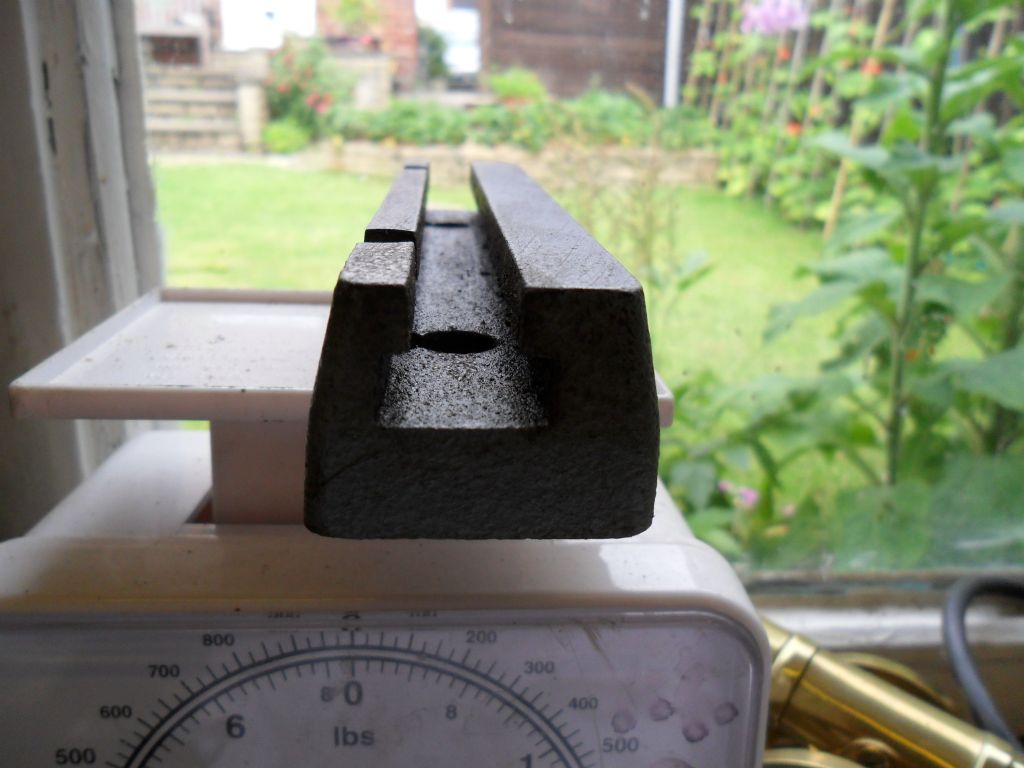

            sam_3034.jpgsam_3037.jpghere we go Matthew Overall Length 6&5/16" hole ctrs. 3&15/16" hole to suit 1/4" whit Mtrl. Cast ironsam_3036.jpg

              Another photo showing parts can be seen "here"

                Thanks guys, that's brilliant Nobby, I really appreciate you doing that, I even know what it weighs to!
                Once I have sorted a bit more of his stuff I will get on with making one, I didn't realise the T slot was not in the centre, but from this I will have no problem.
                Thanks again Nobby
                Matthew

                    Nobby
                    your skills cant be that bad I managed to work it out, and thanks I hope its not to much trouble putting it all back together
