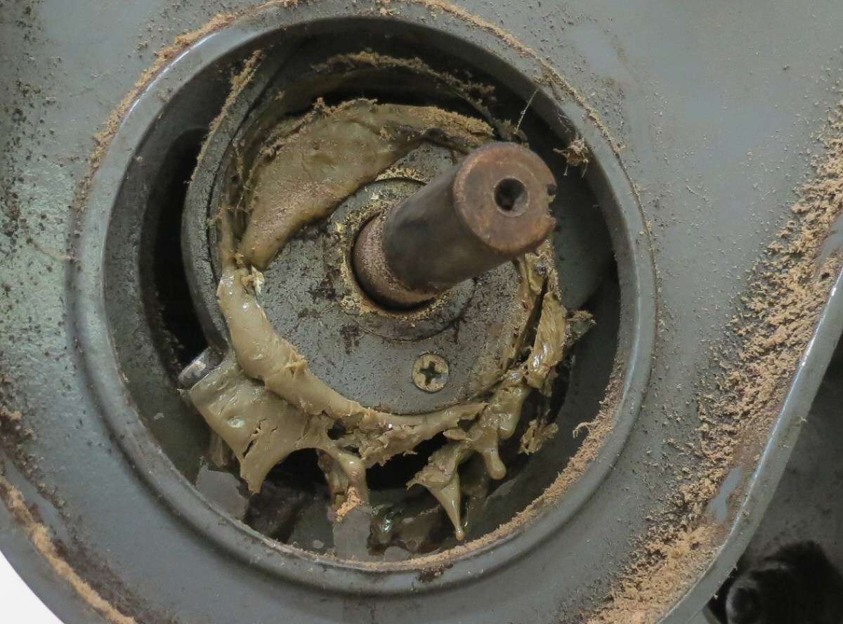

    Justin Thyme
      @justinthyme24678

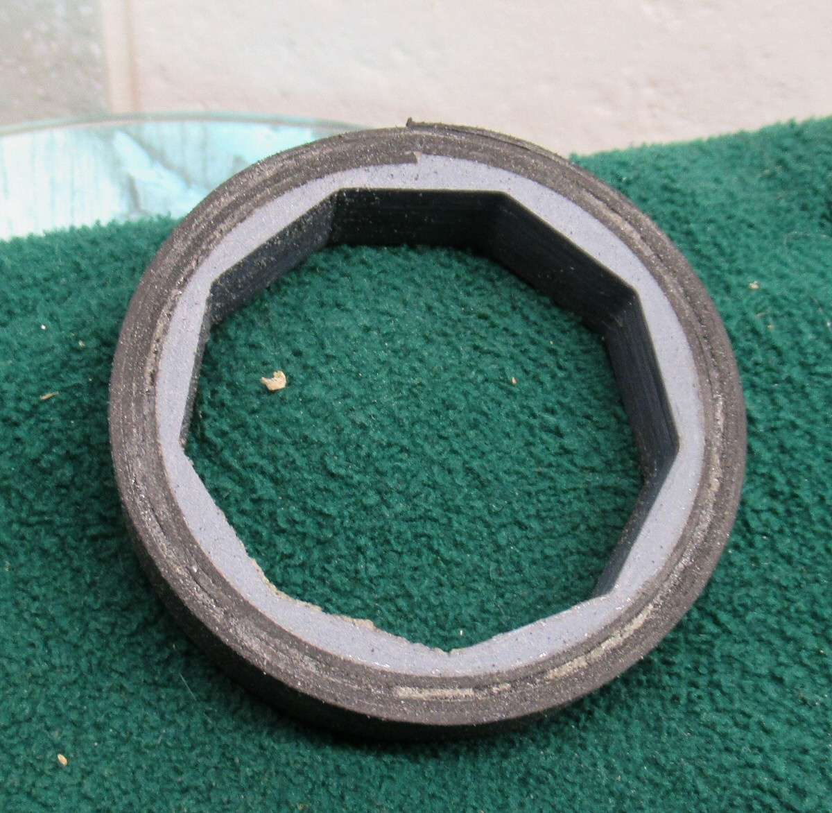

      Myford Super 7
      Only got a brief look at this tonight, the motor still works fine (a little wobbily)  but as you can see something is coming adrift and looks like it has been bodged up at sometime in the past.
      I will be dismantling it sometime next week, but in the meantime, anyone know of this problem and what is needed to fix it

      #705380
      Harry Wilkes
        @harrywilkes58467
        Would think bearing ‘shot’ and the gunk is congealed grease, if thr shaft is not damaged you should get away with a bearing change if the motor is ‘shot’ then maybe think about fitting a VFD I did and been happy with result

        #705384
        Diogenes
          @diogenes
          Is that muck epoxy / Araldite?
          It’s a bit difficult to see, but it looks as if the rubber isolation bush has perished & collapsed.
          If that’s the case I think (unless anyone knows otherwise) you’ll be lucky to get one off the shelf.
          Someone might have a spare, or it might be possible to fabricate something ‘that will do’ to get it up and running again..
          It’ll be easier to see once it’s out and cleaned up..

            #705397
            Justin Thyme
              @justinthyme24678
              Motor is in good condition, runs smoothly and quiet. In fact, as unlikely as it looks you could use this now, it is not obvious using the machine,  the belt seems to support the weight of the motor.
              The gunk seems to be a mix of epoxy, araldaite,  silicone and god knows what else.  I would guess this has been bodged up many times over many years,
              I think the comment of “rubber isolation bush has perished & collapsed” is very likely the case.
              I will be taken it to bits sometime next week, and trying to establish what is what.  I had hoped someone might of said, ‘yes common problem, you can get the spare here for 1.99″

              Clive Brown 1
                @clivebrown1
                I agree that the problem seems to be collapse of the rubber support bush for the bearing. If the motor is run in that condition there’s a chance of contact between rotor and stator.
                Years ago,I had a Myford single-phase motor with a similar problem. A rubber bush, moulded from Devcon Flexane, provided a satisfactory solution, but it’s not cheap to buy for a small job.
                #705413

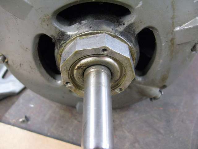

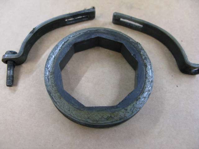

                Dave Wootton
                  @davewootton
                  Looks like the rubber bush for the motor resillient mounting has given up the ghost and been mercilessly bodged.This supports the whole motor by the outside of the bearing housings at each end, and provides some isolation from vibration, I’ve repaired ( bodged?) one of these on an ML7, whose original mountings had perished, with the same motor arrangement using a thin slice cut from the end of a car heater hose. I was fortunate to find one of almost the correct size at an old fashioned motor factors, had to buy a curved one as the wall thickness was greater then the straight lengths. A little tricky to adjust so that there is some isolation from vibration whilst restraining the motor itself from rotating in its mounting on start up. Lathe belongs to a friend who uses it quite often and the repair is still going after at least ten years. Couldn’t find a genuine replacement Crompton part at the time, so doubtful if they would be easily available now.
                  Good luck
                  Just remembered that in this motor the outside of the bearing housings at each end were hexagonal, I used a black car sealer called Sikaflex applied it to the hexagon and pushed the heater hose on, leaving it to cure before putting the motor back on its frame and tightening the clamps. Would think any filler or sealer would do just to fill the gaps, this was just what was handy at the time.

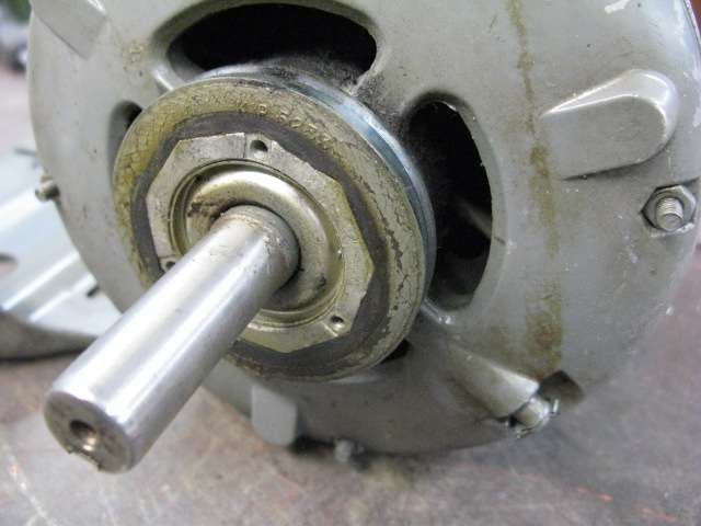

                  Dave Wootton
                    @davewootton
                    IMG_0517IMG_0519IMG_0520
                    I took another look at your picture and realised the motot mounting you have is slightly different to the one I repaired, that one did not have the steel ring around the rubber. But remembered I had a motor very similar to yours awaiting installation, so have taken a couple of pictures of the motor mount dismantled so you can see what it should be like.
                    Wouldn’t be so easy to repair using the method I outlined above, don’t think you would find a heater hose with a sufficient wall thickness to do away with the steel ring. As it’s a 3 phase motor and should run smoothly anyway,maybe you could do away with the resillient mounting and arrange something solid to replace the rubber, JB weld done a bit more neatly?. Depends on if you have access to another lathe to make the bits.

                                    #705553
                                    Justin Thyme
                                      @justinthyme24678
                                      On Pete Rimmer Said:
                                      You could 3d print that rubber damper ring in TPU very easily.
                                      Interesting – never heard of TPU but I have access to a 3d printer. how does it stand up to heat ? motors can get hot, wouldn’t trust PLA
                                      On John Haine Said:
                                      The old single phase Brook motor on my S7 vibrated horribly but the new one, 3 phase TEC motor from NT, though it has such a mount runs sweetly without any vibration at all.
                                      Yes, this 3 phase motor is beautifully smooth, I could imagine it being OK with a solid mount

                                        #705606
                                        noel shelley
                                          @noelshelley55608
                                          Cant Help with sikaflex data but try CT1 for data. Good luck. Noel.
                                          #708083

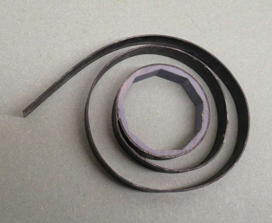

                                          Justin Thyme
                                            @justinthyme24678
                                            Come up with a repair and it seems to have worked well.  I 3d printed a bit to fit round the 9 sided polygon, then I used 1mm pond rubber to achieve the correct diameter.
                                            I used pet-g filant for the 3d print, that stays fairly hard to at least 100°c   and wont melt till over 200.   and even if it gets a bit soft it is enclosed on all sides.
                                            The rubber bit seems to be OK, with the motor tightened up I can still get mayb half a degree of flex. and on running it, it sounds right.
