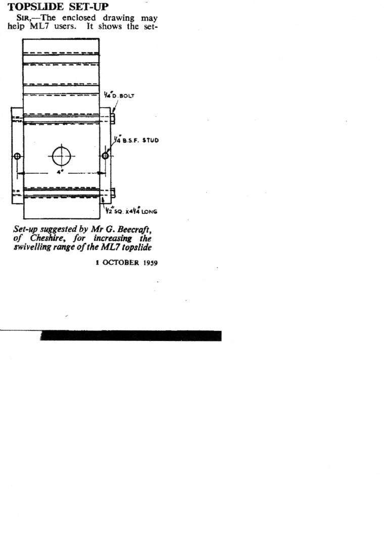

                There is a block that bolts to the back end of the cross slide. That has a slot in it that secures it to the TT lower part and allows coarse adjustment of cross slide position.
                Could you make something that fits into or on top of that slot that would allow fine adjustment? It could look a little like a micrometer adjustable bed stop.
                It would be a little difficult to use as you have to reach over the toolpost to adjust, but it would eliminate the longitudinal movement caused by an angled top slide.
                With the GHT geared and retracting top slide, that moves the top slide handle upwards. Maybe something similar could be done so the top slide could be set parallel to the cross slide.
                If it is mainly the dial of the standard cross slide that prevents it being set parallel, make a smaller dial and squint a bit on the odd occasion you use the TT. A Kipp-style ratcheting handle could then be used.

                  1) Two columns fitted to the cross-slide to correspond with the compound-slide slots: a neat solution, albeit needing slightly modifying the lathe itself.
                  2) I see others have long ago made adaptor-plates. If the reduced tool especially if using a QCTP is a disadvantage, use smaller-section tools. Anyway it’s no great inconvenience to use the conventional clamp for these occasional applications. This can be made to cover any angle.
                  3) Something inspired by the GHT Retracting Tool-slide is a proper version of my idea of fitting a small feed-screw to a QCTP block.
                  4) Mr. Beecraft’s answer – 2 bars clamped to the sides of the cross-slide – is the simplest! Further tapped holes in the bars may increase the available angular range. The studs should not overload the slot flanges, and that load should be distributed along the slots.  A refinement: full-length Tee-bars with tapped axial holes to carry the side-bars, then some tapped holes along their lengths to make them also long-length Tee-nuts. Make the studs / T-bars slightly short so the clamping is against the slide flanks.
                  Solutions 2) – 4) of course do not need drilling holes in the lathe itself!

                    It is important to realise that the limitations of the Myford one are somewhat caused by the cross slide design insofaras the nut is fixed and the screw moves in and out.
                    On more industrial lathes like the Harrison, the screw is fixed and the nut moves in and out.
