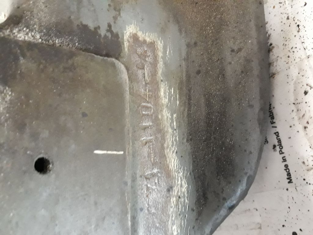

      Hi. Picked up a ml7 and cant make out what year its made. Numbers reed i think 71-1104-4. If i skip 71 then its from 1946 but is that right? The numbers located at the back of the lathe. Thankful for answers, i will begin restoration shortly.

                    Any chance of a nice clear photo of the stamping?

                      Thank you guys! I tryed to upload a photo but cant seem to figure out how. Will try again later to day.

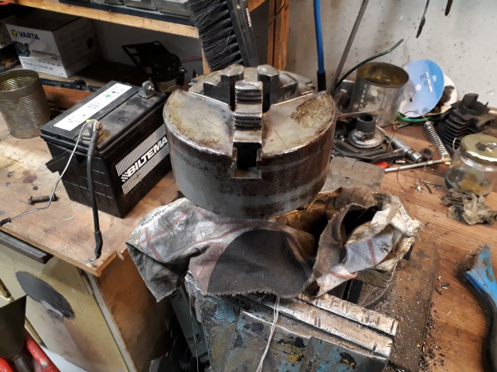

                            On another note, is there a ralnr for the colourkode or is it colour analasys to get the right shade of greysmiley. I took it apart last night and my oh my how its been mistreated. Drive belt was a shortened fan belt from a car, put together whith steelwire. Sprockets had less teeth left than my old grandfather. Surface rust on the bed and chuck.. well its a challange. Im although overall exited to finally have one after serching for 10years!

                                Not sure from your photo quite where on the lathe that number's stamped. On mine it's on the end of the machined vertical surface of the shear, just below where the tailstock is usually parked, and I think that was Myford's normal practice and mentioned in the operating-manual.
                                I don't know if the longer numbers normally had hyphens. The Lathes.co list does not quote hyphens but the compiler might have been left them out.
                                Still, it does look like a serial number, but as I say the number you quote, with 6 digits, would suggest your lathe was made in the early-1970s; more recently than you thought.
                                It's not been re-ground, well, not by Myford. They designated that by adding an 'R' to the number; but that's not there and anyway, from what you tell us of the machine's state the previous owner wouldn't know a re-ground from coffee-grounds.

                                  If it's any help, it does say 'Made in Poland'.wink

                                    Could this be a dealer's number? I have often found a dealer's number as well as a manufacturer's number when looking at old reed organs.

                                      Yep, that's not a Myford serial number, it should be where Jason says.

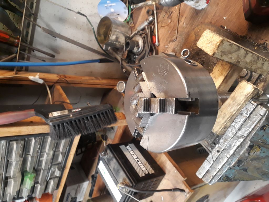

                                        Well, thanks to everybody for the comittment. Haha made in polandlaugh I have after taking it apart and a good clean found the serial number. Its from 1960 and the numbers were as you said at the back of the bed. It has been a fantastic fun job and i am so exited to bring this piece of industrial art back to life. It is in fair nic, no bad wear as far as i can tell and the pieces i take off is cleaned in my washer and prepped for paint/polish. Most timeconsuming is the surface rust thats sadly been allowed to have a party on all of the bare metal surfaces. I have a good chemical for that and it does the job. So far so good and i must say it is a absolute joy working on.

                                            Great stuff Johan. Keep the pictures coming.

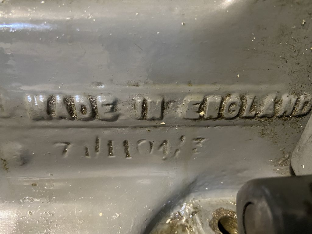

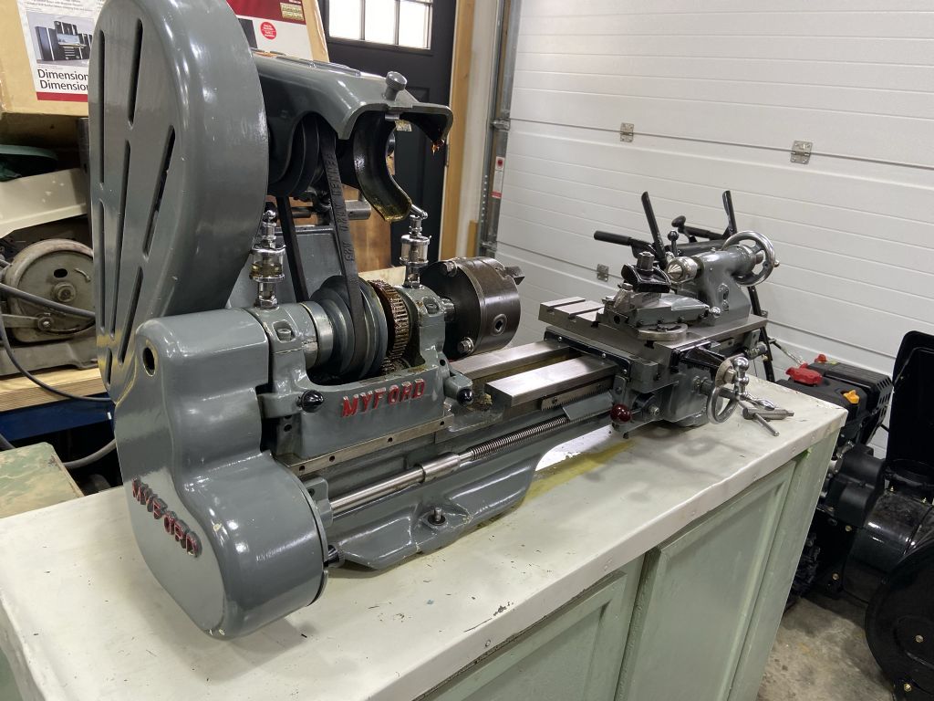

                                              Hello all, I just recently purchased a ML7 and was also Googling the strange SN. Here’s a pick of mine, can
                                              t find any other SN’s on the machine. Wonder why these numbers are there?

                                                    You should read the earlier posts in the thread. All will be revealed I think.

                                                      Hi Jeff, yes read through it, I don’t actually have any other numbers marked on the bed. Was trying to see if anyone had any other info on what the 71/1104 meant?
