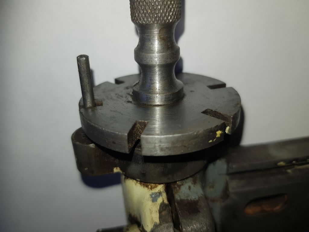

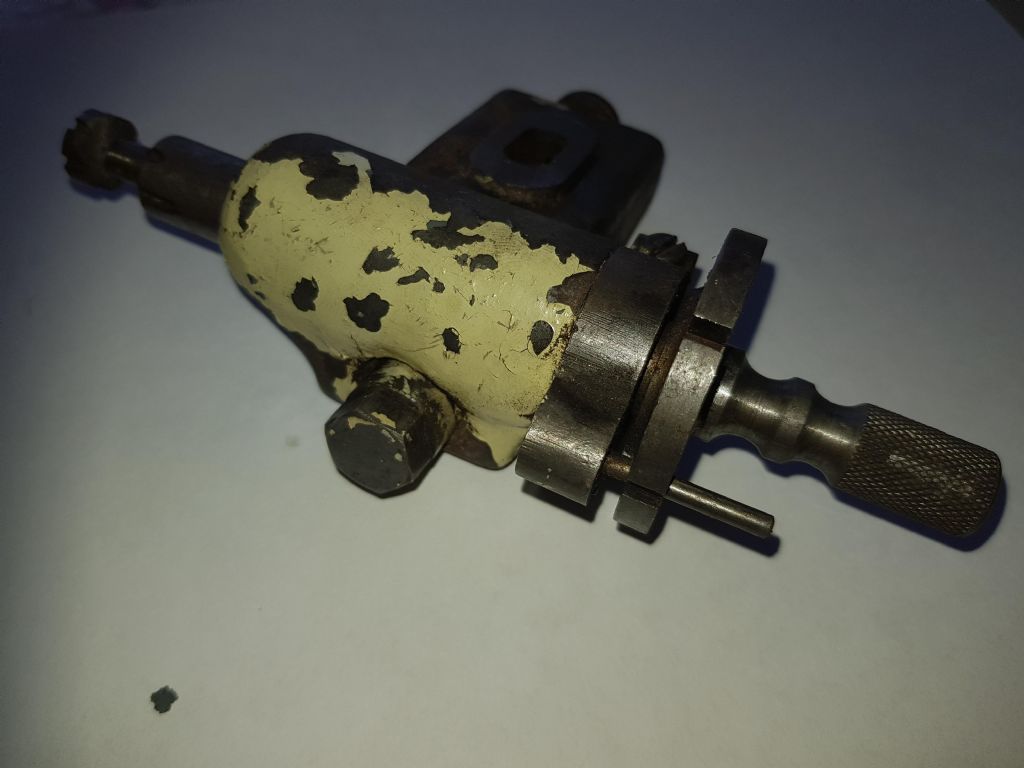

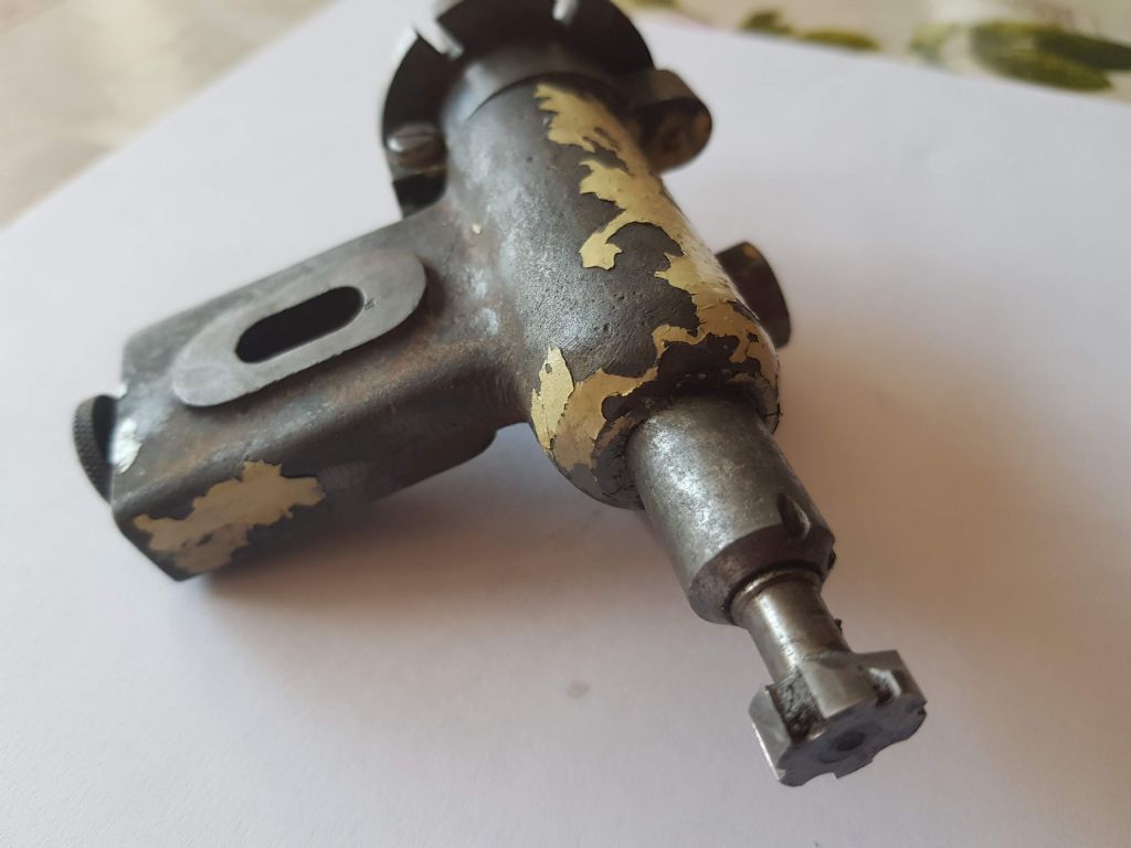

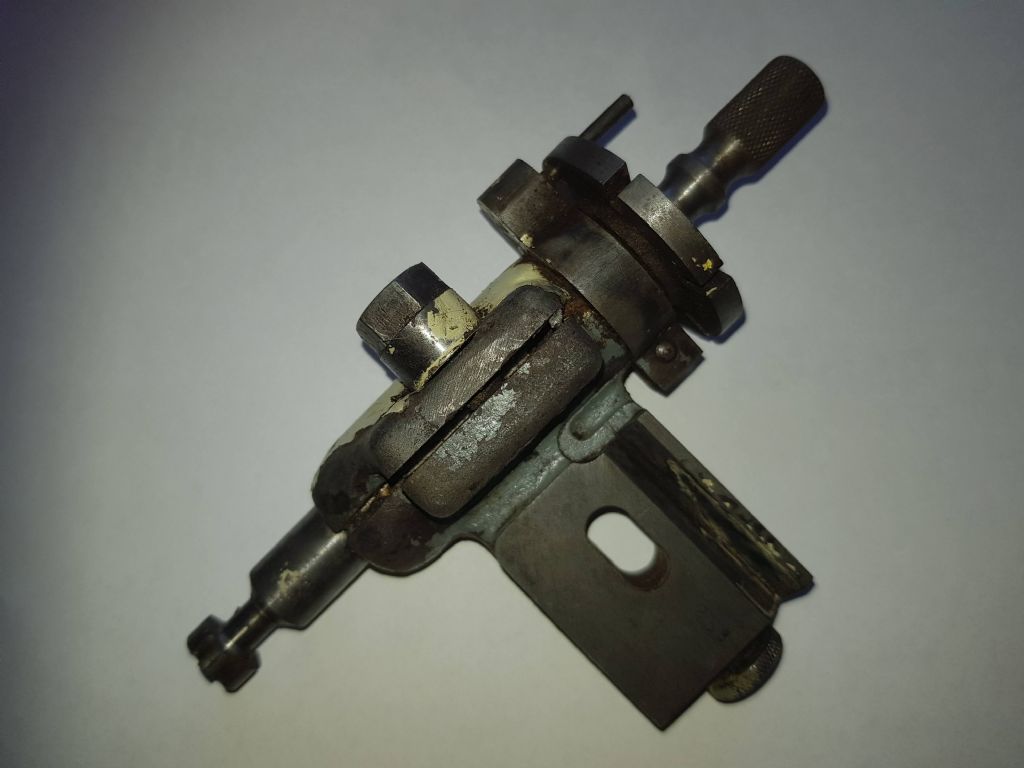

                          Myford ML 7 mystery part ?
                          does anyone know what this is….came with a load of bits when recently aquried a 1956 Myford ML7
                          looks like some sort of indexing device but cant see anything in old catalogues for Myford parts.
                          thanks

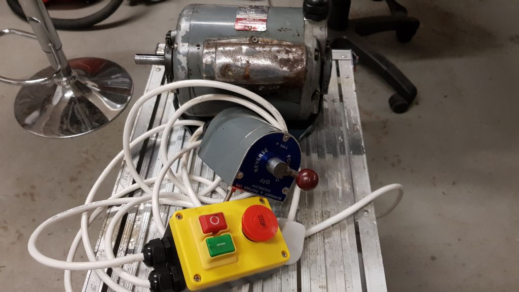

                              As said by others do not put any load on the chuck in reverse. I suspect you would not & that you want reverse to leave the leadscrew engaged & revers back to the begining of the thread which a lot do. I have a nearly new Dewhurst switch & stop start station all wired up for the Myford super 7. Also the 3/4 hp single phase motor. I did advertise on here a long while back. Not sold. Also have the wiring diagram somewhere that came with the lathe. I guess i could split from the motor & save the motor for future projects.
                              Not sure where you are in the country. I am in Leeds. P.M if interested. Will not put a price on here as not sure of rules.
