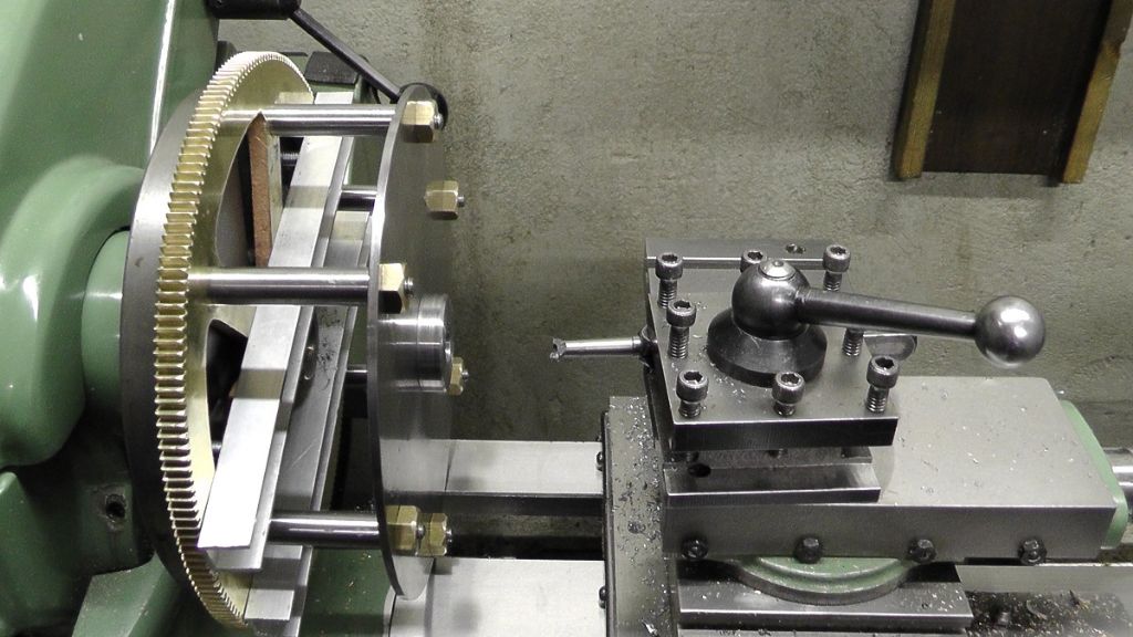

                              Whatever lathe you have, by times you will go to its limits. Myford is for most of the work I do more than large enough. In the picture the exception, it cleared the bed but not by much. Niko.
