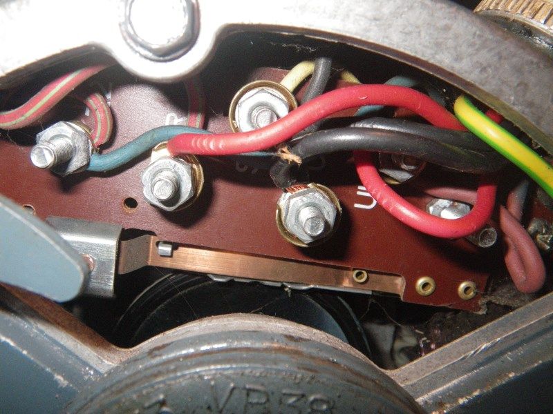

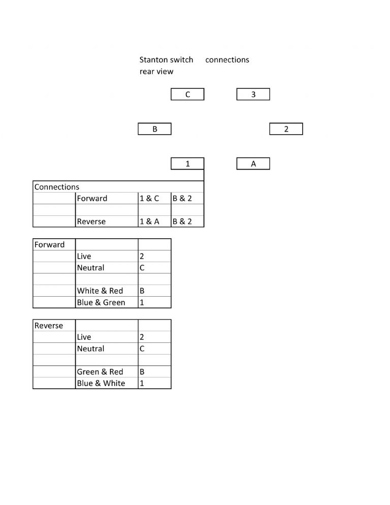

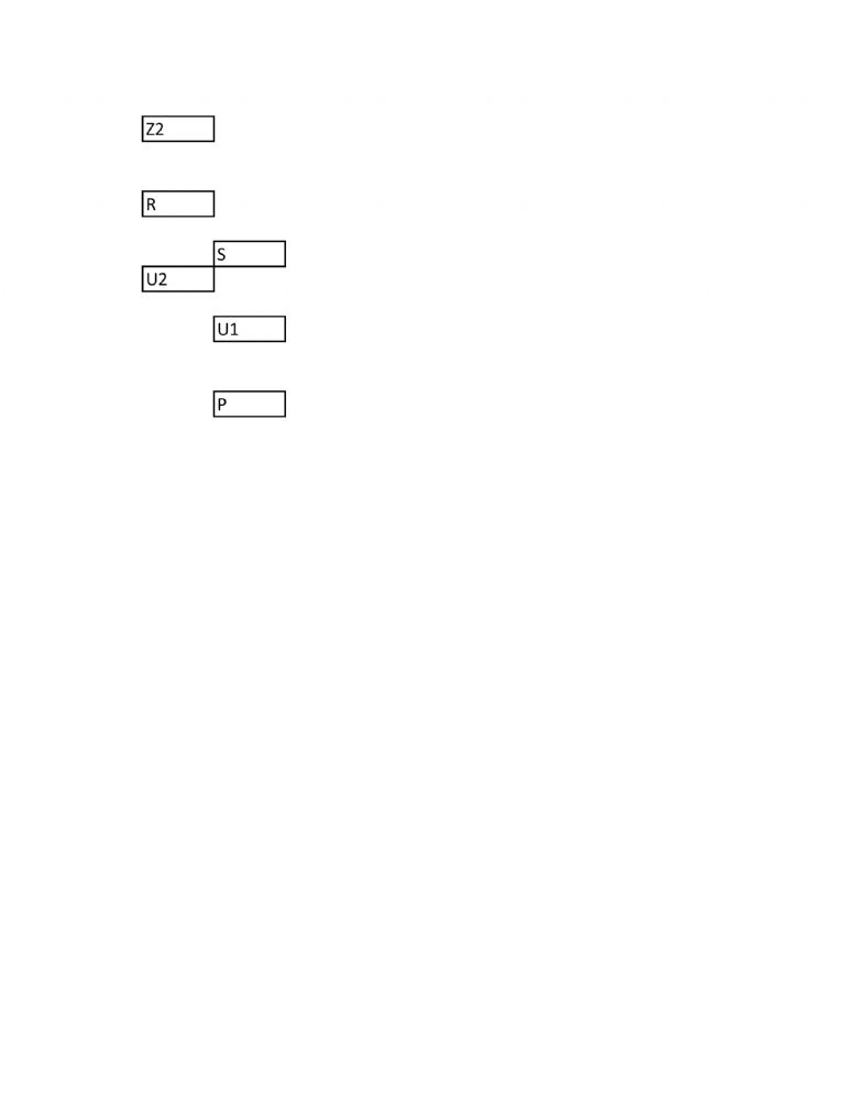

                            #164319
                            Ian Symes
                              @iansymes12360
                              Hi Guys

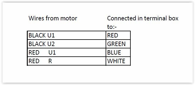

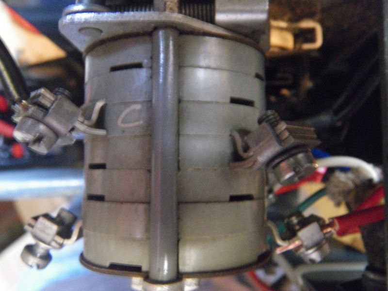

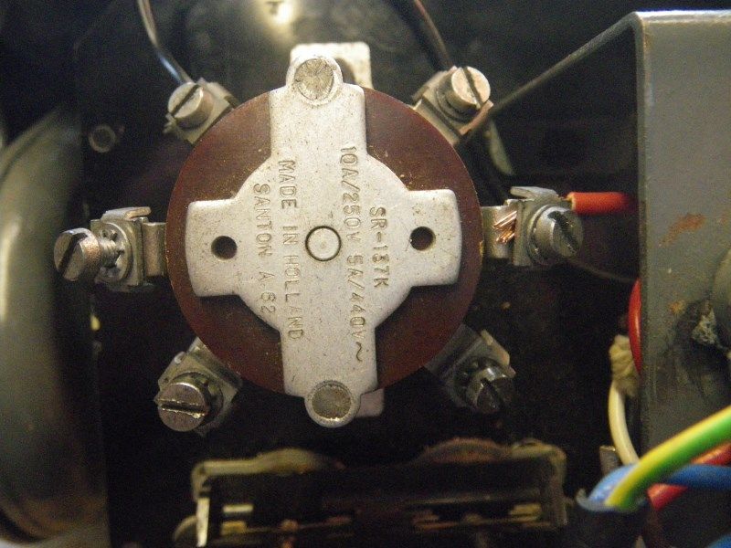

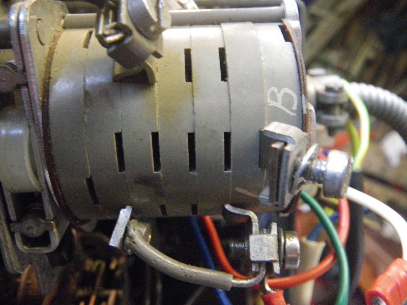

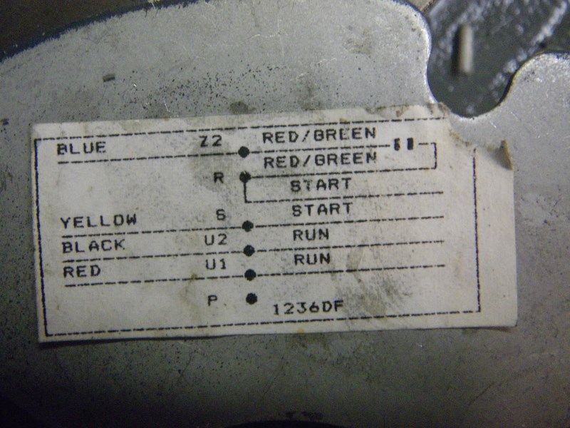

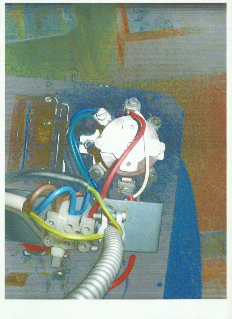

                              I have a similar problem.
                              I can't get the Stanton switch to switch forward/reverse from the Brooke Crompton motor.
                              On my Super 7
                              The switch has different connections to that shown in the manual.
                              LH from the top, rear view
                              C B 1
                              RH
                              3 2 A
                              I have drawings on PDF but can't attach them.
                              Without them the above wont mean a lot.
                              How do I attach them?
                              Thanks
                              Ian

                                      #164372
                                      Ian Symes
                                        @iansymes12360
                                        Hi Les.
                                        As you can see the photos are on the forum,
                                        thanks to a friend who came into the office.
                                        Ian.
                                        #164381
                                        Les Jones 1
                                          @lesjones1
                                          Hi Ian,
                                          Can you confirm if the switch is 2 positions (Forward Reverse) or 3 positions (Forward off reverse) ? Also can you confirm that the table labelled "connections" in the picture of switch information shows the contacts that connect together in the 2 or 3 positions of the switch and in no position terminal 3 connects to any of the other terminals ? If this is the case then this switch cannot reverse the motor. Is this data from a document or have you worked it out by testing for continuity between the terminals ?
                                          Les.
                                          #164386
                                          Ian Symes
                                            @iansymes12360
                                            Hi Les,
                                            The switch is 3 position.
                                            It is probably the original switch the lathe is on a Myford industrial stand.
                                            The switch position is something I worked out.
                                            I'll check position 3 tonight.
                                            Ian
                                            #164462
                                            Ian Symes
                                              @iansymes12360
                                              Hi Les,
                                              Thanks for all your help.
                                              3 is connected to C when the switch is in reverse.
                                              Ian.
                                              #164463
                                              Les Jones 1
                                                @lesjones1
                                                Hi Ian,
                                                I would expect 3 to show continuity to A in the forward position of the switch. Can you double check if this is the case. If it is not the case then I suspect that the switch is faulty. If it is the case it should be possible to get the switch to work but it will only provide single pole isolation of the run winding. (If it was used for reversing a 3 phase motor then it would isolate all 3 phases in the centre off position.)  In one of the pictures of the switch there is a short grey wire linking two terminals. The right hand terminal is 1 (I think) Which terminal is the other end connected to ? In the picture they both seem to be in the same angular position which does not make sense as the 6 terminals appear to be at 45 deg, 90 deg, 135 deg, 225 deg, 270 deg, and 315 deg.
                                                Les.
                                                Edited By Les Jones 1 on 23/09/2014 22:29:19
                                                #164477
                                                Ian Symes
                                                  @iansymes12360
                                                  Hi Les.
                                                  I will check the switch position tonight.
                                                  The link in the photo is below, in line with terminal 1 looking from the back of the switch and is not marked.
                                                  Ian.
                                                  #164478
                                                  Les Jones 1
                                                    @lesjones1
                                                    Hi Ian,
                                                    So there are 7 terminals on the switch. (Or are there even more ?)
                                                    Les.
                                                    #164499
                                                    Ian Symes
                                                      @iansymes12360
                                                      Hi Les.
                                                      No more just the 7
                                                      Ian.
