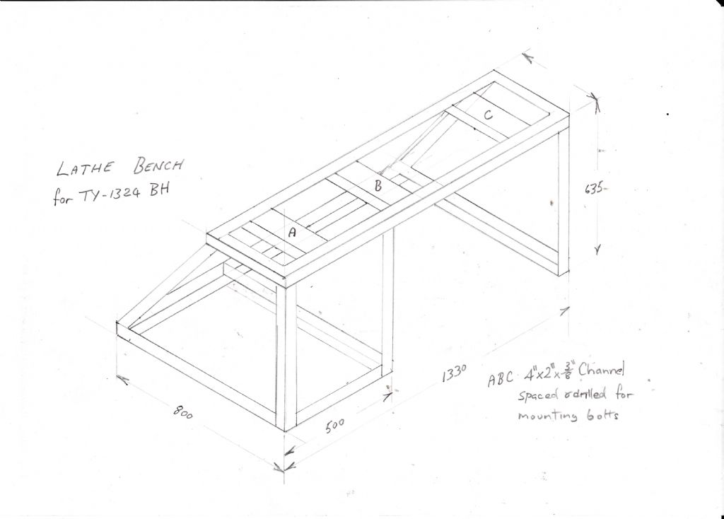

                            This is the stand II built for a much bigger Taiwanese bench lathe, the bit angled out the back adds to stability, and spaces the lathe away from the wall, the near end, under the headstock has a door, and sheet metal sides, forming a cupboard. It is welded up from 50 x 50 x 6 mm angle iron, but square tube might be better. My bench has lasted over 20 years, and seen a couple of good sized earth quakes, and is still aligned.  It should not be too hard to make a drip tray from galvanised iron, perhaps with the edge rolled over a bit of rebar.
                            Edited By Ian S C on 22/04/2016 11:06:11
