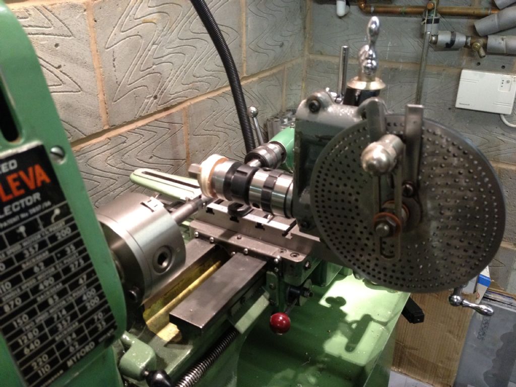

      Ive just acquired the above Myford dividng head, what precision! But I am puzzled as to what arbor attachment to use. Ive searched around Myford with no obvious answer. The head has two fixed centres and is obvious intended to use a between-centres arbor with spacing collars and clamping nut. But the nose is the usual 1 1/8 12 tpi Myford to fit a Myford chuck which could then clamp the arbor, but there is not much room and photos Ive seen show a 3ins backplate and maybe a carrier, but I cant find this offer for sale anywhere? So maybe Im barking up the wrong tree. Anyone know how it is done?

          I have used mine a few times now and although it came with a small chuck mounted on the 'nose', I used my ER32 Collet Chuck instead to hold my arbor. This works nicely as there is less overhang with the smaller chuck diameter and also less weight on the mechanism in general.
          I will see if I can dig out any photos of the setup. I am sure I have some, as I was pretty chuffed when I managed to get it all setup and cut a gear for the first time.img_1100.jpg
          Alternatively, I have seen the dividing head mounted up to the left of the headstock, so that it can be used to index the spinlde round for operations that you control on the cross slide, but I have not yet found a suitable way to attach and hold it round there.

            I think the idea is use either the chuck alone or between centers, not chuck to center. Between centers the carrier is just a standard one and a drive plate is just a chuck backplate.
            However as the drive plate does not need any precision like a chuck you can turn it up yourself even if a beginner to screwcutting and it can be aluminium. It makes sense to fit a brass locking screw. For small workpieces with little stress you don't even need to make it threaded – just a close fit over the thread and hold with locking screw. Finally for a quick hack just use a jubilee clip.

              The general idea was to set it up like a horizontal miller arbour with 2MT taper in socket at one end and centre support at outboard end .
              Strangely Myford never provided the arbour but dead easy to make one . You could make a proper arbour tooling set with different size shafts and sets of spacing and locking collars if you wanted to .

                Myford illustrations show clearly between centre on overarm and with the arbour retained in a collet Nose is standard with 2MT, so you can choose, ER adaptor, 2MT arbour, Myford collet whatever you like.
                Bazyle, this is a precision dividing head, properly fitted drive arrangements lead to better concentric accuracy!

                  I though I was being thick, but it seems to me that Myford stopped developing the Diving head and so never made a milling arbor kit to suit, they don't even suggest what to do. I will opt for the between centres arbor and backplate system. Collets (er25 adaptor £100, collects £145) is a bit steep for me.

                    2 MT and various collet holding methods are roughly equivalent and all satisfactory .
                    For something like gear cutting a between centres arbour and catchplate drive will be VERY much less rigid and may give you problems that you would not have with a more solid mounting .
