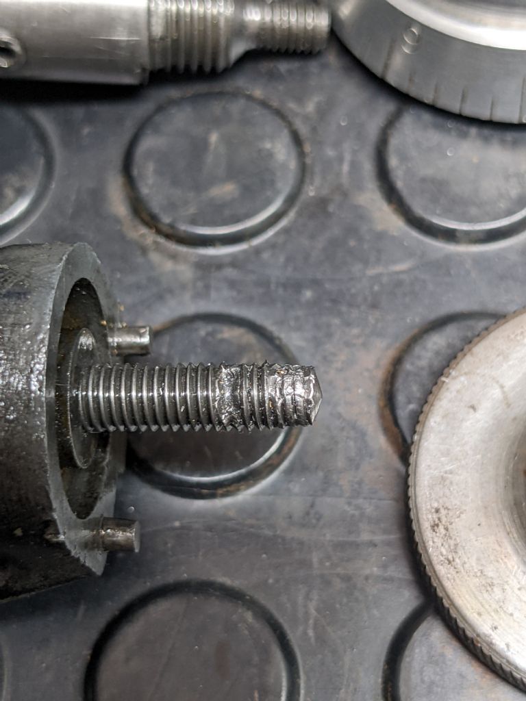

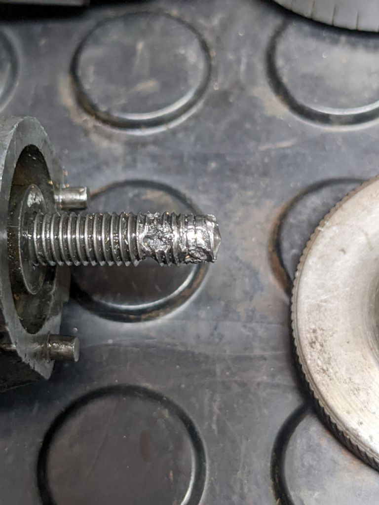

      Hi All,
      My "new" 1950 Myford ML7 came with a home made larger scale for the cross slide, see pic.
      The engineering is not great and was quite destructive to the handle thread. I do have the original scale and would like to use it. I'm not sure if this is possible with the state of the handle thread. I've cleaned up lots of bolts with files and using dies from the screw end, but this looks pretty damaged here, so very difficult to get a correct start. I guess the best way would be to use some sort of clamping die and unscrew/cut the thread. The thread is 1/4'' BSF.
      Is such a die available?
      Is the thread so bad that it's not likely to succeed?
      Thanks.

          YOu can get a 1/4" BSF die from Tracy Tools and many other ME suppliers who advertise on here and in the mag. It will clean that thread up ok. But your screw end looks pretty nasty and will be missing a lot of thread right where the original ball handle screws on, a critical point. (That damage would have been done by the original set-up, not the larger dial.)
          I would highly recommend sticking with your larger resettable dial, maybe using a tiny copper pad under the end of the grub screw so it does not chew up the thread again after you clean it up. The missing bits of thread will not be so critical in that set up.
          Plus the original ML7 dial is a miserable little thing that should have been tossed away at the factory. Too small to read, does not reset to zero, and so cheaply made the lines are not precision at all and the Mazak internal thread strips every time a stiff breeze blows in the workshop door. That is why someone went to the bother of making their own larger, resettable replacement. Well worth having. I made my own larger resettable dials for the ML7 and regard it as the best mod ever made. Should have done it years ago. Being able to reset the dial to zero massively simplifies life when taking multiple cuts or screwcutting etc. No more mental gymnastics and felt pen marks and cursing and swearing.
          If worst comes to worst, you could cut that threaded spigot off, drill and tap the end of the feed screw and put in a replacement threaded section. But I would not go that far if the larger dial works ok with a bit of fettling on the uncut screw.

                  I think I would be inclined to turn the thread off and loctite a sleeve onto the new parallel portion of the shaft. You can then set to run true and turn to size and screwcut the thread finishing off with a die. If you are clamping a threaded collar to a threaded section using set screw(s) then the screws should always be fitted with copper or brass pads under the screws so the pads bear on the thread. Copper is soft enough to deform and not ruin the thread but a better way is this.
                  Turn up a small pad of copper/brass to just clear the set screw threaded hole. Thread the collar onto a rod which is close fit on the bore of the collar. Insert the pad into the threaded hole and with a punch down the hole give it a sharp rap with a hammer. This will expand the pad and retain it in the threaded hole. Withdraw the rod through the middle and replace with the correct size tap and fit the set screw. By judiciously advancing the pad with the set screw and turning the tap back and forth a matching thread will be cut in the end of the pad. Reassemble the whole and then when the set screw is tightened there will be absolutely no damage to the thread ever again.
                  Don't thank me, this is the way George Thomas did it. (the pad not the loctite bit)

                      Jon Halland
                        @jonhalland84811
                        Thanks for the all replies.
                        My primary concern is to get the lathe cleaned up and back running, think exploded view – just a lot less organized. Hence back to original dial fitting which is simple, in it's time very cost effective and not bad design engineering imo. It solves:
                        Adding a dial and fixing it.
                        Adding a handle and fixing it.
                        Locking the cross feed screw in place and setting its tightness using the dial and locking it all with the handle.
                        All this for just 3 components (washer, dial, handle). The drawbacks in this solution are: a handle on a thread (can unscrew) that relies on the soft metal of the dial to 'bite' and fix the whole thing, so limited lifespan.
                        I would like to have an adjustable dial working but the current version is not my kind of engineering:
                        The back plate with the marker is loose and the small holes to hold it are elongated so it can move about a mark. This is part due to poor drilling and it being part of the tightening of the whole screw/dial/handle system.
                        The stud with the 2 set screws is threaded and the set screws forced into the cross feed screw, so to screw the handle on as the last bit the feed screw has to be grabbed with a pair of plies on the other side of the bracket and tightened a lot, not to unscrew in use – all force through the set screws. This is probably what caused most of the damage to the thread.
                        A future project could be to use the marker and dial plates and make a better solution.
