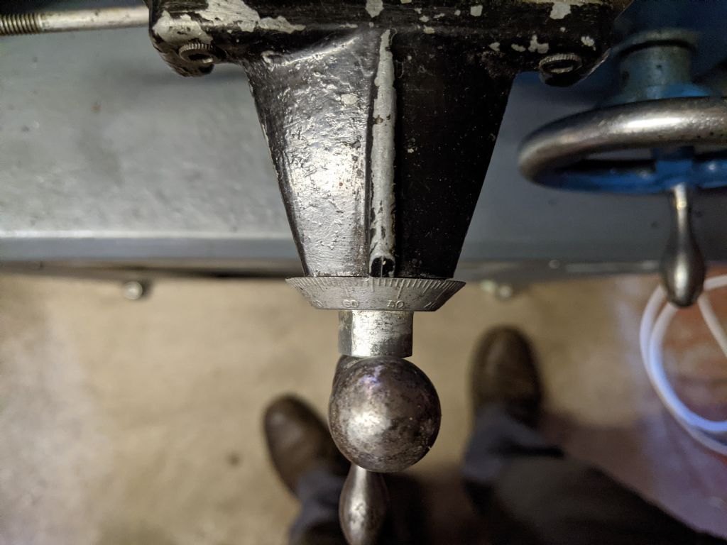

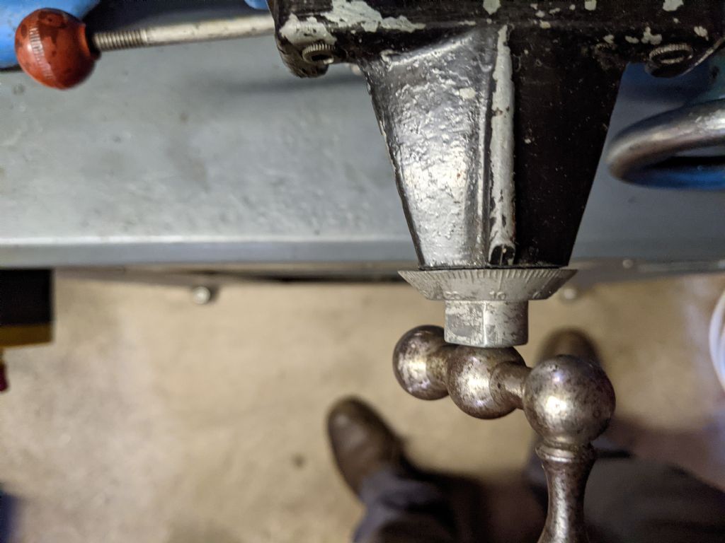

                  I tried undoing the handle then tightening the micrometer scale up a bit to take out the backlash but I think the cross slide feedscrew is bent as the scale is not parallel to the endplate and goes tight then loose and then tight again as you turn the handle. I don't think there are any fibre washers in the assembly either
                  I was trying a very basic turning operation on a piece of round bar. I wound the cross slide in until it touched the metal and then traversed the carriage right to left. I could see the cross slide moving back and forwards

                    I think you can just make out here the difference between the micrometer scale and the end plate

                      I took apart the cross slide. The feedscrew is bent at the outer end were the handle and micrometer dial attach, its out by about .020" New feedscrew? With the feedscrew taken out and screwed into the nut on the cross slide, there is a good deal of run out. Do I need a new feedscrew?

                        You could at a pinch straighten the feedscrew. Remove it and hold the threads in a vise use some protection for the thread. Put a close fiting pipe over the bent end and pull gently on the pipe to straighten out the bend. With a bit of judicial force you should get a decent result. Make sure that the bend is close to the vise and dont try to yank the bend out be slow & carefull. Slowly slowly catchee monkey.
