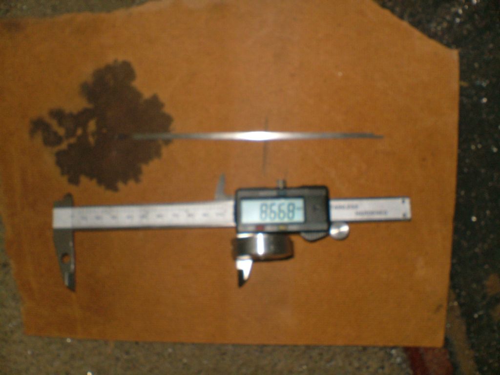

                                DRO the slides, digital calipers cost a tenner, and get the changewheel setup for threading purposes

                                              Ady1
                                                @ady1
                                                Perhaps change the gearing on the lead screw but leave the top and cross slide as they are and fit a DRO of some kind
                                                Fit a 10 quid DRO to your cross slide one evening and be amazed
                                                The Digital vernier I use switches off automatically, stores the reading and uses AG13 poundland batteries
                                                It's the best simplest most useful mod you will ever make
                                                The biggest problem is drilling the stainless jaws, they are TOUGH, you will need to drill them with carbide
                                                http://www.model-engineer.co.uk/forums/postings.asp?th=55550
                                                gl
                                                Edited By Ady1 on 09/07/2012 09:40:36
