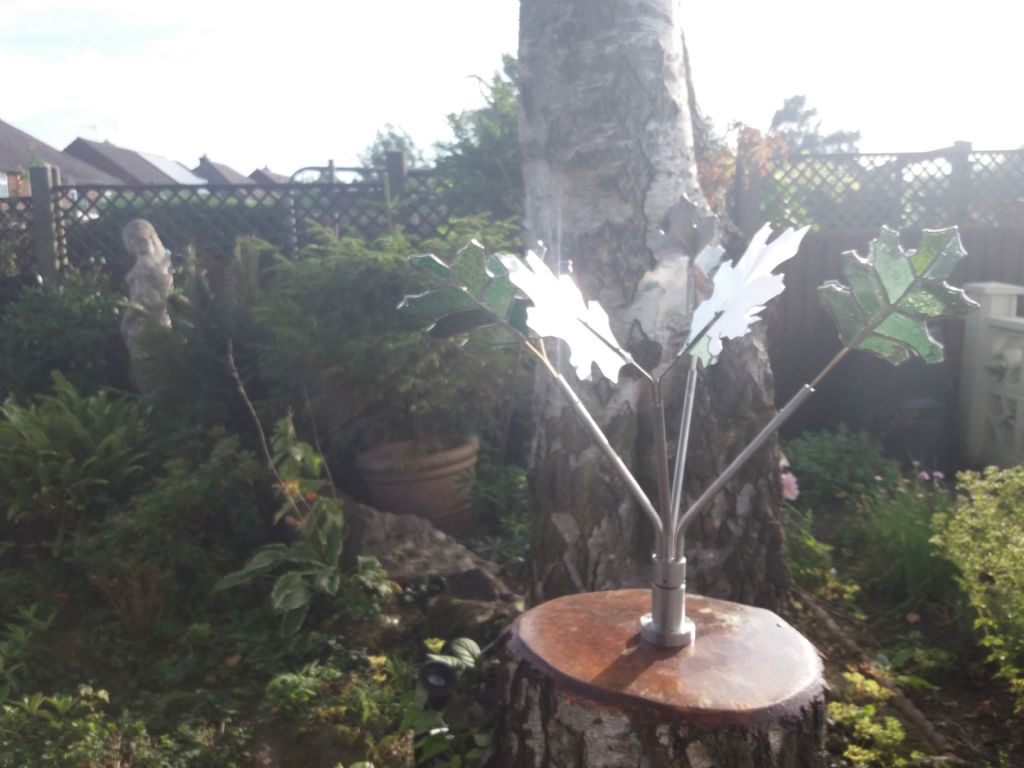

          Hi Cal I make some jewelry as well as models and replacement tooling like ring mandrels, stamping jigs etc. I use a M Type Myford Drummond/Myford lathe made around 1950 but it is very accurate as it has had little use by previous owners. The only problem I have is the spindle speed is only 950rpm which limits small diamiter turning like retaining pins and bushes, under 0.030 inch diamiter, for some part is difficult but do but possible with care. It has a single phase motor and has the capability to screw cut and with a vertical slide and vice it will mill as well so it is fairly versatile. Think what you may want to turn or mill etc before you buy as you may be limited by turning larger pieces on a small lathe or small pieces on a larger lathe but there are ways round both to some limits.
          Rotary sculpture I made and a wire drawing jig for drawing silver wire I also made cheaper than buying one.
