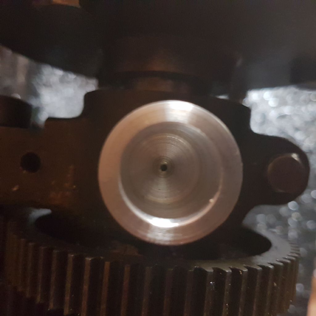

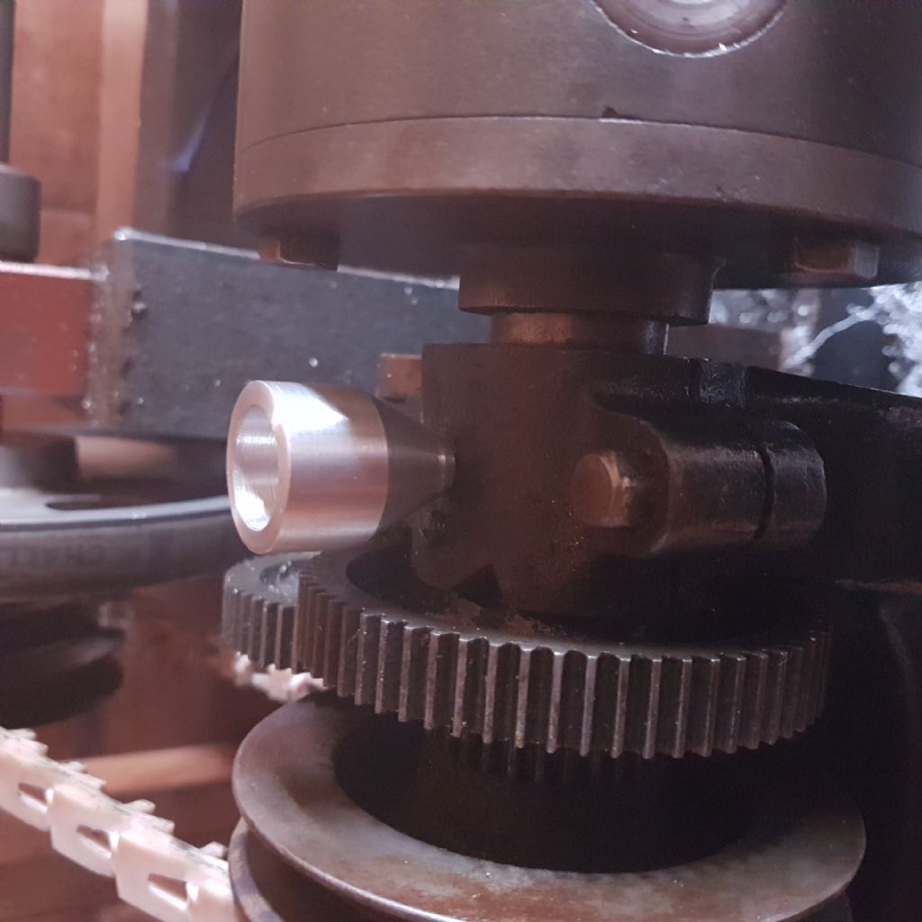

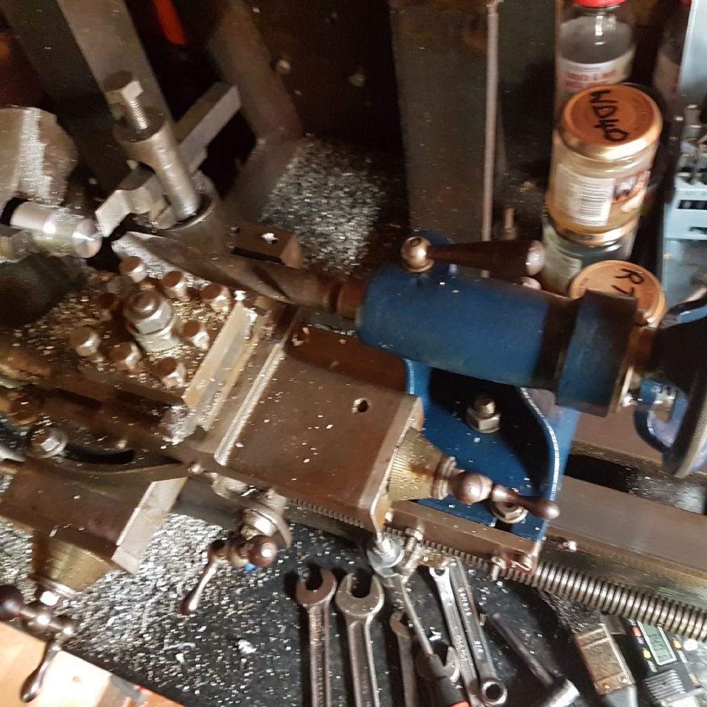

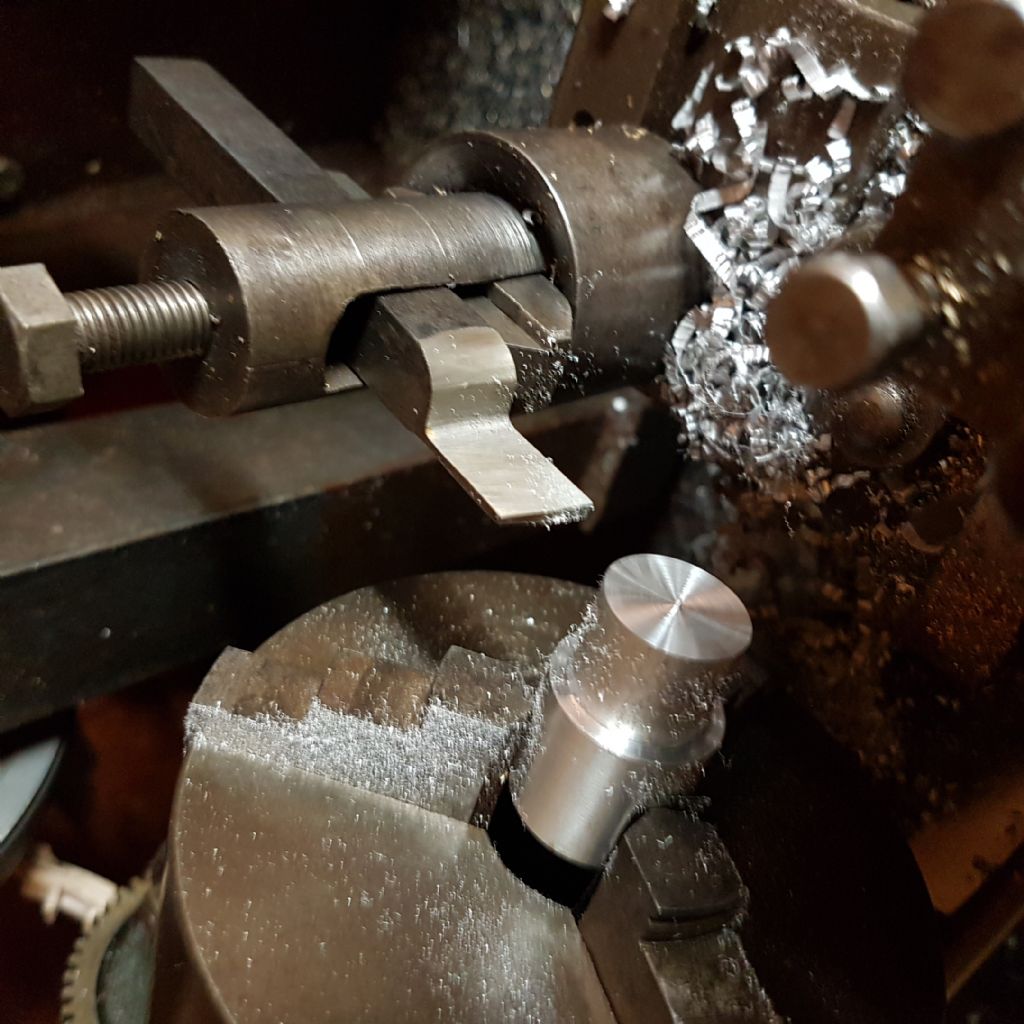

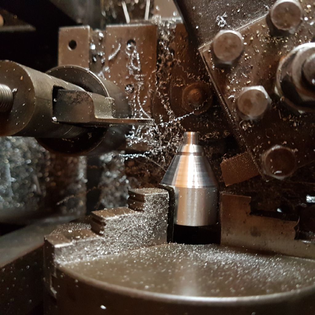

      First attempt at making an oil cup, hasn't gone so well, removed 7thou too much from the end that goes into the headstock so it's a loose fit. Not good! Will try again, though this one has at least sorted out what steps I need to take and what order, so the next two will be quicker.
      Could have sworn I'd taken more photos, steps I took were to face off the large end of the blank, then turn the outside so I had a good finish, this was then spot drilled, then drilled with a 7mm bit then stepped upto the large taper drill you can see in the photo bellow. This has a tapered point to it and left a nice chamfer to the edge no need to bore it.
      The blank was then turned and trued up in the 3jaw, parted off to length, it needed packing one side to run concentric with what I had turned on the outside, I stepped the edges turning the nub on the end to what i thought was final diameter, and then proceeded to turn a cone on the end towards the nub. This was then drilled with a 1mm drill bit.
      Edited By Jon Cameron on 03/10/2017 18:12:30
      Edited By Jon Cameron on 03/10/2017 18:13:10

            Do you know why you had to pack your chuck out?
            Is it a chuck issue, or is the tailstock out of line? (and i'm guessing the latter, given that it has been off, and the known problems with aligning the ML4 tailstock).
            I would be wanting to get that sorted before I started doing any jobs on the lathe.
            The other option, if you can't get the tailstock in line with the chuck, would be to use your four jaw chuck for truing up the work to turn it after it has been drilled in the tailstock, rather than packing out the jaws of the three jaw.
            That's not a criticism, just that you will be handicapping yourself with it like that smiley

              Thanks David, I had turned the diameter of the top part of the oil cup, when I turned it around in the chick, (and since I don't have a dial indicator yet), I used the parting off tool to check alignment, I found that it was running out on one jaw. I cut a piece of coke can up and skimmed that jaw, it then ran true. So I'm 5thou out on my 3jaw. Then I proceeded to turn the rest of the lower half, now that it was running concentric to the top half.
              It's not really a handicap, so long as you know about it, and can fix it with a cheap can of beverage. I've noted which Jaw it is, and once I have a dial indicator, (totally skint lately), then I can try dial the chuck in and get it more accurate. For a part such as this it wasn't so critical. It was my error that it's been made too small, 3 and a half turns (indications) too many on the dial indicator turning the final diameter.

                I misread your earlier post. I thought it was the external diameter of the piece was out of line with the hole drilled by the tailstock drill.
                Having to pack the jaw out would irritate the hell out of me!
                Are they matched (and numbered) jaws?
                If one jaw is out of line with the others, you won't be able to 'dial the chuck in' on a three jaw chuck, unless it has a Griptru type adjustable backplate.
                You can, however, get the jaws ground back to true.
