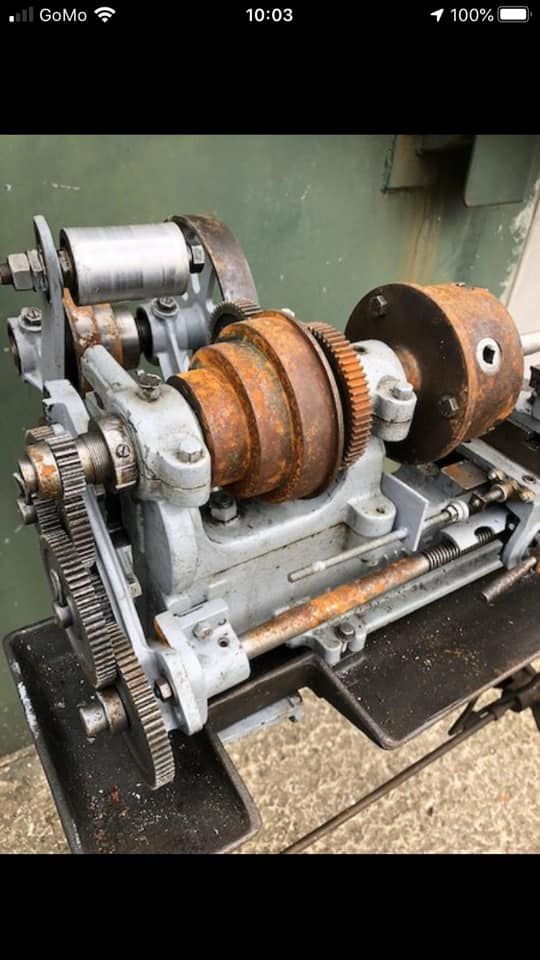

        A thread on my Myford ML2 resurrection. There is very little information about on these lathes so I will add as I go. Hopefully will be useful to someone in the. future. Here is a pic of her as I bought her, 83063677_10220672937629459_3325744823998087168_n.jpg

          Makes you wonder about Health & safety back then. None I guess. I have worked in some factories that had line shafts driving polishing pans. That was at Trebor Bassets ,Pontefract. You could have stuck your hand anywhere in moving pulleys. Good luck with the restoration. Keep posting.

            This similar to my old Southbend lathe but there would have been a cover over the gears which are missing in the photo.

              Good to see the old iron being used in anger still. I've a Drummond M-Type that is similar era and style and it does surprisingly good work. Good enough to make a GH Thomas dividing head that is accurate to within a thousandth of a degree.
              I use a modern Poly-V drive belt (same as a car serpentine belt) running straight on the old flat pulleys and it works a treat. Looks like you have the original drip tray with cutouts for the pedal-power drive belt. Neat.
              I don't think many of those old Brit lathes had gear guards until about World War 2 era and belt guards came post war with the ML7 AFAIK. Been using mine sans guards for over 50 years (it was my Dad's old lathe) and still have all my fingers and my nose.

                There are quite a few mentions of the early Myfords on here though often buried in a thread about something else. There are also some mentions on the Drummondlathe group at Groups.io. Probably also most specific knowledge is on the Myford Groups.io section. On Lathes.co.uk for this model there is little about the layshaft so some more photos of it would be interesting and I'm sure once cleaned up Tony would appreciate a few high resolution pictures of that part.

                  Lathes UK website carries a lot of info about the Myford M types (ML1,2, 3 and 4 ) The 1 and 2 were 3.125 inch centre height and the 3 and 4 were 3.5 inch, as were the ML7 Series.
                  The tailstock alignment locking is not of the best, but useable.
                  here, we are talking of machines anything up to 83 years old, that have had widely varying degrees of care and attention, or abuse ).With any old machine, you have to be prepared to spend time and effort getting them back into good tune. Once sorted, they are capable of good work, within their limitations.
                  Nowadays, you are likely to have to make up your own layshaft arrangements.
                  If you want a really fine feed, you may well need a couple of extra 20T gears, and a 60T. Thankfully, ones for the 7 Series can easily be modified by drilling a hole for a Driving Pin. You should then be able to reduce the power feed down to 0.0047"/rev.
                  There were two types of gear cover. The one most frequently found hinged on a horizontal bar behind the Headstock. The side hinged cover is a rarer item.
