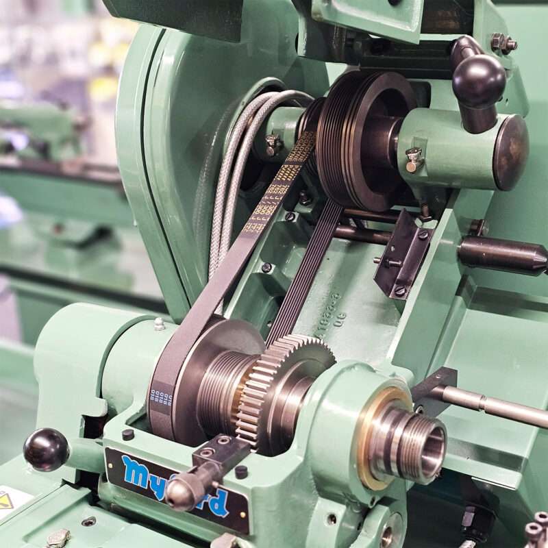

        Hi Pothole 50 welcome to the forum.  This picture may help. There is a lever on the clutch which engages disengages by pulling forwards and backwards radially the ball ended piece which slides the clutch shaft in and out.

            The Myford ML7 Users Manual is comminly available for free download if you Google it. The ML10 differs in detail but general principles are the same.
            As already said above, could be the clutch lever and or belt tension lever need a nudge. Both are located at the right hand end of the overhead countershaft, pretty much straight in front of the operator’s nose when standing at the lathe.
            Another possibility is the back gear dog is not engaged. Symptom here is that the stepped pulley on the main headstock spindle behind the chuck is spinning, but the spindle itself is not, therefore the chuck is not spinning . See the manual for how to engage the back gear dog at the large end of the stepped pulley. And make sure the back gear lever is disengaged, or it will lock the spindle.

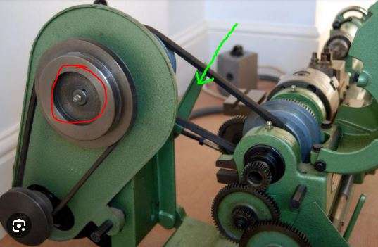

              Check that the belt tension lever is in the right position to tension the belt otherwise it will just slip (green Arrow)
              if the 5″ hole is in the teardrop shaped cover and where circled in red then likely a retrofit clutch

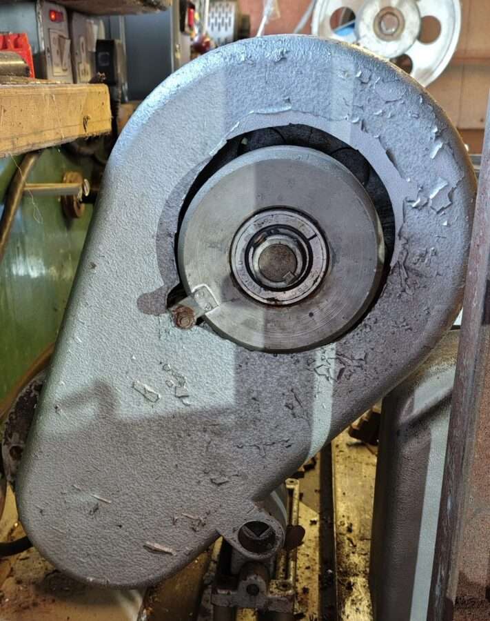

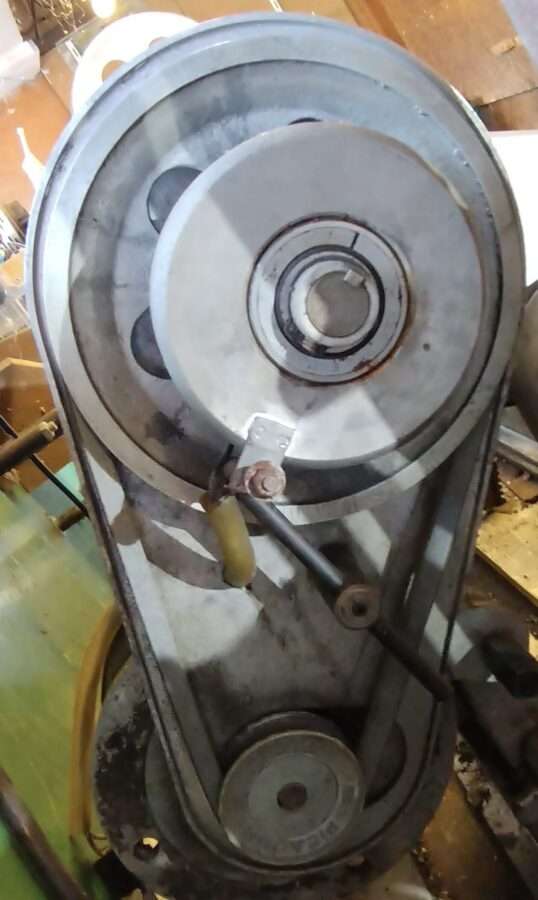

                  Thank you all for the help, it looks like the machine has been modified, I have found the gallery section and uploaded a few photos, hopefully someone will be able to identify the clutch and how to engage it to make the chuck revolve.

                    It looks to me to be an Electro-magnetic clutch. There must be another switch which engages the clutch.

                      I noticed wires exiting the clutch unit – it could be something along the lines of the electrically activated clutch used on car air-con compressors.  Try following the wires, see if there is a switch, and some source of power (my guess would be 12V operation, but could be different depending in the source of the clutch).

                        Hard to tell from pics  but that rusty bolt on the outer clutch housing near the apparent wires looks very much like an anchor.  So it might be a combined clutch and brake unit like those used on industrial sewing machines etc.
                        Definitely follow those wires and find the actuating switch to see if the clutch can be made to engage.

                                Looks like an electro magnetic clutch. Follow the wiring and see what you find, a low voltage supply ? And a switch ?If there is no 12v or 24v transformer Try putting 12V  DC across the 2 wires, Does it go clunk or move, may be only 25 thou. Now start the lathe motor and see what happens. Good Luck Noel.

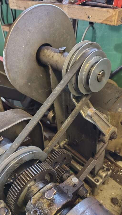

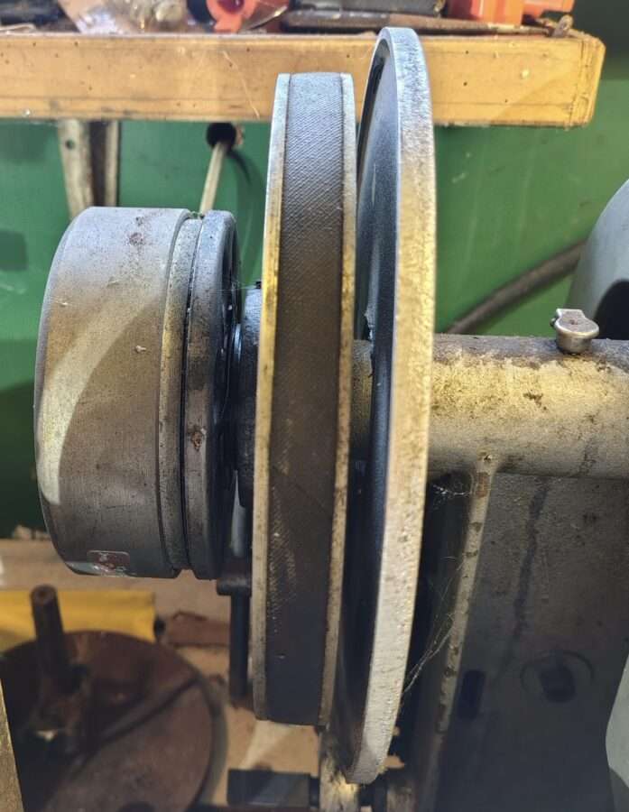

                                  Can’t help with the clutch, here’s the photos:

                                    On further investigation on the bottom of the clutch there is a label which reads, Warner Brake and Clutch and is rated at 90 volts 10 watts.
                                    My father in law was an electrician by trade so the wires disappeared into the shed wall, but I followed it to a light switch then further on to a big green ac/dc voltage meter under that was a Rotary Regavolt dial, and isolated by a fuse switch.
                                    By then I thought  I had cracked it so I switched on the isolated fuse switch there was a pop inside the green voltage meter and a puff of white smoke, so I quickly isolated it again, whilst watching for any flames.
                                    So at least I know why it was not revolving but can I fix it, I know the wires coming out of the green ac/dc were connected to the DC plug.
                                    Why was this clutch in place, surely the Myford is safe enough without it, and how easy would it be to reverse the process.

                                          Hey pothole, All is not lost, so long as the coil is not cooked, you know what the regavolt is and how to use it – it could have been set way to high hence the voltage meter and why it popped. It would be worth keeping, a clutch is a very useful extra and whilst your father in law used what he had but there are simple ways to get 90V and 10W is nothing. Do you know if it was DC ? Noel.

                                            Clutch is not needed for general work. If the electrics are beyond use/repair, your easiest option may be to revert to the original fixed pulley, locked to the shaft with a woodruff key and or grub screw.

                                              If you can get the electrics working, it’s possible the voltage regulator was used for gentle starts and stops rather than slamming full voltage on or off by the switch.
                                              Be cautious of slamming the brake on hard, the threaded chuck could possibly unscrew off the spindle.
