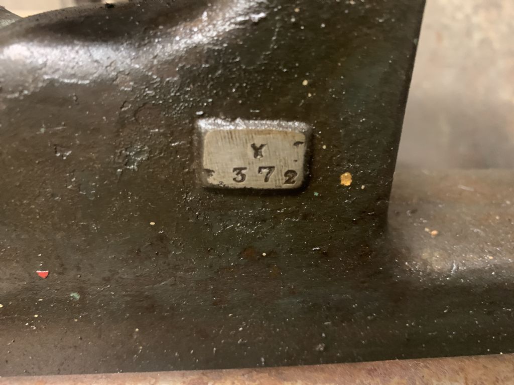

                  As always the answers are very informative and useful – I spent most of today stripping it down to clean it and inspect most parts.
                  It has the one piece headstock/body so that I assume makes it the ML 1.
                  Th original colour can be seen in areas that have never been seen since it was put together it is a very dark greeny grey. the gap between the bedways is painted a very bright red.
                  The cast in serial number plate just below the spindle is defiantly 352.

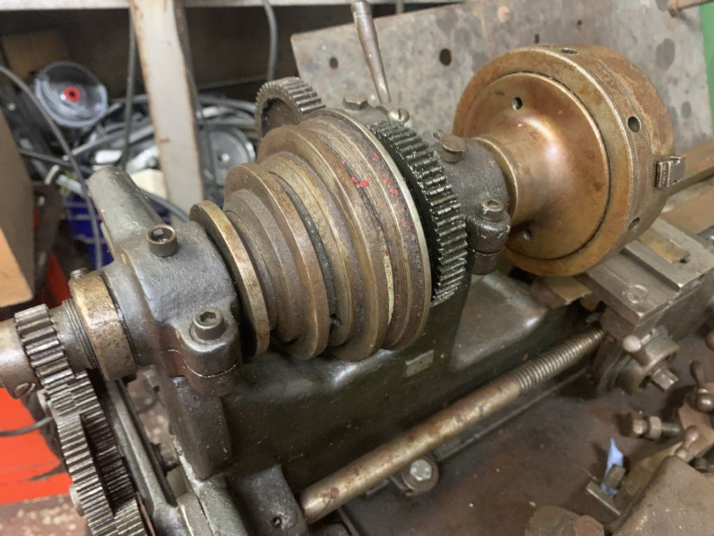

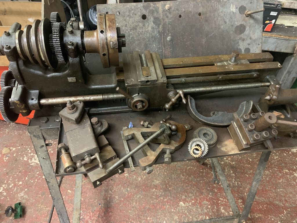

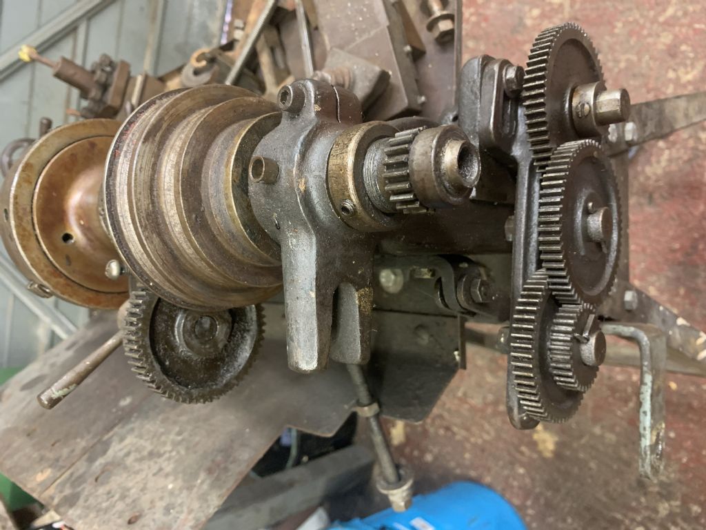

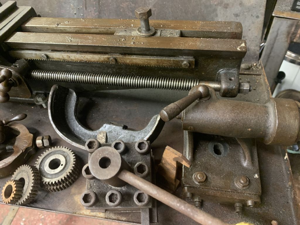

                      Some of the lathe before I totally stripped it down.
                      Found some very interesting bits – the chuck that is fitted in the pictures is very unusual as it has a large ring that moves the jaws – it with 3 other chucks that came with the lathe are all American made.
                      I'm not too sure what the two gears do which are fitted to the rear of the chuck – 9 oclock in the 3rd picture – other ML1's Ive seen don't have those – is it a reverse.
                      After these pictures were taken I finished strippijg it down for cleaning and repainting – I have decided I am going to paint it to match my Harrison 140 and my Alfred Herbert Mill.

                        The gear is for backgear, undo the V-belt drive allen screws locking it onto the headstock spindle and slide the gears in which should give backgear range.

                          Your current chuck is a Scroll Chuck, operated by two tommy bars.
                          If you decide to obtain conventional 3 and 4 jaw chucks, you will either need to make backplates for them, or alternatively make an adaptor so that the normally available chucks and backplates withr the 1.125 x 12 tpi, with 1.250 register can be used..
                          The adaptor will have a 7/8 x 9 (7/8 BSW ) internal thread for earlier models or the 7/8 x 12 tpi on the later ones.
                          To improve concentricity, once the internal thread has been cut, it should mbe mounted on the mandrel, and the external machining then carried out..
                          I was fortunate that a friend loaned me 7/8 BSW taps for the internal thread, so only the external thread needed to be cut.
                          If you want to make backplates from scratch, castings should be available from various suppliers, or just make up the adaptor, so that easily available backplates and chucks can be used.
                          Your machine does not appear to incorporate the optional Tumbler Reverse, so if you wished to cut Left Hand threads, only a single stage reduction with changewheels would be required.
                          You need a two stage gear train to traverse the Saddle towards the Headstock..
                          When you use Backgear, do not forget to slacken or remove the grubscrew in the belt pulley.
                          Do NOT engage Backgear with the grubscrew tight as a means of locking the spindle to remove a stuck chuck. That risks damaging all the gears involved, which will be very difficult to source for such an old machine.
                          If a chuck is stuck change the belt to minimum Mandrel speed, and tighten it. Then grip a piece of hexagon bar in a 3 jaw chuck to allow a socket and power bar to be hit with a mallet to jar the chuck loose
                          Alternatively, a long piece or bar or wood can be placed between the chuck jaws, and the end hit with a mallet to jar the chuck loose. If the chuck is REALLY tight, it might need several blows before to chuck frees off
                          If it needs to be said, never screw a chuck on under power, to avoid this problem!..

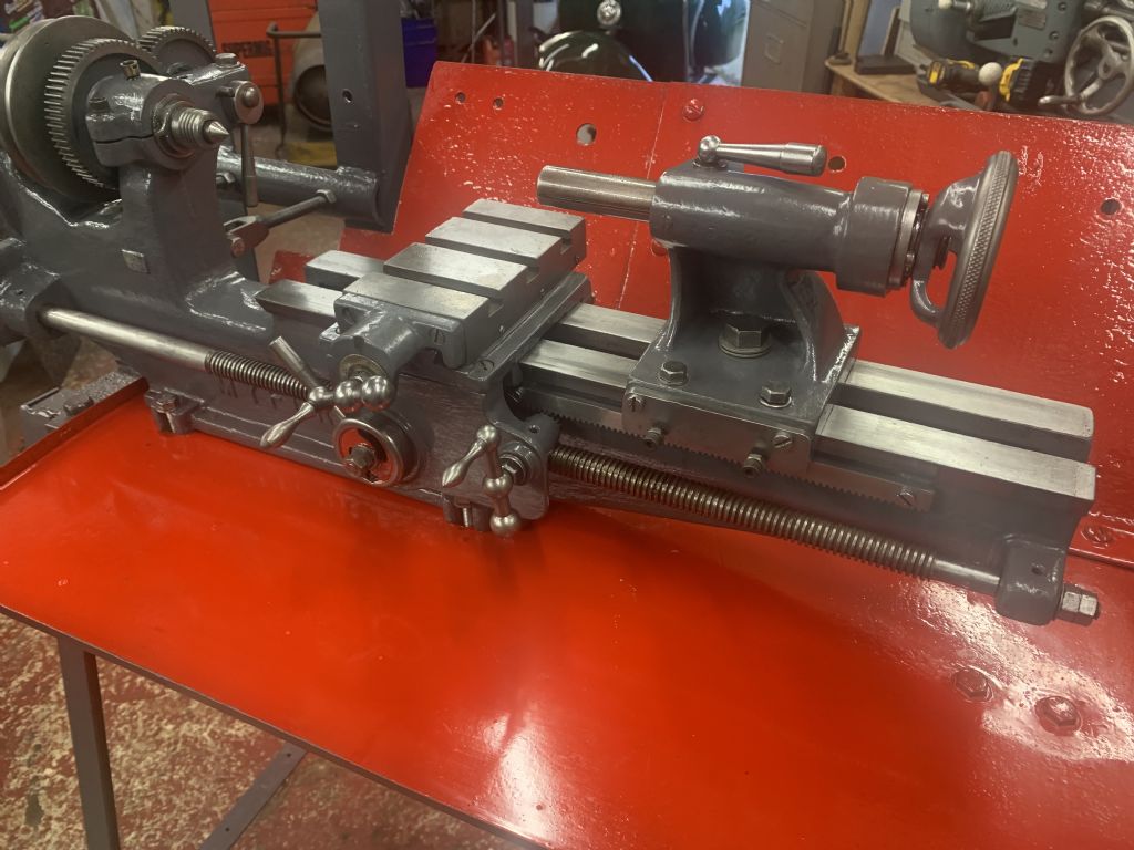

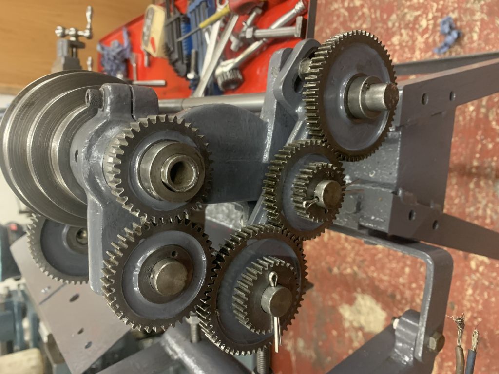

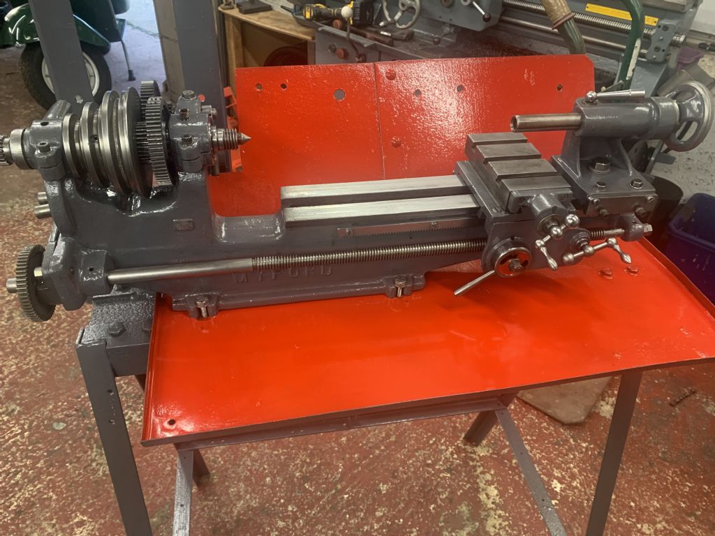

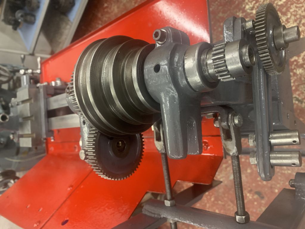

                                    After a week of stripping, degreasing, adjustment, a little bit of scrapping and painting i'm almost there.
                                    I need to adjust the tailstock and secure the motor, just waiting on new vee belts –
                                    There is some wear on the bed, it drops by 0.1mm right in front of the spindle, but further back it is still very true.
                                    I'm working on a surface grinder at the moment so I think the future project once thats working will be to re-grind the bedways.

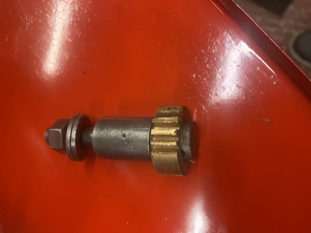

                                    The first picture contains what I assume to be the tumbler reverse gear – it has a strange brass cog on it with only 5 teeth – I assume this was a past project for the previous owner.
                                    Is there a gear chart for thread cutting and carriage speeds available ? I also liked to know what the spindle speeds would be – the motor is 1/4HP 1420rpm.img_6243.jpg

                                      The tumbler reverse gear is a separate assembly comprising, er, ?3 gears affixed to a 'carrier' bracket fitted to a pivot immediately below and slightly forward of the pinion on the end of the spindle – I think the models originally fitted with one had notches for the selector detent present on that curve on the end of the casting between the back of the spindle and the leadscrew bracket..
                                      ..the memory is treacherous here, I can't remember whether they are retro-fittable – further advice would be welcome, an end-on picture of the main casting below the spindle would be handy – I'll see what Tony G says…
                                      (Edit – I think having had more of a look that your model has the early type spindle-pinion 'collar' fixing and probably never had a T/reverse fitted – that doesn't necessarily mean that you can't fit one, just that I might not be the man to tell you how..).
                                      The brass item in the photo doesn't look like any part of the original equipment to me (however there are forum members who know more than I)..
                                      The speeds will depend on the ratio of the pulleys fitted to the motor and countershaft – a two-stage reduction is needed, I don't know if you have a countershaft, but one can't connect the motor and spindle directly without an intermediate set of pulleys..

                                        If the lathe has Tumbler Reverse, there will be lever, sticking towards the operator, immediately at the back of the Headstock, carrying two identical smallish gears. Moving the lever will engage either one with the pinion on the Mandrel, so that the drive to chagewheels is either direct, or through the second gear acting as an idler to reverse the direction of rotation of the rest of the gear train.
                                        So far, I haven't spotted it on your pictures.yet. Tumbler reverse was not standard, it was an optional extra.
                                        If you look at the Lathes UK website pages for the ML 1,2,3 and 4, you will see at least one illustration or picture of the arrangement
                                        The shaft and control lever for the Back Gear looks to be missing.
                                        The unfinished brass gear may be a nice ornament, ( Or W I P ) but of little practical use; except possibly to lock the changewheel train for some purpose. (Not chuck removal I hope! )

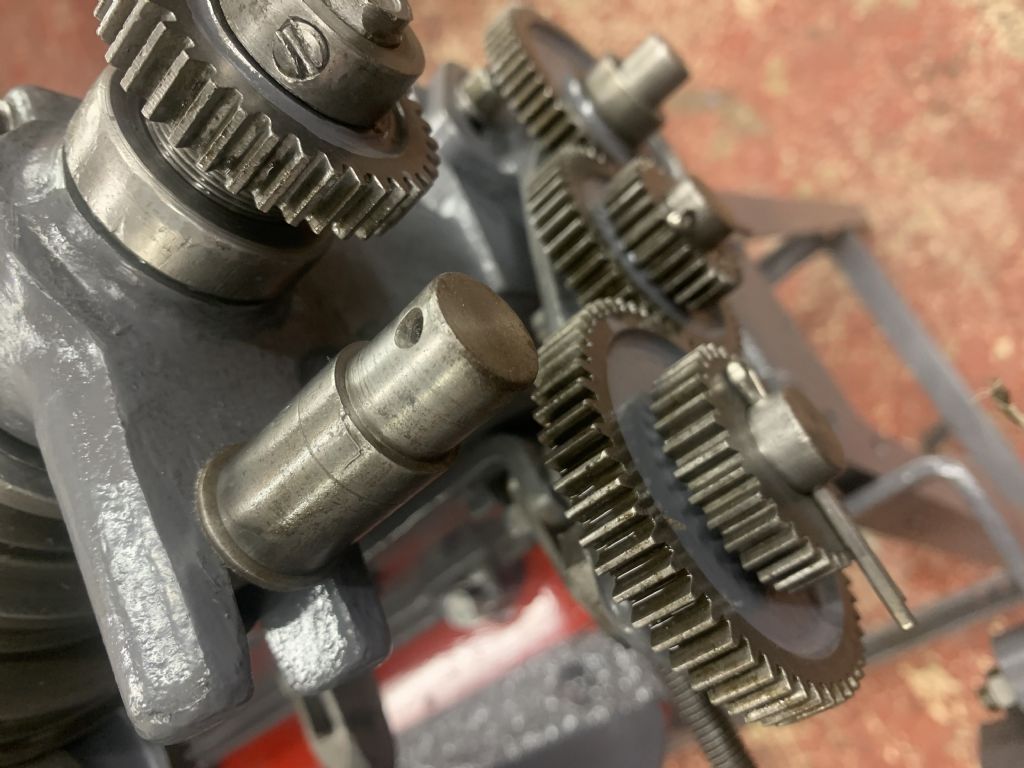

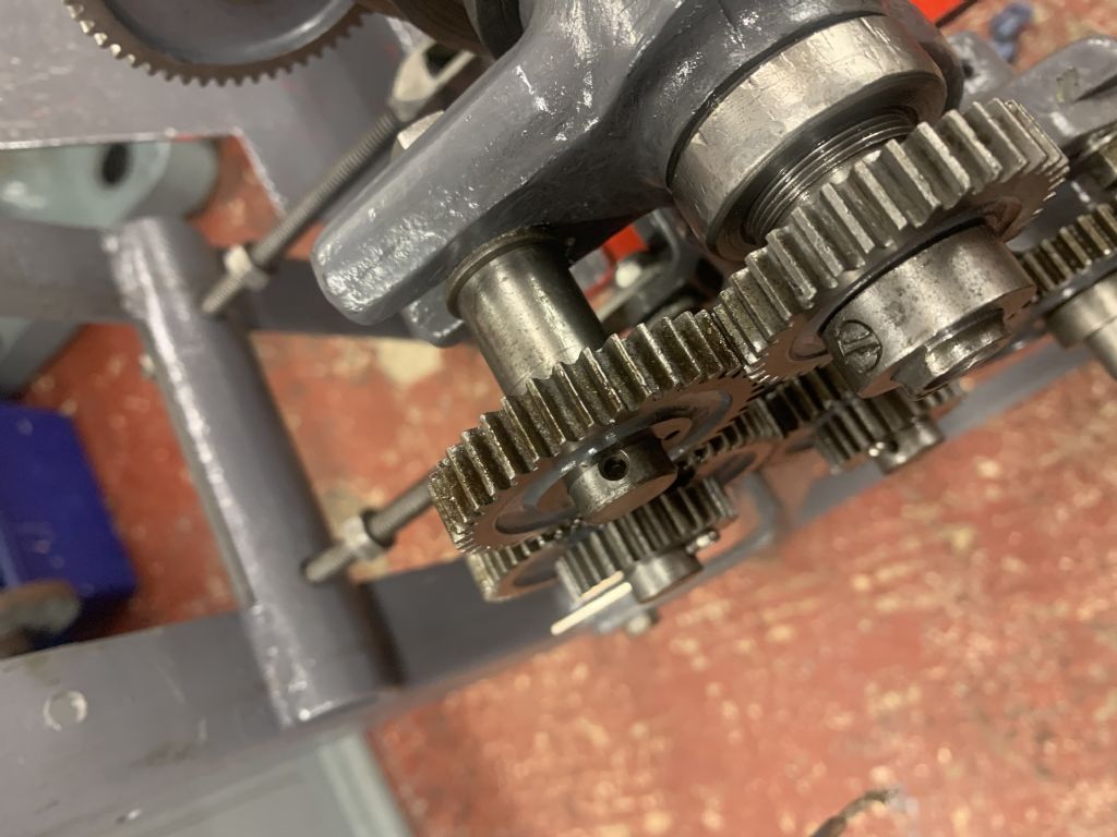

                                            For those that asked – here are some pictures of what I assume to be the reverse gear for the leadscrew.

                                              To answer that, are you able to list the tooth counts for all the change wheels that came with it. We know the leadscrew will be 8 tpi, that was the standard chosen by Myford in their very earliest days and maintained throughout their manufacturing history.
                                              As you have photographed the gear train set on the lathe at present, it is a simple chain with the only influential elements being the spindle gear and the leadscrew gear, the rest are merely idlers connecting these two and play no part in the calculation. Used as it it in that set up for screwcutting it is given by the ratio of the spindle gear tooth count, divided by the leadscrew tooth count multiplied by 0.125 [the pitch of the leadscrew]
                                              An as example and from observation, assuming the two gears to be 35T and 65T respectively, that calculation gives 35/65 x 0.125 = 0.0673 inches pitch which is 14.88 tpi; hardly useful but you see how it is worked out.

                                                Thanks Brian – very useful information there – I will count the teeth and post the results on here. I think I have a full set of gears about 10 in total.
                                                So put it simply – the gears used in between the spindle gear and the lead screw gear have no influence of the pitch of the thread, there only influence will be the speed in which they turn the lead screw
                                                All I need to know is the spindle gear and the lead screw gear ?

                                                Brian Wood
                                                  @brianwood45127
                                                  No.
                                                  The intermediate gears have no effect at all on the pitch or shaft speed, any more than a fabric belt linking two pulleys does. They merely transit the drive between the spindle gear and whatever gear is fitted to the leadscrew. An odd number of linking gears will preserve the rotation direction, that is the only effect.

                                                    The gear shown in your pictures meshing with the gear on the mandrel is where the back Gear and shaft should be.
                                                    Study the Lathes UK pages that cover the Myford ML1, 2, 3, and 4. You will learn a lot from them..
                                                    The purpose of the Back Gear is to slow the speed of the mandrel.
                                                    It does this by moving into mesh with the gear at the rear of the mandrel.  The drive passes through the larger gear along the shaft to a smaller gear which meshes, when engaged with the gear on the Mandrel, just behind the bearing behind the chuck.
                                                    The Back Gear is engaged by a lever which rotates an eccentric bush causing the shaft to move so that the gears mesh with those on the Mandrel. In one of the grooves of the belt pulley there is a grubscrew, which under NON Back Gear use, locks the Pulley to the mandrel. When Back Gear is engaged, this grubscrew must be slackened, (preferably removed and put in a safe place until required again )
                                                    Failure to release / remove the grubscrew will lock everything, since you are effectively trying to drive through two different ratios. And that can't happen!.
                                                    Engaging Back Gear will reduce the Mandrel speed to about a sixth of the normal value.
                                                    Normally, the Changewheels will range from 20T to 65T, incrementing by 5T.
                                                    Having three 20T , and an extra 60T will enable you to set up a train giving a fine feed. 20: 60 / 2 : 65/20 : 60.
                                                    This should give a feed rate of 0.0043" per revolution of the chuck.
                                                    For screwcutting, if and when you choose to do that, you will have to set up a gear train to give the correct ratio between the Leadscrew and Mandrel to give the pitch that you want.
                                                    Brian Wood will the man to advise on how to go about this. (He has written a book about it! )
                                                    The pre Series 7 MLs had a few peculiarities, by more modern standards..
                                                    Because there was no Idler in the Apron between the Handwheel and the Pinion engaging with the Rack. Turning the Handwheel clockwise moves the Saddle TOWARDS the chuck, not away from it.
                                                    Also, to provide a power feed TOWARDS the chuck, two stages of reduction, or one and an Idler, are required (The Leadscxrew is 8 tpi, but Right Hand, rather than the Left Hand to which we are most accustomed. Hence the need for an idler, second Compound gear to ensure that the Leadscrew rotates in the correct direction.
                                                    Gears are compounded by linking them with 3/32" pins, in the same way that the Mandrel drives the first gear, and the t final gear drives the leadscrew.
                                                    The Cross Slide and Top Slide Leadscrews are 12 tpi, so each of the 80 divisions on the Handwheels are not exactly 0.001" (0.0010416667" according to my calculator ).
                                                    In M E W 310 there was an article on recommissioning a Myford ML4 which you may find helpful.

                                                      If extra changewheels cannot be obtained from somewhere for the ML 1,2, 3, or 4, gears for the 7 Series will fit. They are the same bore and width, but will need to be drilled to take the 3/32 driving pin
                                                      The technique means modifying one of the existing gears, by drilling the hole right through so that it can be used as jig to drill a hole into the "new" gears, when existing and "new" gears are mounted on one of the studs..
                                                      (The article in MEW 310 describes this method )
                                                      7 Series wheels are driven and compounded by a key and keyway, rather than the driving pins used on your machine…
