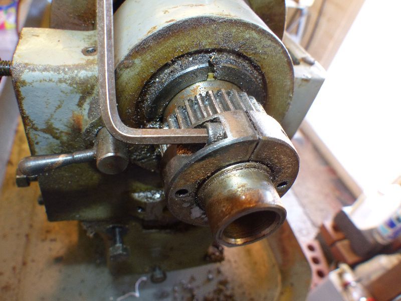

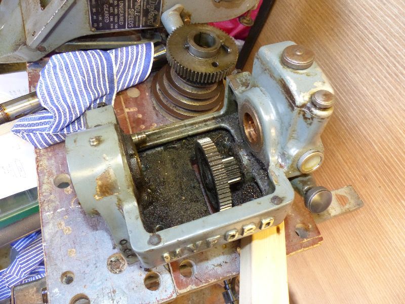

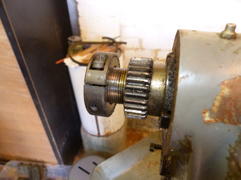

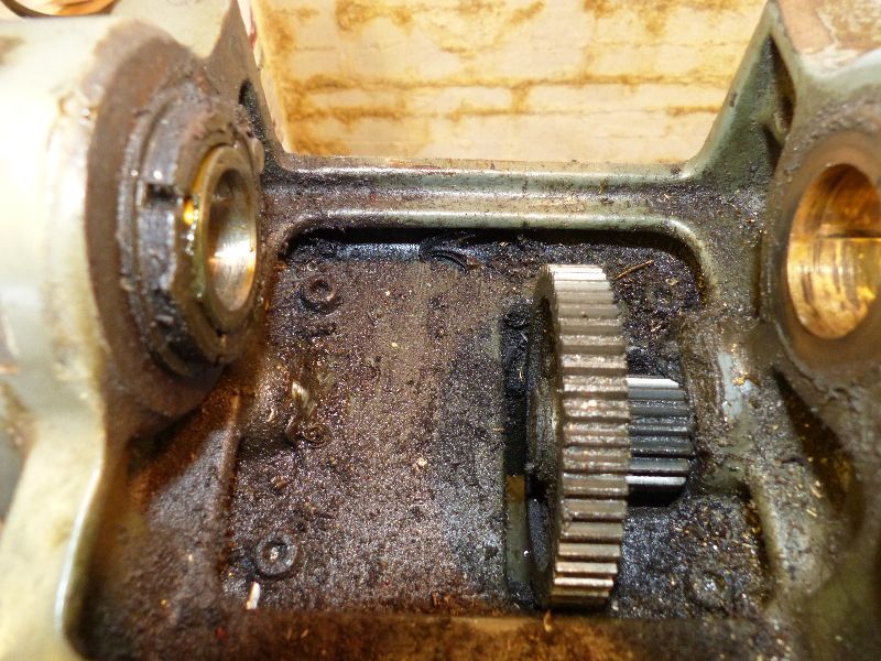

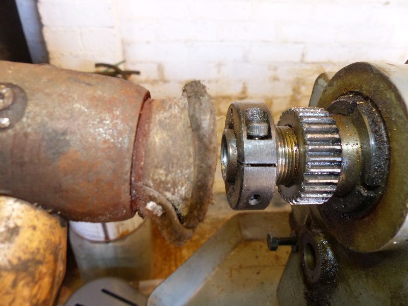

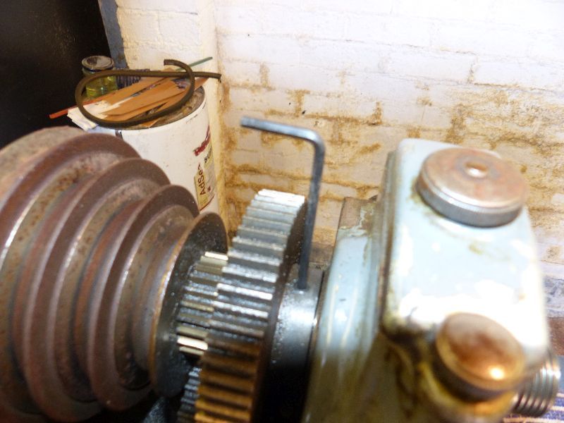

      Ah, yes, time to get the headstock off:-
      Loosen capscrew on locking collar and remove, undo grubscrew in back gear and drift out quill to the right ( must get some new heads on My mallet, only had it 40 years……….
      (Don't forget to catch the Woodruff keys…..)
      60 Years of crud in there, but managed to find the 4 capscrews and remove them ( very tight! ), and lift the headstock clear:-

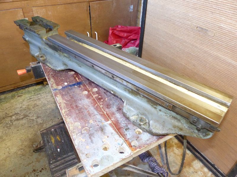

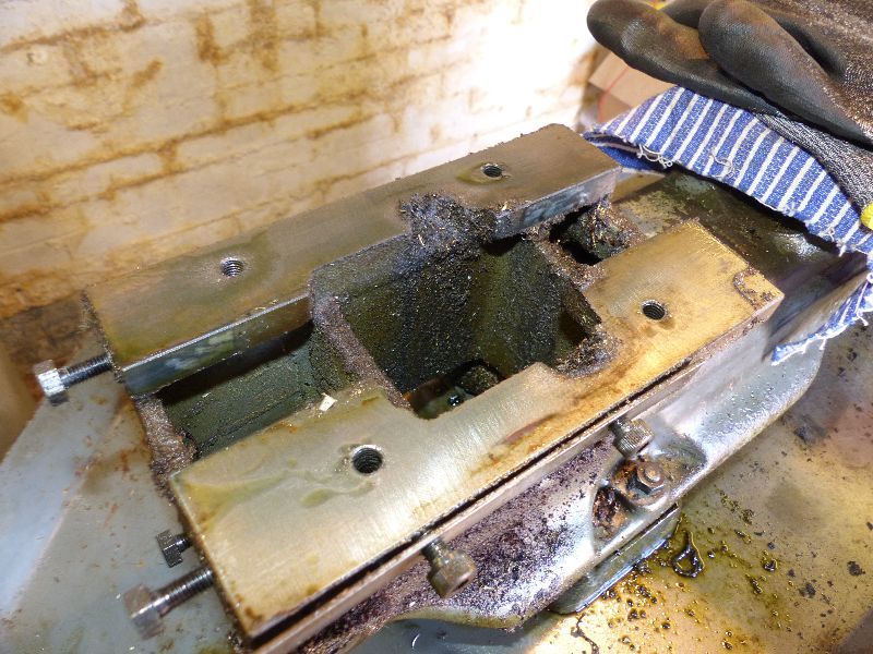

      Bed wiped down for inspection and carefully lifted off and put to one side:-
      A few 'manual' parting off marks on the top off bed but I have seen worse!
      Wear variation measurements as follows (taken at 5 points along bed):-
      1:- Total width across both bedways- 0.011 mm
      2:- Horizontal width of rear bedway- 0.080 mm
      3:- Horizontal width of front bedway- 0.006 mm
      4:- Depth of vertical shear front of front bedway- 0.087 mm
      5:- Depth of vertical shear rear of front beadway- 0.214 mm
      6:- Depth of vertical shear front of rear bedway- 0.164 mm
      7:- Depth of vertical shear rear of rear bedway- 0.064 mm
      I am reading this as the worst wear is on the 2 inside vertical shears.
      Not being very knowledgeable about these matters, could somebody set Me on the right track here as to whether the bed is in need of a regind or is it servicable?
      (I'm not sure if all the above measurements are required, opinions vary, so I took them all anyway!

                          Hi Pete
                          If you search the MEW index for the series of articles by Pete Barker over the past year or so, you will find a lot more information on Myford bed wear, wide guide, bearings etc etc if you can get back issues or a digital sub.
                          In a nutshell, old Myford literature on their former reconditioning service recommends a bed regrind if wear exceeds .003" (note, inches not mm) measured in the horizontal plane (ie measuring wear on the vertical surface of the shear) and .005" in the vertical plane. But you could probably get away with a bit more if you are not doing micron-level work.
                          There is an easier alternative to the Radford and Ganderton methods that does not require a milling machine. It is outlined in the MEW articles. Basically add a strip of gauge plate to the rear carriage surface so it contacts the bed's unworn rear shear. Then just leave the old narrow guide surface as is, sitting a good 20 or 30 thou away from contacting the shear. No need to do the Radford thing and have two contacting surfaces. The factory never did that. They just went (in 1972) to using the rear surface only.
                          The surface of the carriage that runs on the top of the bed ways can then be touched up with a file and a small scraper made from a file. All detailed in the MEW articles. No need for a milling machine at all.
                          Looks like you have a lot of wear on the inner vertical shear surfaces. This can also be remedied as outlined in the articles by adding a cutting tool to a vertical slide mounted on the carriage and running it back and forth like a hand-powered shaper. Sounds crude but it has produced an excellent result and a lathe that turns dead true between centres, where the tailstock relies on these surfaces for alignment. So is is well worth doing.
                          Your measurements posted earlier seemed a little odd in that the vertical depth of the front shear varied so much from front to back. Not sure what is going on there? Depends where the wear is. Could be tailstock caused wear, or if it is in the usual high wear patch about six inches from the left end of the bed ways, it's from the carriage. Could be a bit excessive for fine work if that is the case. Might pay to measure carefully again and do an assessment.
                          Have fun with your rebuild. It's very satisfying to be able to do precision work on a machine you have rebuilt yourself.
                          Pete B.
