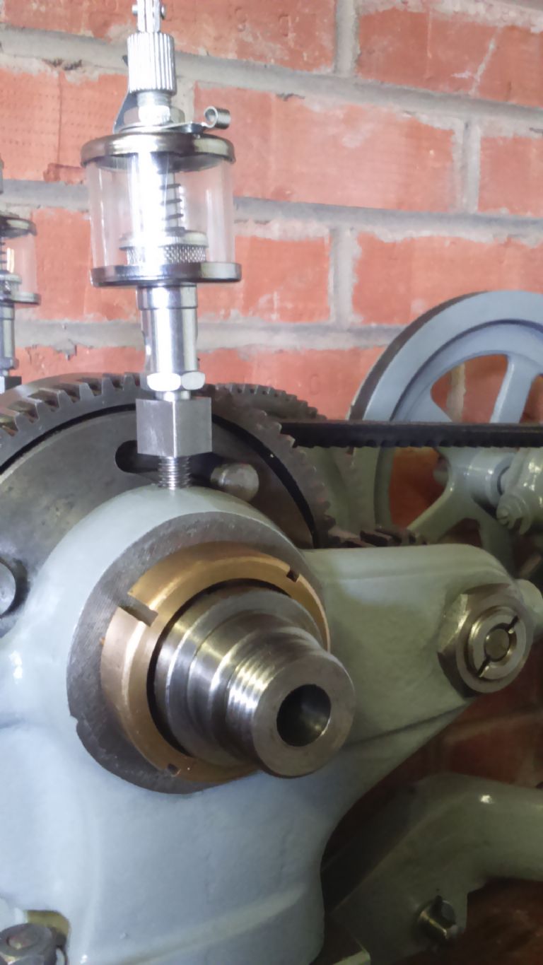

I definitely have a missing oiler on the front end of the headstock and my understanding is that since this also serves to lock the bearing and spread it slightly, simply dropping oil down the hole is not a suitable substitute. Any ideas on where to find a suitable oiler or, better still, to find a drip oiler? I can get simple oil cups from RDG but don't actually know what the thread is?

From memory the oiler bolt is about 5/16 BSW, with the end machined to a point that fits into the bearing wedge. Bolt has a square head and a hole through the middle for the oil. I made adaptors and soldered them onto mine so I could screw drip oilers into the adaptor.
The C spanner fits onto the slots machined around the circumfrence of the round bronze rings that screw on to the front of the bearing.

The oiler appears to be more of an issue than I first thought. I can't see any sign of anything down the chuck end hole, suggesting that something has rotated in there. It is still free and smooth so hopefully not too much damage, but it does mean I now need to work out how to dismantle the headstock far enough to see what's going on.

The lubrication bolt drawing.
If the bolt is missing the bearing may hsve spun and you will need to check if the wedge is still there as well.
Do not overtighten the bronze bearing nut as you can strip the threads and they are not easy to replace. You will have to remove the gear cover on the rear of the spindle to get at the bronze nut there probably and watch out for spacer on screw holding cover plate on.

I do still have the 'Catch 22' of needing a front lubricator bolt to run the lathe, but needing the lathe to make the bolt. I think a quick conversion of a standard BSW bolt by drilling a hole up the centre on the pillar drill and creating a good approximation to the cone angle by spinning against the grinder should suffice to get it running and then I can make the proper part, although that will be a bit interesting as I will have to use the catch plate and I haven't tried one of those before.

Your plan with the oiler screw sounds good. Should get you going. There is a small wedge that the screw bears on and sits in the slot in the bearing. It has an oil hole through it from memory.

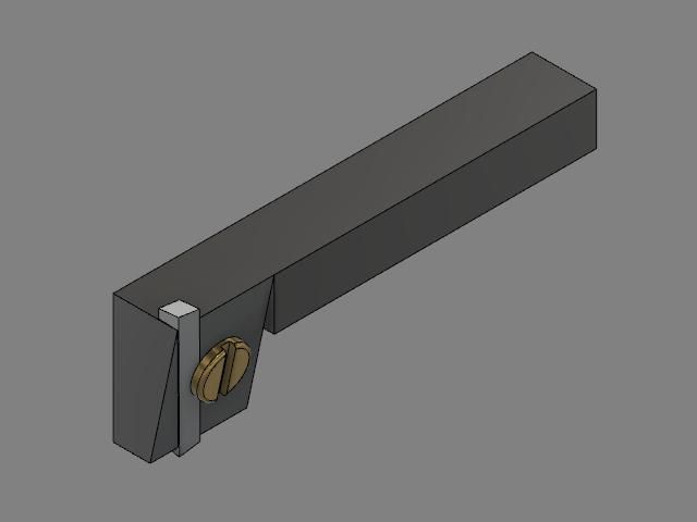

If you can access earlier Issues of MEW, two designs for shop made Tangential Turning Tools have been published.
The first design was to take 1/8" toolbits. (I made up a lookalike for 5/16" and it works like a dream. )
Having a square shank, it involved milling at compound angles (Not impossible to file by hand, if you are careful ) And am not sure that all the angles are terribly critical
The second version made life easier, in some respects, because it entailed milling the 12 degree angle onto the shank, to change it from square to trapezoidal.
The jig for grinding to sharpen, is simple to make.
The Eccentric Engineering version uses a 33 degree angle rather than the 30 degrees shown for the sharpening jig in the MEW articles.
Once made, the advantage is (Apart from the fact that it performs well ) that there is only one face to grind.
