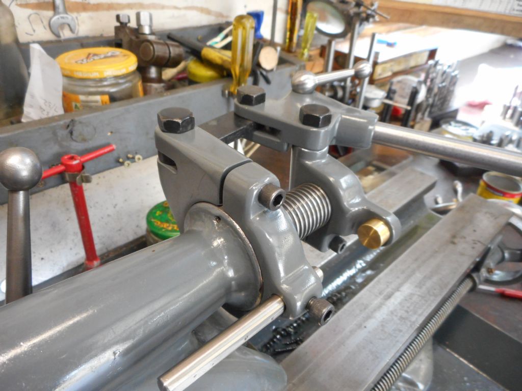

Finally got out in the shed for an hour today and put it all together and actually drilled some holes. Result! And very nicely it works too. I like it particularly for centre drilling. Makes "pecking" much quicker and easier so you can bang it in pretty quickly and whip it out if it starts to complain. Likewise, very nice for small drills, although have not gone smaller than 1/16" at this stage. . Gives a good "feel" with the handle fully extended. I had thought half extended might be better for small drills, but seems the other way round. Longer handle gives more force with less effort, but more sensitive feel. ,
Also really good for drilling a 1/4" hole a couple inches deep. Again the rapid "pecking" motion is much easier and quicker than with the handwheel. And it smashed a 13/16" (that's about 20.6mm) drill bit through there like it was butter.
The half-inch diameter handle seemed to stand up well with a tiny bit of flex, but less than the handles on my drill press so I am happy with that. Glad I made the sliding version though. Nice to tuck it out the way when not in use.
The whole contraption looks like it has always been on there and not like some homemade afterthought, which was exactly the desired result. Very pleased I made the extra effort. It was worth it — in the end! But I may take a little break before starting on the small sensitive drilling attachment from the 1929 drawings.

PS. Notice that shiny little brass button there? That is perhaps proof that a good tradesman is not necessarily the one who does the perfect job every time, but knows how to cover up his clangers when he drops them. When I changed from the Plan A of the earlier threaded rod type of depth stop, and went instead with that later-type plain bar and small lock screw, I was left with an unwanted 1/4" UNC threaded hole already in the quill clamp. It looked rather lonely sitting there by itself for no good reason. So the piece of brass was turned down on one end and threaded and screwed into the hole. "Softens the impact of the stop without damaging the casting, sir. All the better ones do it."

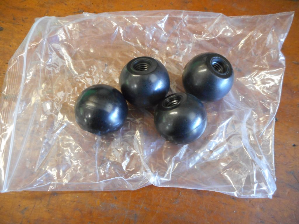

And look at that little ball handle in the last pic. Absolutely gorgeous. The cherry on top.
