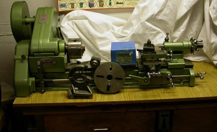

      A co worker has a Myford lathe and accessories he wants to sell, in the Toronto Canada area.
      The only ID he has for the machine is a mark on the base VL159910. Can the Myford exerts here identify the machine model and year from this mark? The gentleman was the original owner of the machine but through advancing years and onset of memory loss does not have the purchase paperwork, manual, or memory of the model. My hunch is that it was bought in late 1960's early 1970's.
      We will also need to establish approximate value of the machine once it is identified. It is in very good condition, it has been in the living space of the house since bought new, and has been used to make a few bushings and turned parts for antique engine restoration. Not more than 40 hr total use since new, and literally no wear. He will not ship the machine, buyer collection only. He can not help lift the machine up the stairs.
      Any help with ID appreciated.

          V159910 would be an ML10 or Speed10 from 1985-1988 according to the Myford Website. https://www.myford.co.uk/acatalog/Serial_Numbers.html

              Sorry guys hopefully a pic is now attached – not sure why it didn't attach earlier.
              VL159910 is the number on the lathe.

                Myford ML10, looks like the long bed model in great condition.

                        I would of thought a nice ML10 long bed c/w 3 jaw chuck, tail stock chuck, fixed steady & face plate ( cant see what is in the blue box sat on the bed ) should be around £1400 – £1500. As an example they have a nice Myford Speed 10 with just a 3 jaw chuck for £1575 + Vat ( £1890 ) @ Home & Workshop Machinery.

                          You appear to have shown a nice lathe with accessories and the price realised will be for that.
                          The steadies are quite rare and go for silly money, so you might realise about the same for the lathe with just the accessories but without the steady which would go for a lot of money on its own.

                            Thanks Martin and Nick. Just FYI The blue box in the pic contains a 4 jaw chuck, which I don't think was ever used. Still has anti-corrosion preservative oil on it! Good to know about the steady's value Nick.

                                A lot of ML10 fix steadies can go for around £230 but there is also one on Ebay for £160 at the moment. A new 4 jaw chuck will also push the price higher.
