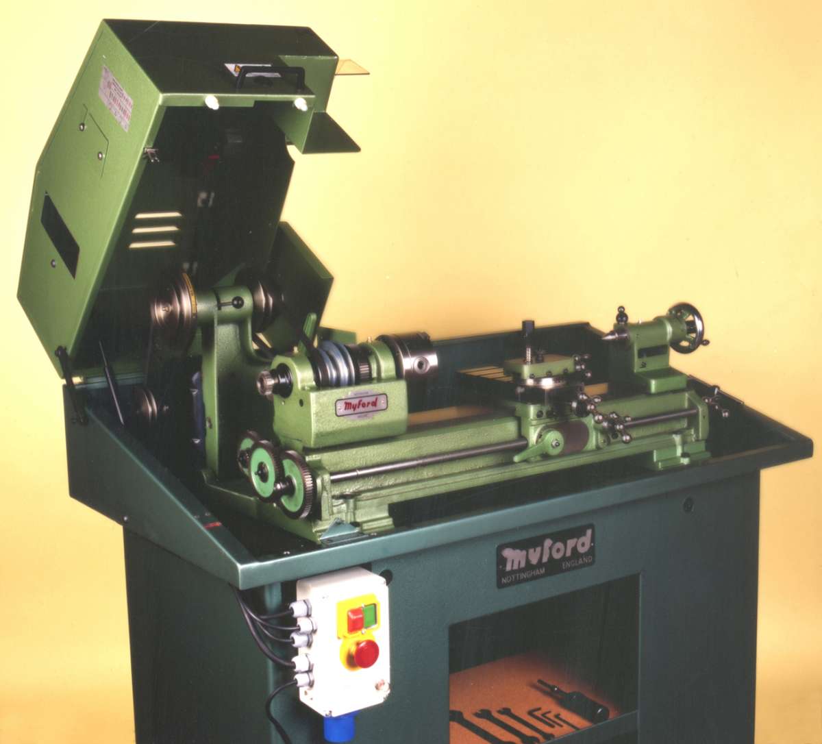

      Looking for advice for my first lathe I live in Northern Ireland were lathes are few and far between, I know were there is a Myford euro 10 lathe as new the person is looking for £1400 is this to high as it does not come with any tools just a steady rest.

        Seems to  be a rare beast:
        http://www.lathes.co.uk/myfordml10/page3.html
        If it looks like the picture and has the 3 jaw chuck and all the change wheels then I think you would a have a good lathe for the money

          Not sure about change wheels but does have quick change tool post, as far as I know it has never been used

              Just a thought but how does the drive from the spindle get to the change wheels ? There is no obvious gear train, is this screw cutting or simply power feed from a belt ? Noel
                The banjo with the gear train needs to be swung up to mesh with the pinion on the end of the spindle.

                  One issue I can see with the lathe is that the way the cover opens means you can’t place it up against a wall. This could result in a lot of wasted space in a small workshop.

                    Just take the cover off

                      Taking the cover off the lathe leaves it in a dangerous state. The belt and gear covers normally fitted to a ML 10 have been removed from the Euro 10.
                      Suggesting removing or disabling safety devices is irresponsible.
