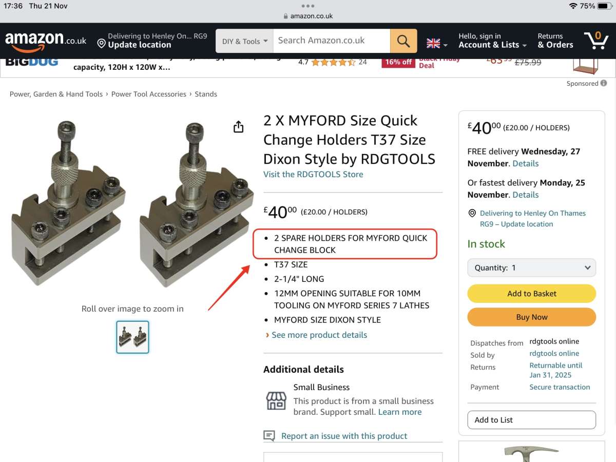

                        #765827
                          On SillyOldDuffer Said:
                          […] Another is to buy from a seller like Myford, who maintain consistency over time.   But their holders are on the pricey side, making it oh so tempting to look for cheaper on the web…
                          This is a delicate matter, and I will not be surprised if my post is deleted by the Moderators … but here goes:
                          ’cheaper on the web’ was in this case a purchase from RDG
                          I believe it is common knowledge [it certainly should be] that although RDG and Myford are separate Companies, some individuals are involved in both.
                          I have no idea what, if any, inter-company trading occurs; but it is tempting to think that some items are ‘made’ by RDG and the best of those are selected to become Myford items. … I hasten to add that there would be nothing inappropriate or unreasonable in this !
                          #765835
                            Two different tool posts Michael so not a case of picking the ones that come in on spec and badging as Myford.
                            The Myford one would be about double the price of the RDG once you figure in the additional holders as the Myford only comes with two compared to the four with the RDG.
                            Also if you look closely at the tool holders you can see that they are machined differently on the mounting faces so off a different production line.
                            #765867
                              Apologies for my misunderstanding, Jason.
                              … I regret the subtlety of the Amazon listing must be lost on me 🙁

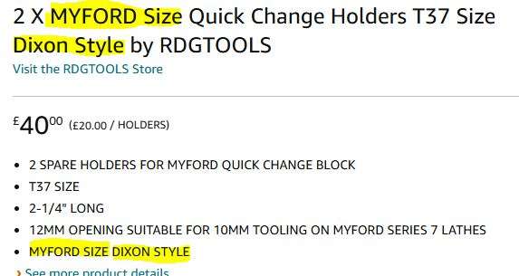

                                    It was simply a screenshot of the Amazon page linked by the OP, with the following words ringed in Red, and an arrow pointing to them:
                                    2 SPARE HOLDERS FOR MYFORD QUICK CHANGE BLOCK
                                    #765901
                                      outweighed 2:1 by “Myford size” and “Dixon style” Not even DICKSON

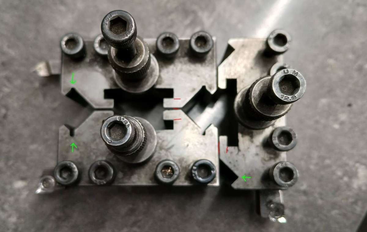

                                                  As this thread has come up again I took the photo I mentioned several posts back.
                                                  On the right is an original “W” marked tool holder, on the left two differently sourced similar style holders.
                                                  Dickson
                                                  The green shows the obvious differences which would seem to indicate that each has been made on a different production line in a different factory so unlikely that cheaper ones are just rejects that do not meet the standards of the best ones which get sold at a premium with a premium name on them.
                                                  The red indicates where I have found the problem of fit is. The original is quite a bit thinner. Some of the similar style I have been able to thin the surface where the two are touching on a belt sander as that surface touched the post before the clamp was tight. Others have needed a woodruff cutter to get into the back as the piston would not extend out enough to allow them to fit. But all are usable and as the last lot cost me £50 for 4 that is a lot better than Bison or similar prices.
                                                  The original is also a couple of MM shorter which does give a wider adjustment range so touching on Nigel’s comments don’t make use of the established suppliers who publish the tool post sizes and then go and buy “the same” cheap one from elsewhere as it is unlikely to be the same. Also if shoping for additional holders visit the supplier or a show and take your post with you to test the fit.
                                                  It would also seem that Pratt Bernerd have the “Dickson” name and use it on their version, although they don’t do the small myford size the prices of what they do make are considerable.

                                                    I have one holder for my Boxford Dickson toolpost that is thicker than the others in the area Jason highlighted. However, it fits the toolpost OK, and I only noticed when I 3D-printed some holders, and it wouldn’t fit on them. No idea who the supplier was as it came with the lathe.
                                                    Rob
