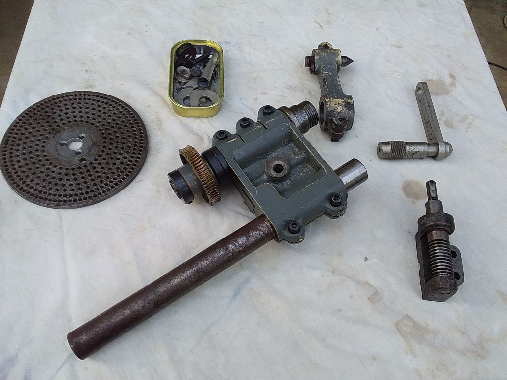

        Well a big surprise and a definite turnaround for the books this morning. After leaving the vertical slide soaking in my parts washer tank overnight, with a very minimal bit of scrubbing with a small wire brush, most of the "rust" has disappeared. It seems most of it was a thick hard layer of congealed oil/grease mixed with dirt. These bits came from out in the red dirt farming country, where the soil gets its colour from the iron oxide/iron ore it contains. So I am guessing they were well oiled up a million years ago and then left out in the open in the typical farmer's open sided shed with (red) dirt floor and the dust blowing in 24/7.
        It came up looking a treat. 95 per cent clean metal after the gunge was gone. So a minor polish up with some Scotchbrite and steel wool and it will be almost as good as new. Woohoo!
        The dividing head looks to be in similar shape. It is taking a bath in the parts washer tank tonight. It has some rust etching on the index plate but the rest is not too bad. The tailstock overarm is rusted, as is the spindle register. But I got the spindle to turn, sluggishly so left it to soak. The parts washer fluid is probably a good penetrating oil, being a mix of degreasing solvent and the old oil washed off many previous engine and lathe parts. It is some nasty stuff. But I am so glad I bought these bits now. Definitely much better than they looked.
        And I reckon I can make an adaptor to use my GH Thomas dividing head's indexing plates on this dividing head as the hole in the middle of the GHT version is bigger than the Myford one, so an adaptor could be made I reckon. Save me from drilling another 800 holes to make the 3 missing plates. Both are 60T worm wheels so the hole circles will relate.

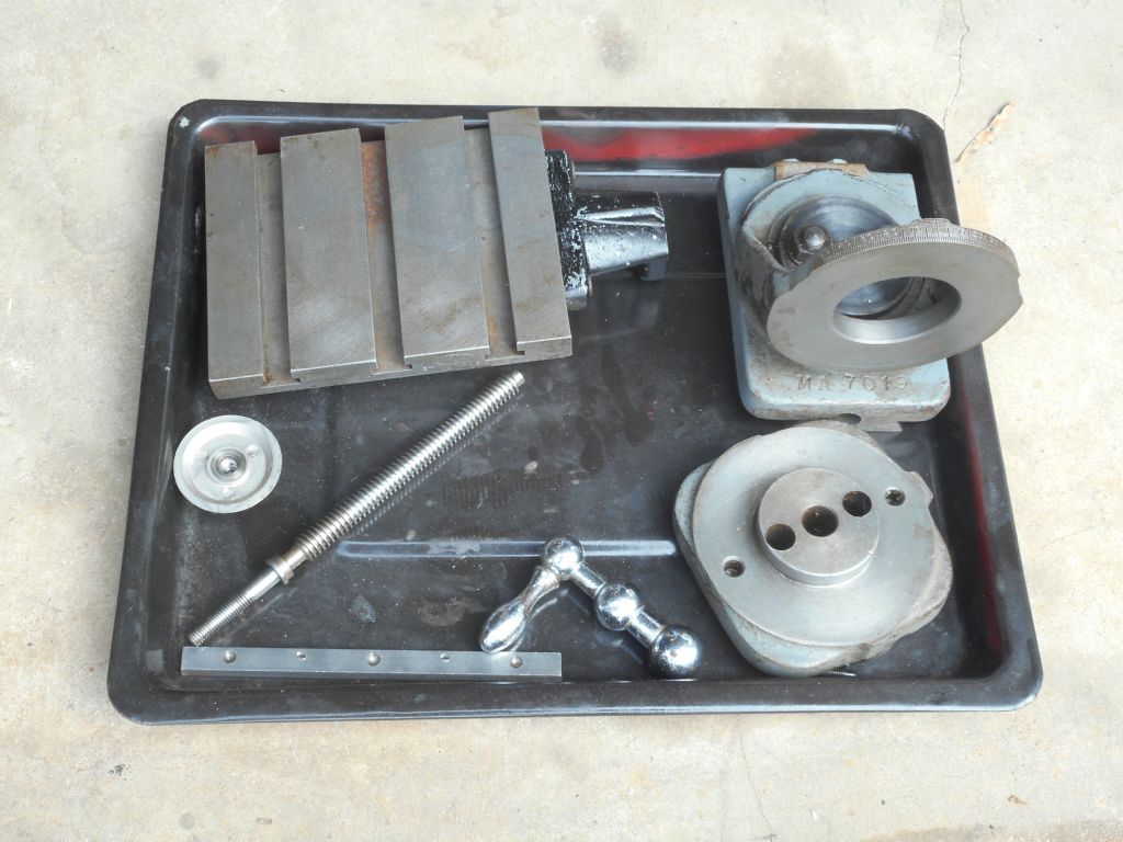

                    Out of the soup and into the daylight. And the dividing head looks pretty good too. Not as pristine as the vertical slide but amazingly good considering how it looked on the surface. Most important, the msomain spindle and worm and worm wheel are all good. Bit of rust on the spindle nose but fixable.
                    I got some Evaporust at a more reasonable price so I have the tailstock overarm soaking in it overnight, and the index plate. As I bought only 1 litre ($25) there is not enough to fill a soaking bath so I slathered it on the overarm bar and put it in a plastic bag rolled up so it can soak in that overnight. The index plate I just brushed some on and left it sit there. So will see tomorrow how they compare.

                                  Well I am undecided on the Evaporust so far. Having only 1 litre I could not really immerse things in it overnight,and it seems to evaporate away if just brushed on and left sitting out. So I hatched a cunning plan and brushed some on the index plate and the overarm then put each one in a plastic bag with a glug (technical term) of extra Evaporust so the parts would stay immersed overnight, sort of. But every plastic bag seemed to have a hole in it and it ended up the sections that were on the bottom in what was left of the liquid derusted OK-ish but the top bits above the tidemark not so much.
                                  Please let me know if you can't see the picture. I am experimenting with using Imgur pic hosting and it is a bit experimental at this stage.
                                  But still looking way better than when it lobbed on my doorstep seeking succour.
                                  So I doused various other bits today and wrapped them in plastic bags today. Checking progress just after dinner, the spindle nose has come up nice and rust free, but a matt silver finish all over that will still need a final polishon the wire buffing wheel.
                                  So I am not totally convinced that the process is any less faff than my usual wire buffing wheel on the 8" bench grinder outside. Advantage may be that with things like the spindle nose register and overarm, the rust is offed with out removing any unnecessary parent metal, thus maintaining dimensional integrity as much as possible. I could have just spun the overarm in the lathe and emery-clothed it, but that would take a thou or two off the diameter and affect the alignment by that tiny and possibly not critical amount. But still, nice to keep it to factory specs if possible on precision parts. I think a very light buff on the wire wheel to finish it up will not make a measureable difference. (Not measureable with my shaky hands and dodgy eyesight anyway!)
                                  Will see how it shapes up in the morning and report back.
                                  ONe thing I did learn is don't use black plastic garbage sacks for this process. They make black stains on the job, which hopefully the Evaporust will have removed by morning since I discarded the black bag.

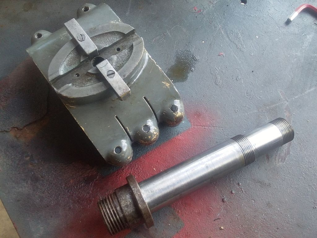

                                    If the worst comes to the worst you could replace the overarm with a chunk of silver steel – I think it's a standard diameter?
                                    #630455
                                    Hopper
                                      @hopper
                                      Posted by John Haine on 21/01/2023 11:27:01:
                                      Yes. I haven't measured it but it looks like 1" bar. I think it will come up useable though. Good enough for what I am likely to use it for. According to Myford it is not for mounting jobs between centres but on a stub mandrel held in collets at one end and the tailstock centre just lending a bit of extra support at the other.

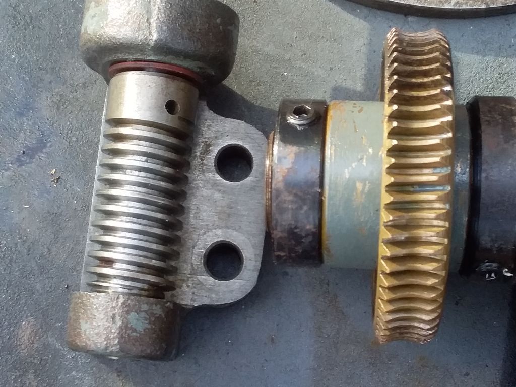

                                        An interesting aside on the Myford dividing head. GH Thomas has a chapter on it with a few good tips, of course, in Workshop Techniques. But I did notice that while the Myford DH uses a total of four indexing plates with 7 or 8 hole circles in each, the GH Thomas Versatile DH achieves the same result with only three much smaller plates with far fewer circles and smaller numbers of holes. Still gives every division up to 100 and many more beyond, including the mystical 127. So, according to Occam's Razor, old GHT's solution is the most elegant. Cunning old dog he was. Left the men at Myford in the shade.
                                        So I can make up an adaptor ring and just use my set of VDH indexing plates on the Myford unit and use GHT's charts. Brilliant! No need to cut out discs and drill 800 or more tiny holes!

                                              You might drop lucky and find a scrap hydraulic ram. Chrome plated and ground

                                                      Yes i think I will stick with the original British made overarm, warts and all, but at least it is round. And see following pics, it has come up pretty good after the Evaporust treatment. Cheap Chinese and Indian junk is the bane of my existence. Old bike parts that fail are pretty much the norm, not the exception. Just fitted an allegedly Taiwanese made folding kickstarter to one of my Harleys and it bent on the third kick. Very obviously a malleable casting, not a drop forged alloy steel unit like the HD original, which was indestuctable and you could bet your life on it, let alone your right knee joint.
