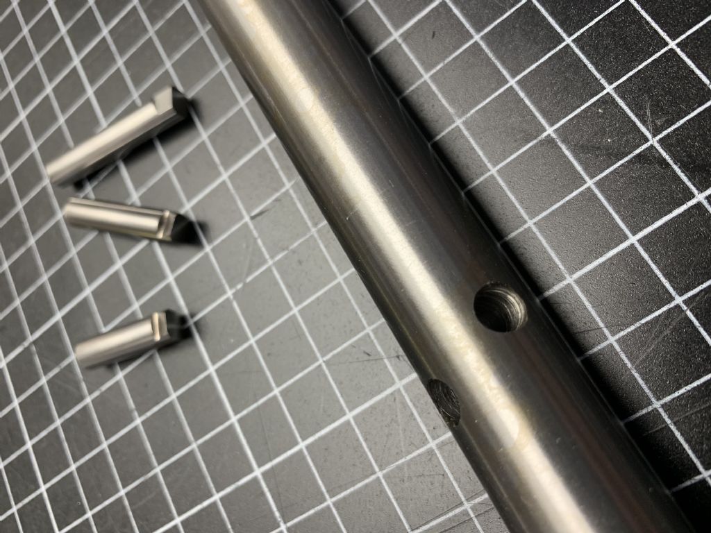

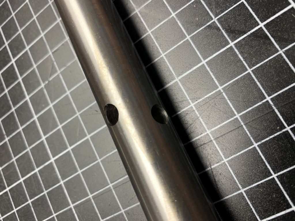

      Gents,
      I recently bought a boring bar from Myford. It runs between centres and I was planning to bore the cylinder on our Stuart steam engine with it. It comes with some tiny cutters but I am not sure how it works. The bar itself has 2 holes drilled (both smooth, no threads in either) and these 2 holes are perpendicular to each other. The cutters fit very nicely in the holes with no discernable play but slide in and out without much effort.
      My question is how are the cutters fixed in the bar?
      Mark

          Usually the holes would intersect, and one of them would be tapped for a grubscrew. That is how it works on the ones I have inherited and made anyway.

            Sounds defective but is there an axial push rod that secures the cutter?

              Hi yes the cutter is clamped by a grub screw in the other hole which overlaps the cutter hole. You can set the cutter diameter by using a dial test indicator datum set on the boring bar and winding out the difference to set the bore diameter.

                  The 2 holes should just intersect each other .
                  One of those pieces of tool steel should then have a flat on the side.
                  This is used to act as a wedge against the cutting tool in the adjacent hole !
                  I have one the same and don't really like it as i find it difficult to adjust finely, its much easier to adjust and clamp with a couple of screws

                      TB is right. I have one of these and one hole holds the cutter while the other has piece that is flatted on one side in a slight taper. The cutter is wedged in place quite firmly but adjustment is tricky.

                                          Is the wedge in fact a taper pin and does it project from the bar? If so, this seems another disadvantage to this design as it will constrain the projection of the cutter – the bit that matters!

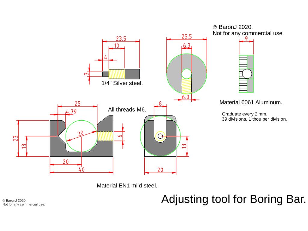

                                                  I can't remember if it's Sparey or Mason but the practice employed for setting the Myford Boring bar is to use a micrometer set to measure half the required bore and half the boring bar shaft diameter. I've found it is possible to gently tap the wedge piece to let go of the cutter slightly, then tap the cutter to the right position before re-wedging it tightly. The measurement is taken from the cutting tip of the cutter to opposite side of the bar. Not the most convenient set up but inexpensive.

                                                    John Baron
                                                      @johnbaron31275
                                                      Hi Guys,
                                                      This is a drawing of mine ! I made it to specifically adjust the cutter. The nice thing is that once used its easy to set the cutter to increase the depth accurately.
                                                      It was designed for a upto 20 mm diameter boring bar. It works quite well on a smaller diameter bar as well. Otherwise just adjust dimensions to suit your bar.
