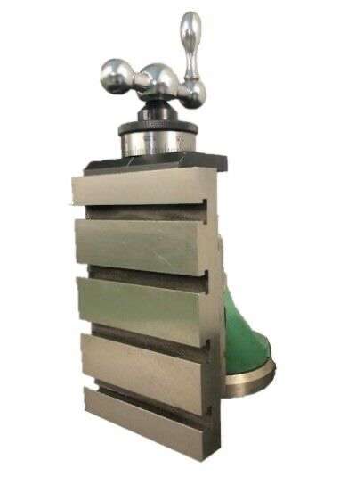

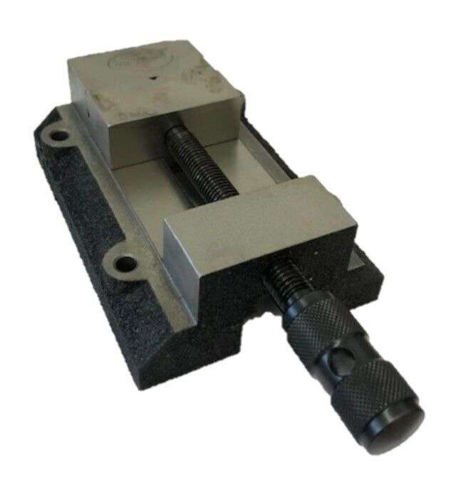

      Hi, I am thinking of adding the latest Myford vice & the larger 4-slot adjustable vertical slide. It is an expensive option & there is a case for sourcing a second-hand bench top vertical mill. However I have found that improving/renovating/upgrading my Super-7 to be a satisfactory and enjoyable route….
      Does anyone have any positive/negative experience with these parts??
      TIA Image 1Image

        Years ago I bought a myford vertical slide second hand and the bracket isn’t square to the base.

                  I’d put the money towards a proper mill. More rigid, bigger clamping area, bigger travel, easier to set up, etc
                  I’m not sure how useful the longer 4 slot one will be as you run a greater risk of the bottom of the table hitting the bed so travel may not be any more than the 3 slot

                      Another vote for putting the money into a real milling machine.
                      Milling slides on lathes are very limited in comparison with a real mill; nowhere near as rigid and they only provide a tiny work space.   Good work is possible, but slides take ages to set-up, and are then only able to take light cuts over short distances. Frustrating.  On a very good day I scored mine no better than ³⁄₁₀.
                      Slides were popular back when it was almost impossible for amateurs to own a real mill.  Today, we can, and should!  In many workshops I suspect a mill is more useful than a lathe.  Certainly wonderful to own both.
                      Not having enough room for a milling machine is the only good reason I can think of for owning a lathe slide.

                        I only use mine with a seperate spindle to cut clock wheel teeth.
                        Did try using it for milling one but it’s not very rigid and would advise the same as others, use the money towards a milling machine. It would be much more versatile and useful.

                                Round column mills have their limitations, but are a lot better than vertical slide, and tend to be cheaper. I had a Naerok for years, good substantial machine.

                                        IME, a vertical slide is a lot less rigid that a proper mill, and has smaller travels in all three planes.
                                        Having found thewir limitations, (Two different ones on different lathes), MANY years ago I bought a basic mill.
                                        The round column can be a nuisance, but dovetail columns weren’t available them.
                                        Now that would be my choice.  IMO, well worth any extra outlay for the benefits of a more rigid a machine capable of larger work.
