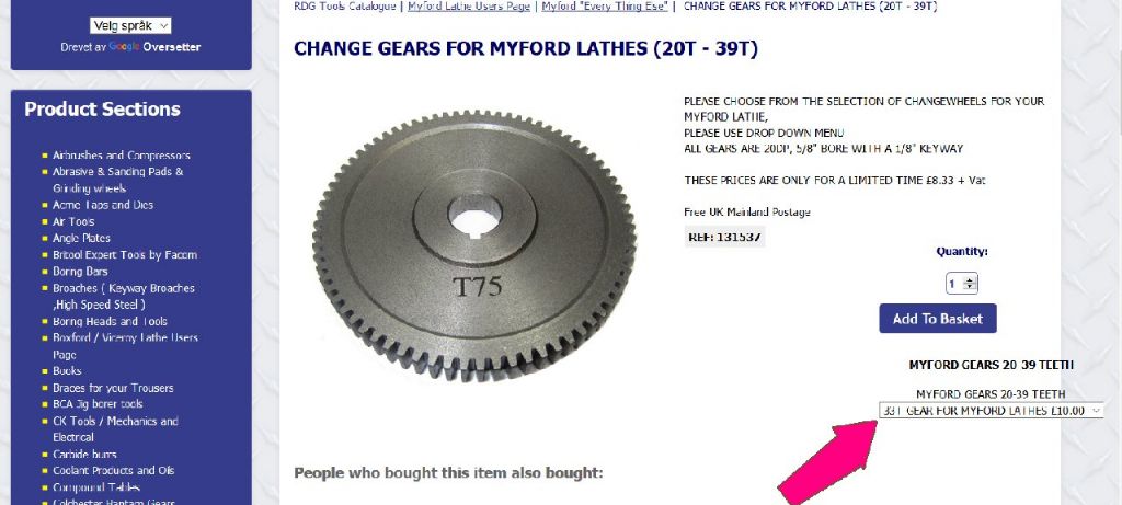

            Hi Mike,
            It seems the 33T is available from RDG.
            Thor

                That's great Thor – I'll buy a 33T from RDG.
                Does anyone know where I can get the 34T?
                Mike

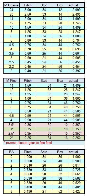

                      Mike,
                      Just for interest I calculated the actual pitch achieved using the official Myford metric conversion set for the gear box. The actual figures are in the right hand column:
                      A similar calculation for the 33/34 option is shown below
                      So, the official set is an order of magnitude more accurate but for practical purposes the difference is negligible. For the finer metric threads some additional gears to the 33 and 34 are useful. I have the metric conversion set, it came withe my S/H lathe but when I needed to cut a 16mm x 2 thread last week I broke out the 34T gear. Much more convenient.
                      HTH,
