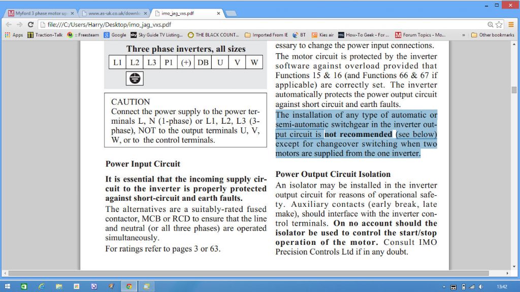

                              Someone is going to say it so it might as well be me, the inverter makers recommend direct connections between VFD and motor, contactors are not recommended between the two.

                                    Posted by chris stephens on 09/10/2014 12:15:01:
                                    News to me, whys that?
                                    Just that have been running an inverter for 4 years in an industrial environment through original machine contactors in the way the machine was made.
                                    #166090
                                    Harry Wilkes
                                      @harrywilkes58467
                                      Posted by Jon on 09/10/2014 13:26:14:
                                      Chris is quite right in what he states this is taken from the Jag instruction manual see screen shot
                                      #166095
                                      Jon
                                        @jon
                                        Thats just a cheap inverter, granted.
                                        There are plenty of 'Plug and Play' inverters around designed to supply a workshop or individual machine exactly the way it would be sent by your electric supplier. I use one.
                                        #166096
                                          The reason is that the inverter is a much less 'stiff' supply than the mains. Drop the load of one puny 25kW motor in or out and the national grid doesn't notice.
                                          Suddenly cut the load from an inverter and the output could potentially be damaged. Even more likely is damage if the inverter is running and the motor is suddenly switched in.
                                          That's why they advise that switching is before not after it.
