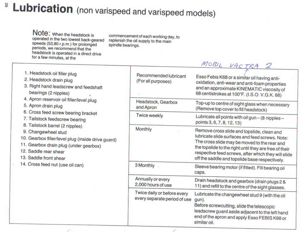

      I have a Myford 254S in need of an oil change. There are 3 separate oil-baths – Headstock, Gearbox and Saddle. I have two questions :-
      1) The amount of oil required to fill each oil-bath to the required level.
      2) Which oil to use where – I know the Gearbox and Saddle use Febis, but I’m not sure if the Headstock uses Febis or Nuto.
      Any advice gratefully received.

        You can get the 254 User manual at: groups.io/g/myfordlathes (look in Files), Febis is a Slideway oil, Nuto a Hydraulic oil, the manual says Febis. I guess you need to be a member to see the manual.

          I used Morris Liquimatic No4 32 Hydraulic Oil. I used this oil in the 254s gear boxes and for the slideways, I bought 5ltr,

            Here you go; same oil for all  purposes.
            image_2024-12-17_183049140
            Bill

              I got the equivalent of Febis from a local supplier. Beware, something which looks like wax settles out and blocks the sight glasses, so you can’t see the level. I now just use straight 68 for gearboxes, and the Febis for the slides. This might only be a problem with this supplier of course.
