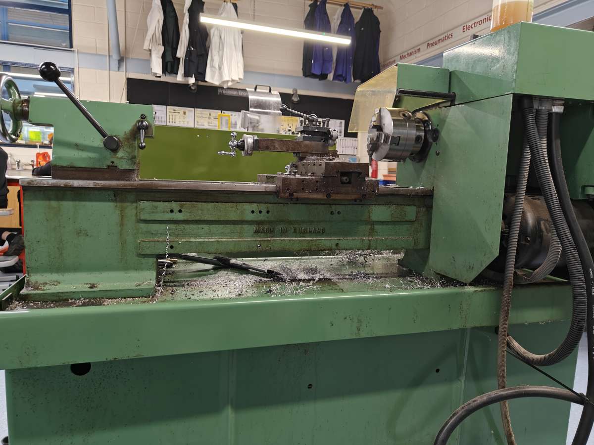

      I’ve got a Myford 254s and I need to aquire a rear splash guard for it. It is a very old machine so I can’t buy the part, an yone know where I can source one? Am I going to have to fabricate something myself instead?
      Thanks (below is the view from behind) IMG20250311085346

        Pretty straightforward to fabricate something effective from the pictures at https://www.lathes.co.uk/myford/page10.html on Tonys site.
        Many ways of doing the deed depending on facilities, skill, available materials and just plain taste.
        I prefer a lift off style aligned by sliding clip hooks and held down by gravity so it can be easily removed if need be but there is a risk of vibration rattles. These days a few strategically placed magnets would probably sort any such issues. The ones I’ve made in the past have either been heavy and / or had a couple of easy to get at from the front. screws holding the top to the wall so rattles have not been a worry. I don’t advise bolting to the back due to potential access issues. A fixed splash-back does make moving harder.
        I like the “speed frame” knock together square tube system with simple flat panels pop riveted in place as a basis for this sort of thing. Simple rectangular frame at the back made to sit on top of the chip tray end panelling. A single piece sticking forward to support the bit at the tailstock end. If you want to support the angled top at the tailstock end a bit of creative bracketed will be needed to get the angle as speed frame joints are 90° only. Panels on the lathe side of the frame. Creatively shaped clip bars hanging over the back to locate.
        Objectively speed frame is on the pricy side but it does make a neat job easy for those of us whose panel beating and welding skills are not as good as we would like to believe.

          If you make one, maybe you can obtain some box section, say 25 mm square, (Discarded office tables / desks?) to use as the framework, and then pop rivet sheet metal to it, with suitable “feet” at the bottom.
          If really desperate, as a less durable screen, ply or hardboard could be used, although painting would be advisable.
