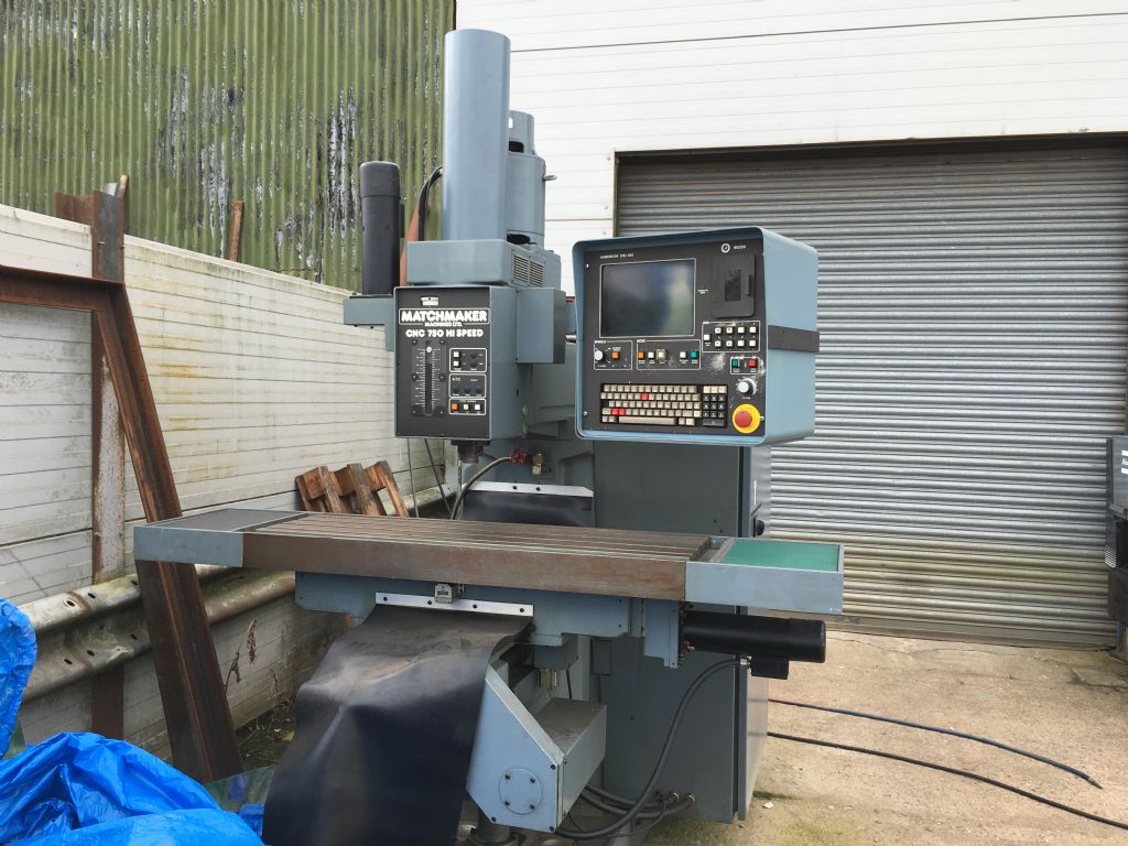

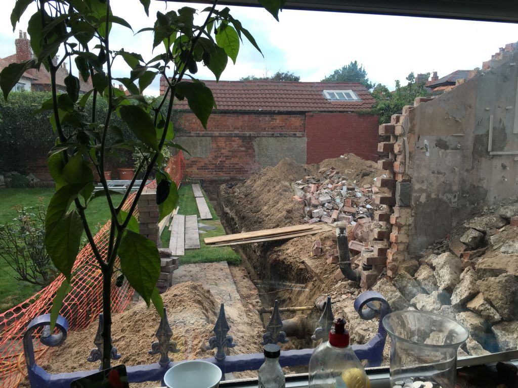

                              I'm on a similar journey although I think it's fair to say I am some way behind you. When I looked out there a couple of weeks ago there was a perfectly good (single) garage and an outhouse….
                              Garage - gone
                              Not content to wait for the building to be quite complete, I've already started out on the task of filling the new workshop. After all, you have to take these things seriously.
                              Shizuoka CNC milling machine (2.75 tonnes of it):

                                                    Good grief, that looks more like a bomb site than a building site! Is the building at the back part of your property? Looks like it's got some large sliding doors; could be ideal for a workshop.
                                                    Man, I'll bet that mill will shift some metal when it's running. I hope the concrete floor will be strong enough. Was there a 4th axis with it, or provision for same? Clearly I've been outclassed, I'll now go and commiserate in the workshop with my Tormach. crying 2
