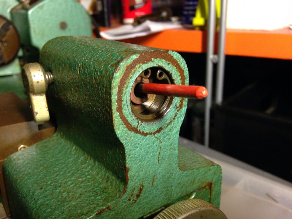

        Pete, I am wondering if there is anything missing on my tailstock.
        I include the snapshot here
        I replace the tailstock bolt with a paintbrush just for an illustration.
        I am wondering if there's supposed to be a bearing, spacer, or bushing apart from the tailstock handwheel.
        and is there anything else behind the space of the retaining ring, or in front of the retaining ring since I only have the handwheel that screws into the bolt (paintbrush).

          Oliver, Is the picture above showing the back of the barrel still in the body of the tailstock or after the barrel was taken out? It looks like what is still in the hole is the 'plug that is normally hard up against the circlip. Show us a picture of all the other bits ie the handle and screw etc. Whether there is something missing depends a bit on what the screw looks like as it should have a flange on it that pushes against a plug that is held in by that circlip.
          If the screw goes into a thread in the back of the barrel which is the normal design all you need is to put a shin bar into that hole against the back of the taper and tap it repeatedly, perhaps with some rusty bolt release liquid in there. It also might help to put it in the freezer for an hour then quickly heat the outside with a paint striper gun while tapping the inserted bar.
          Later once freed you should always be able to release a taper by retracting the barrel which results in the screw pusing against the back of the taper. however some taper are cut short so the screw doesn't meet them. Note which ones have this problem and put in a litte spacer each time you use that tool. What is more common is the tang on the taper means it is exjected too soon so pwople then cut off the back of the taper, but can cut off too much.

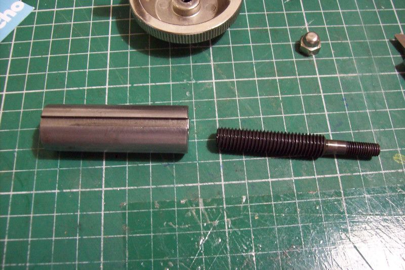

            Oliver, that thing inside the tailstock is a brass bush/thrust washer and that's all there is to it. It stays on one side of the circlip and stops movement in one direction and the handwheel does the other. Nice and simple, and even if we break the circlip I'm sure it'll be a stock size.
            Separated. The handwheel turns this coarse left hand thread.
            Here's my recommendation for your stuck chuck. (let's not forget that this is a micro lathe and the casr iron parts could be damaged by heavy handed hammering smile o )
            Soak the drill chuck and tailstock slider in whatever easing oil you have overnight at the very least. And, if you feel like it, apply a flame to the slider to heat it up, not to red hot, but hot enough so that water evaporates instantly.
            Then, re-assemble your tailstock without the handwheel. Use a couple of M6 nuts and lock them together on the thread at the back. Then, wind back a bit of pressure, as if to pull the slider away from the chuck with your 10mm spanner, then put a 17 or 16mm spanner behind the chuck. Use that to lever against the chuck and tap it with a hammer at the same time.
            You could also try a brass drift and a few good hefty taps at the back of the chuck.
            If that doesn't work realitively easily, you'll need to make up something that looks like a ball joint splitter out of steel, which will apply more pressure as it's also a wedge shape which you will have to tap in to the join before tapping it sideways. Once again, beware ot damaging the cast iron tailstock body.

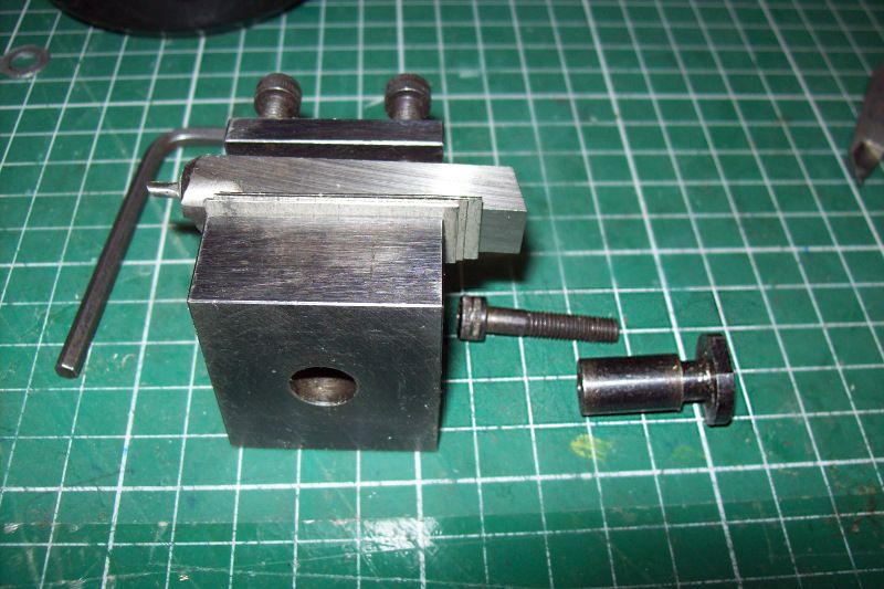

            And this is my original toolpost.
            There's an M5 machine screw through from the top and the heavy sleeved 'T' slot thingy measures just under 7mm at the 'neck' and has flats machined to 14mm wide on the 16mm flange. The 7mm 'neck' is 5mm long, so it's actually 2mm clear of the saddle once locked by the screw. The fat part of this one is just under 10mm to suit the hole in the post.
            I'm certain that the proxxon one will be close to these sizes, and if slightly bigger, any alterations shouldn't be a problem since you've found a friendly machinist.

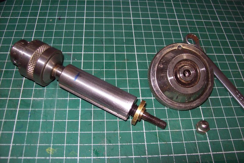

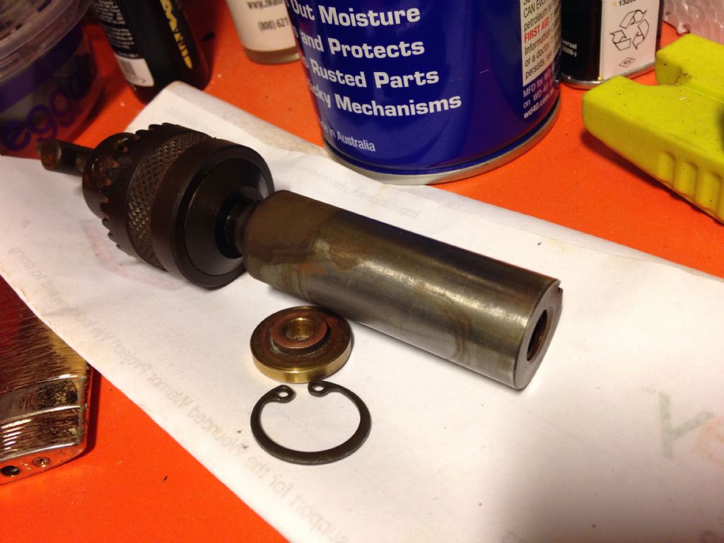

                I lubricate and knock apart (gently) what I assume was part of the cast iron body of the tailstock >> it is the Flange.
                The brass part which completes the tailstock assembly.
                I was lucky not to have to use any other trick other than WD40. but I'll keep in mind that heatgun, Blue Tack, or the fridge. I assume it will comes in handy.
                From the photo above, what I couln't show is the bolt which holds the barrel, and the handwheel. They are with the machinist. I will tell him too that the flange in question has been found laugh.

                    Looking at the pic of my tool post, it's dimensions in that view are as follows:
                    40 x 40 mm and 35mm across
                    The cut out starts at 16mm from the base is 16mm high (under the screws) and 10mm deep. Presumably for 10mm tool steel.
                    At the back is an 8mm through hole, 26mm up from the base, 6mm in from the back edge and paralell to the cutout. This has two short screws for clamping round shank boring bars or maybe as cigarrette holder or whatever.
                    Hope that helps Oliver
                    The central hole for the 'T' slot bolt is by no means a close fit on the bolt and no precision should be imagined when adjusting the post by this means. wink 2

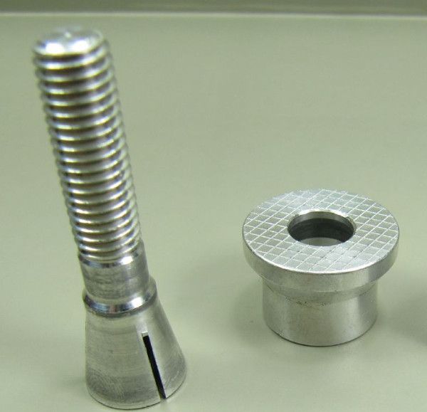

                                        Just re-read that and wanted to say that I have no way, at the moment, to cut threads on this lathe, so I'll have to thread my propeller adapter collets manually with a die.
                                        Hmm , no. Actually I will be forming the body of the collet and drill/reaming the centre bore, but not parting it off to the correct length immediately, so that I can turn it around and use the per-pated large diameter to hold on while die cutting the thread with the die holder backed up against the tool post for stability.
                                        This is a prop adpter collet, the thread is M6 on this one. The 'top hat' thing has the matching 'female' taper to compress the collet and the split part of the collet will have a reamed internal bore to fit whatever motor shaft.
                                        Sorry, just thinking out loud there. wink 2

                                            Pete,
                                            If I follow you correctly:
                                            Rough it out, oversize, and cut the thread with your die.
                                            Now put a bit of scrap in the chuck, and drill & tap M6 … Don't remove it.
                                            Run a nut up the M6 male thread; then screw it into the piece in the chuck, and use the nut to lock it.
                                            Proceed to turn the part to size.
                                            It won't be perfect, but it should be pretty darned good.

                                              Yes, the thread is not so important, because it doesn't specifically align the prop.
                                              The critical areas of the prop adapter are the reamed bore for the motor shaft, the taper and the plain section and step before the thread. Those absolutely must be machined at the same time to maintain concentricity between the motor and alignment the propeller's own central bore.
                                              It will be preferable for me to get the final saw slit prety central too. I may have to make up a similarly M6 threaded chunk of scrap to mount on the toolpost and run a fine circular saw in the lathe chuck.
                                              Also, if I am forced to make my own female taper section, that will be critical too. Mind you, I'm using plastic propellers that are mostly injection molded. So I do have to pre-balance check them off the plane as well, then see if there's any vibration once mounted.
                                              It's all fun in the end. If it's wrong, I launch the plane, the prop vibrates like all hell and then either the motor burns out, the speed controller fails, or the prop shatters.
                                              Hehe! But seriously, it's never nromally that bad. teeth 2
