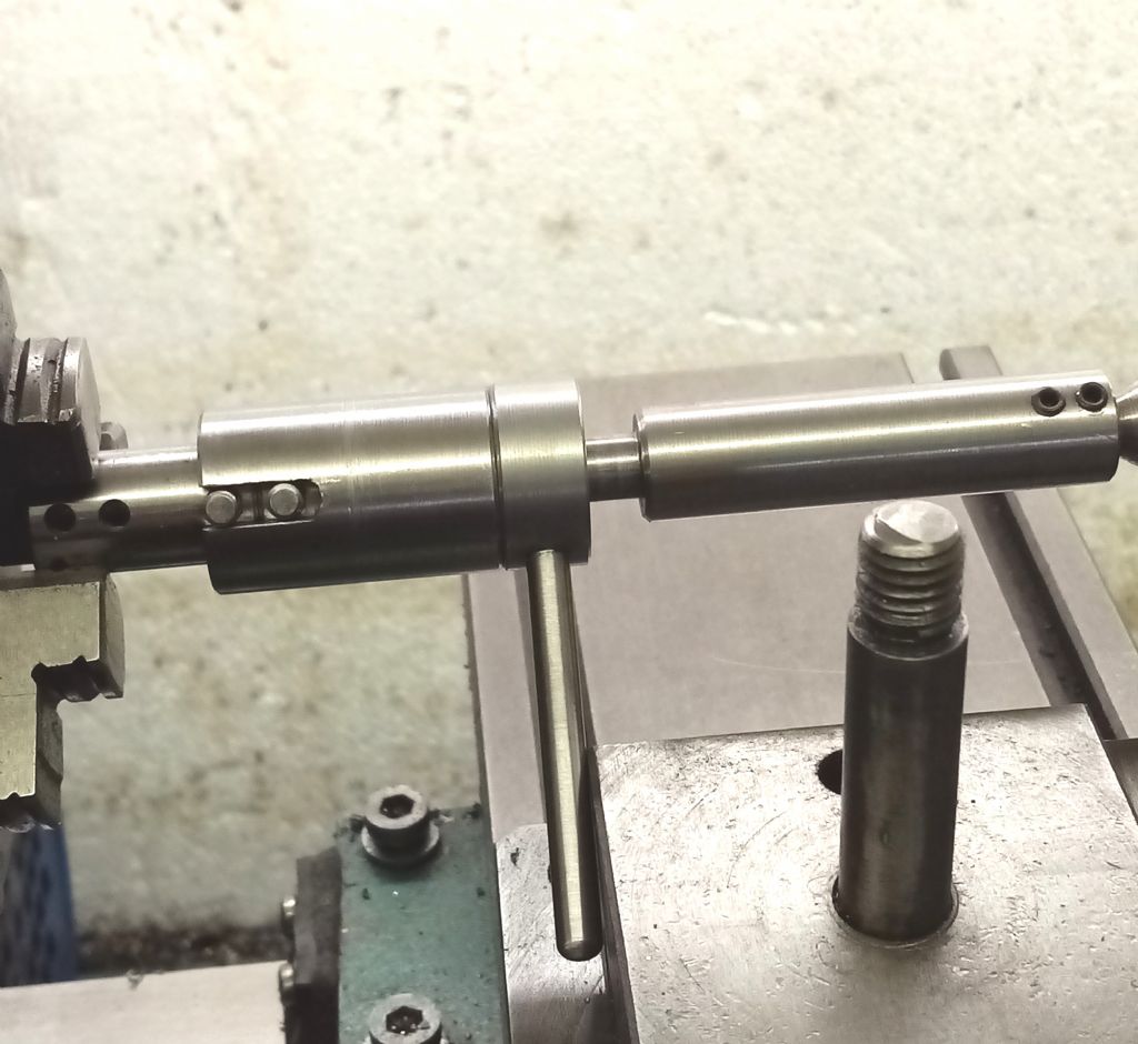

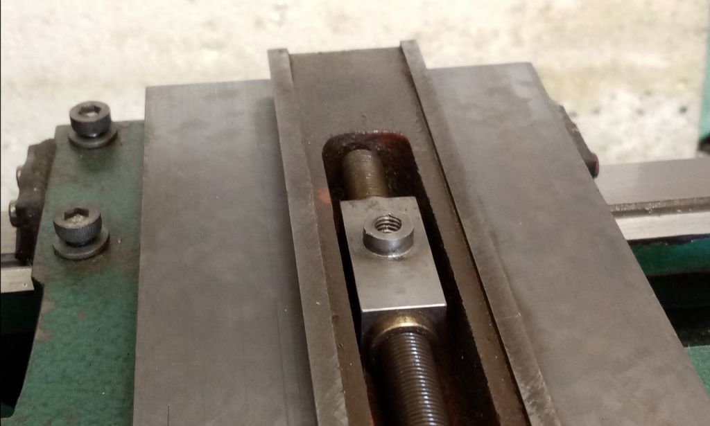

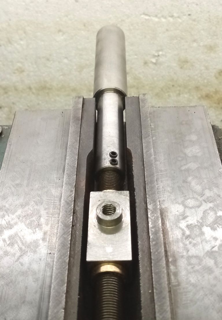

I now have a driven cross slide which has worked out quite well, tested it this morning with various cuts, various materials. With brass and aluminium it sailed through it with no issues but of course steel would be more of a test. I put up some 25mm EN1A and tried various facing cuts, I went up to 1.00 mm which was fine and it would probably handle more but I didnt push it. The thing I was hoping the drive would handle is parting so using the rear tool post and a 2.0 mm insert I tried the steel. No issues at all, no grabs, no hesitation, cut smoothly all the way through, how nice it was to have both hands free whilst parting off.
I then tried parting some EN8 and the drive wasnt so happy with that, it hesitated a couple of times. I think the answer is to upgrade the motor/box to one with a higher torque rating. I happen to have one, its a bit bigger in diameter, twice as long but with 4X the torque of the one I am using and wont need that much work to change it over.

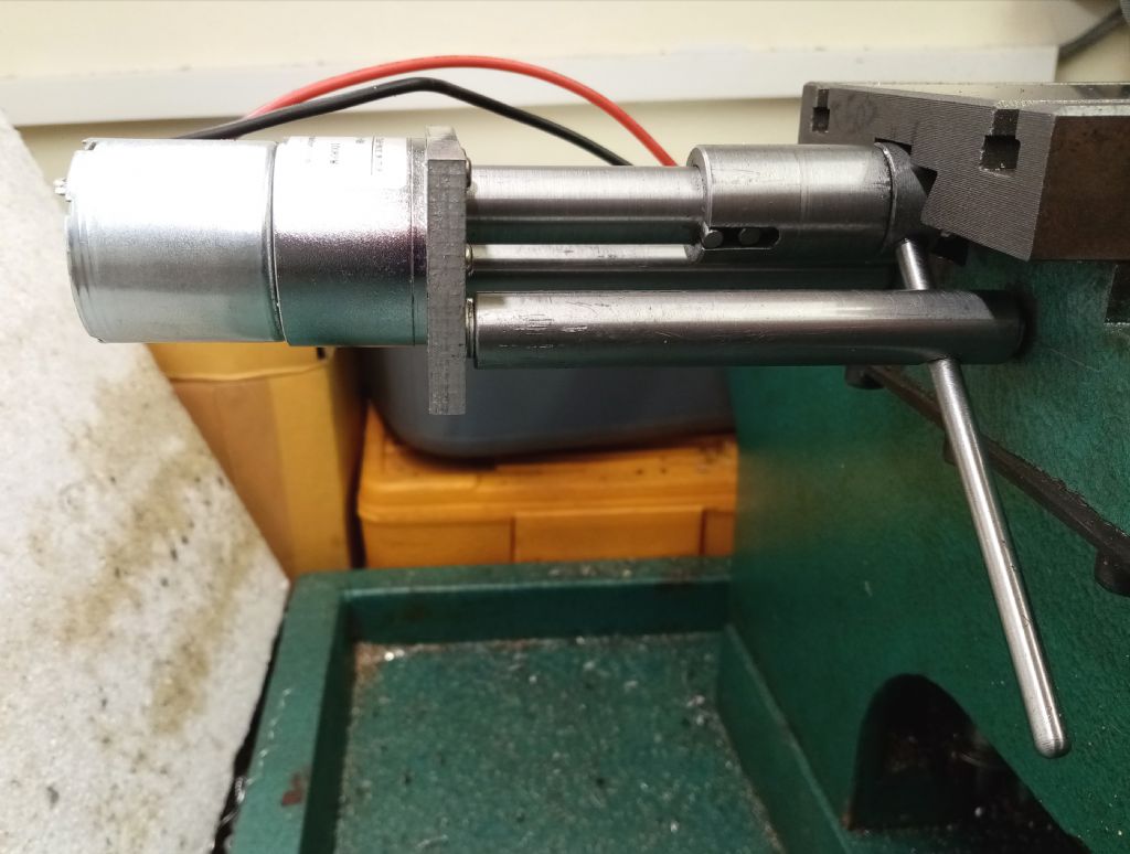

The way I have gone about fitting the drive means the motor/box/clutch and drive hanging out the back off the saddle. To use an inline motor on the centre line of the lead screw it has to be positioned that way as the cross slide runs out 90mm when fully rearward. It would be possible to have the motor closer and tucked underneath the cross slide but it would mean building a gearbox of some sort.
Anyway pleased with the drive it works well enough, just a couple of improvements to do, change the motor and sort the electrics plus build a small control unit and fit to the front of the lathe.
