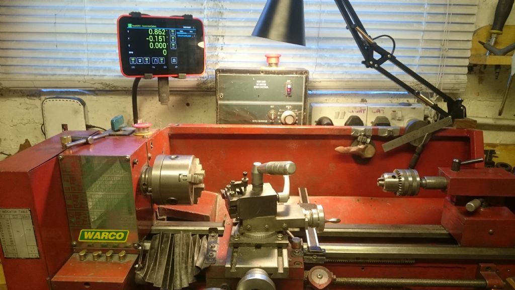

              The warco 918 is a good old lathe but has its weaknesses one of which is the compound but the mod for this is well worth doing to stiffen up the toolpost. Ive also converted mine to a treadmill motor which works brilliantly,also the Dro. 2018-01-17 12.44.24.jpg
              #439760
              Ron Laden
                @ronladen17547
                Sounds good Trevor, I am certainly happy with mine. The previous owner had done a number of mods which are well engineered so I was lucky. The only thing I have added is a digital readout for the spindle speed.
                Ron

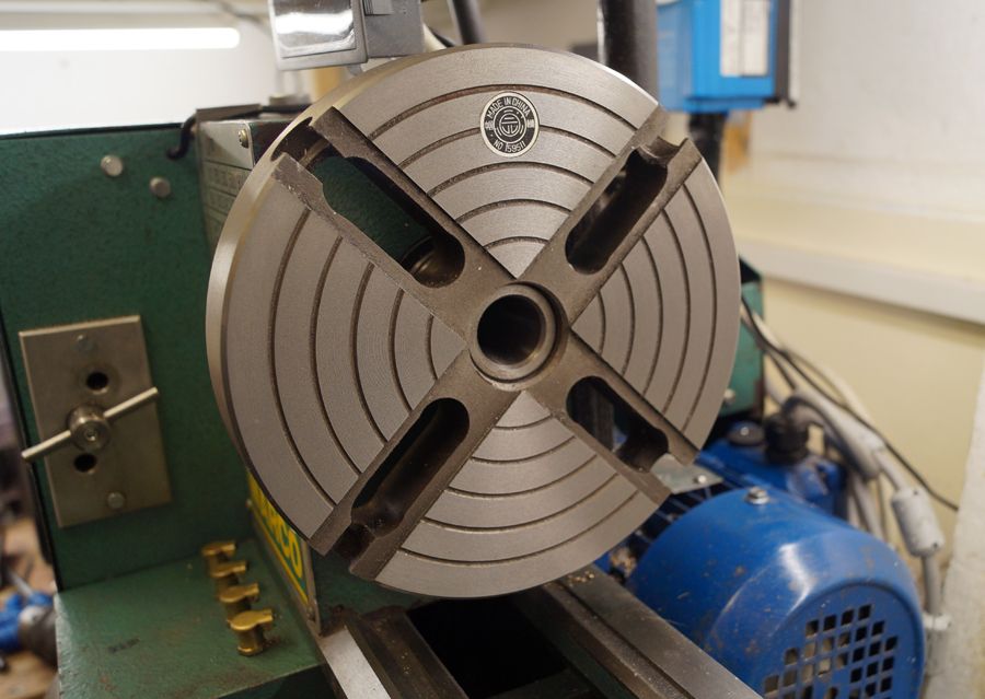

                                      The lathe came with two 4 jaw chucks, a 6 inch Burnerd and a Chinese 7.1/4 inch, the Chinese one is pretty awful, difficult to adjust and set up and once set the jaws have to be locked from behind, a b it of a pain in the wotsit.
                                      However what is really good about it is the casting is shallow only 30mm and it is quite true, 0.001" across the face and when run 0.0025 run out at the edge. So rather than leave it sitting in the corner of the shop never to be used I thought it will make a good candidate for conversion to a faceplate. This morning I gave it a 5 thou skim all over to clean it up and once I have finished the Jowitt I will add 4 more slots and make up some fittings and clamps.
                                      Edited By Ron Laden on 11/03/2020 16:27:57
                                      Edited By Ron Laden on 11/03/2020 16:36:03
                                      #456722
                                      Lathejack
                                        @lathejack
                                        That 7 1/4 inch independent 4 jaw chuck was standard issue supplied with most new 918 lathes. They are awkward to use for metal work because the jaws are not positively or precisely located in a tee slot, I think they are actually really intended for wood turning lathes.
                                        Edited By Lathejack on 11/03/2020 22:44:53
                                        #456742
                                        Ron Laden
                                          @ronladen17547
                                          Thanks LJ
                                          I thought it probably original issue which in my case is almost 24 years ago. There is no way I would want use it as a 4 jaw plus I am fortunate in having the Burnerd.
