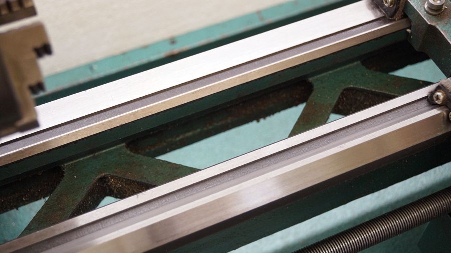

I cleaned down the lathe this morning and it made me think, I would imagine that the majority of people looking for a second hand machine would never consider an elderly Chinese machine and I can understand where that comes from. What made me think is the lathe bed (picture below) 23 years old and like new, I have checked it with a good straight edge and its spot on along its full length. Ok its a hardened bed and obviously it has been well looked after but even so pretty impressive for its age I think.
The lathe had been advertised for 5 weeks and despite having a wealth of tooling and accessories there had been no interest until I found it. The lathe has a number of very well engineered quality mods and improvements to eliminate some of the niggles it had originally, it is also converted to 3 phase/VFD but even this didnt encourage anyone.
Whats my point..? well I just think that if you are looking for a lathe and your pocket means second hand as it did with me and you find a machine which meets your requirements dont automatically write it off because its Asian and elderly. I realise that there will not be lots of them about, I was just really lucky but if you find an older machine in good condition, then its age probably means it has been improved and it could be a very good machine at a very good price.
My two penneth anyway.
