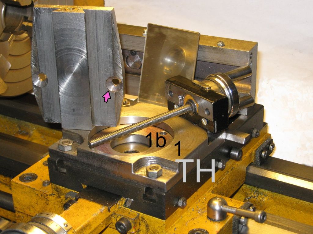

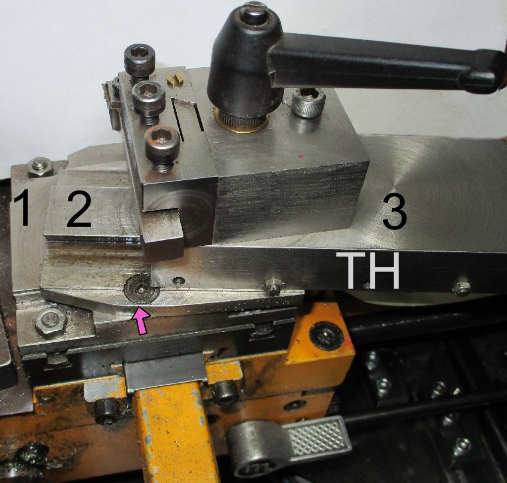

                        Hi Brian,
                        Steve's mod was one of those who inspired me to make the longer travel topslide. I have added two photos that I hope may explain how I made it. The arrows in the two photos point to the same countersunk hole/screw, No.1 is the base with a recess on the underside, 1b is a ring that fits inside the recess, 2 is the bottom of the topslide and 3 is the top. The two M6 countersunk screws fits into threaded holes in 1b.
                        Thor

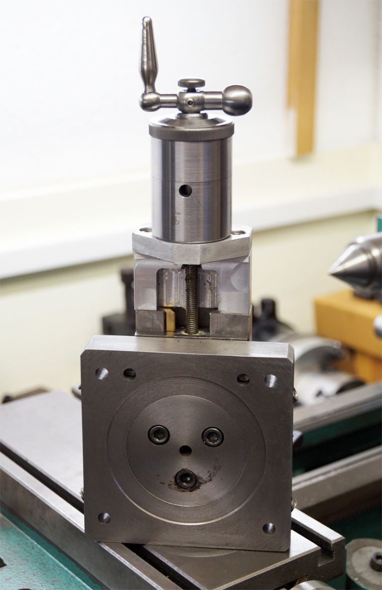

                          Hi Brian,
                          A picture below of the underside of the mount, you can see the top side in the video I posted. I dont want to take it apart as it is very well set up and adjusted.
                          I am not certain but I think it is based on a George Thomas design but with some tweaks by the lathes previous owner. I will be speaking with him later today I will try and find out more. You are correct in that the angled grub screws (2 front – 2 rear) lock the swivel via small pushrods with an angled face that contacts the radius. It works very well just a light nip on each grub locks the swivel solid.
                          Some of the mods on the lathe follow those done by Stephan Gotteswinter to his 920 style lathe. If you go to Youtube and search for "Stephan Gotteswinter Shoptalk #7 The 250 x 550 Lathe" you should find his video which runs through the mods he made….well worth a watch.
                          I will let you know if I find out more.
                          Ron

                            Hi Brian,
                            My mistake the compound mount is not a George Thomas design, that was some other parts on the lathe. The mount is Adam,s (the previous owner) version of a design that he found on the Yahoo 920 forum. I was going to have a look for it but for some reason despite my searching I cant find the Yahoo 920 Forum, I dont know if it still exists, I would have thought it did but I cant track it down.
                            Should anyone have a link to the forum it would be appreciated.

                              Hi Ron,
                              The files section of the 920Lathe is here, the file might be ABetterCompound.pdf.
                              Thor

                                  Thanks Thor, yes ABetterCompound is the one which mine is made to, though the external shape is different on mine.
                                  Brian, worth considering if you are going to modify as it really is a rigid design.
                                  Ron

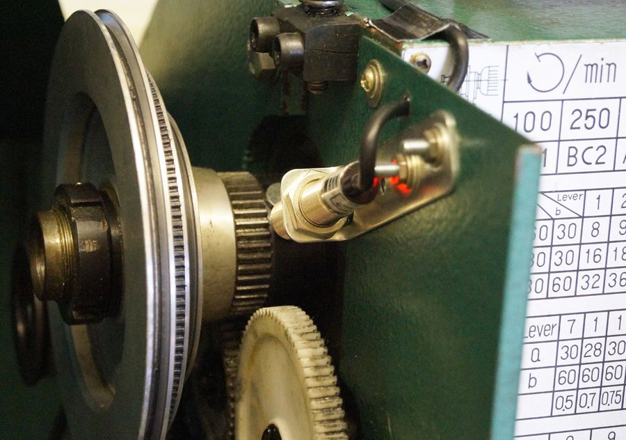

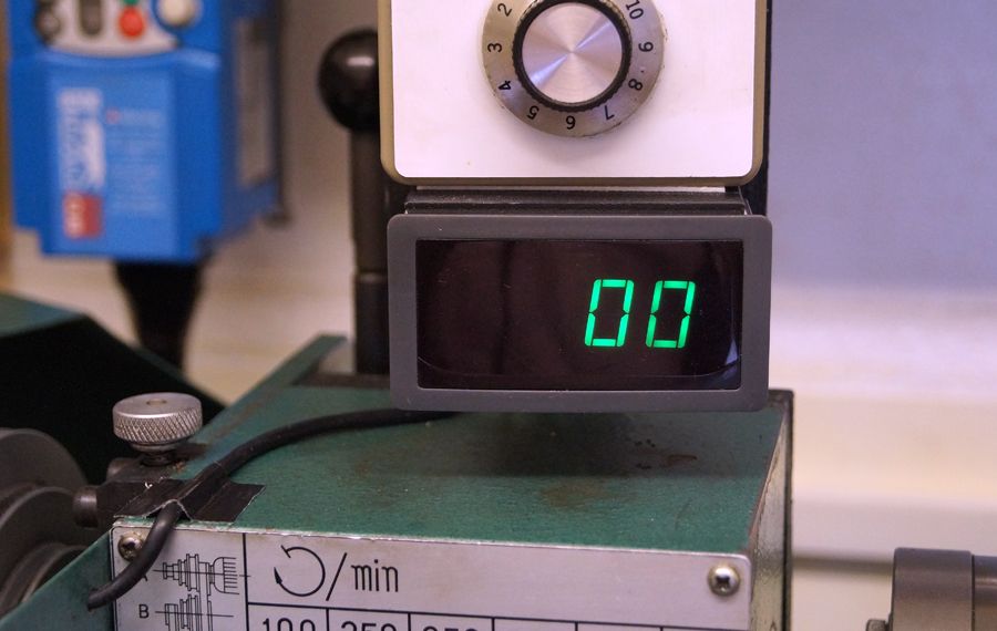

                                          Fitted a DRO this morning.

                                            RPM not DRO?
                                            #421462
                                            Ron Laden
                                              @ronladen17547
                                              Posted by Andy Carruthers on 29/07/2019 14:54:33:
                                              RPM not DRO?
                                              Andy,
                                              RPM yes but it is still a DRO (digital readout) isnt it..? well thats how I always refer to them.
                                              Ron
                                              #421466
                                              Andy Carruthers
                                                @andycarruthers33275
                                                Yeah I guess so, the display itself is digital though the function is RPM whereas DRO (IMHO) is synonymous with distance measurement, at least, that's how I think of it…
                                                Honest guv, I'm not trying to join the pedant club, I know too little
                                                #421468
                                                Ron Laden
                                                  @ronladen17547
                                                  Andy, I am awaiting delivery of a set of 3 DRO,s for the mill, I guess its the digital display I associate with "DRO" regardless of what its measuring.
                                                  Ron
