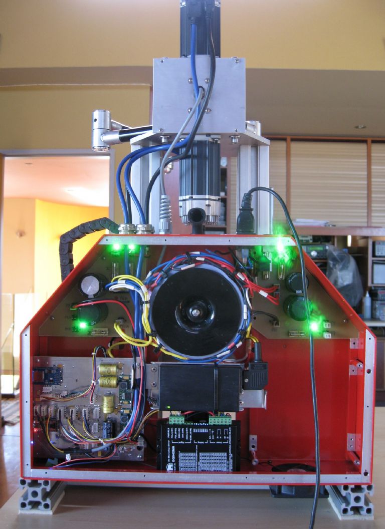

        WARNING – Those opposed to over-engineering should avoid reading this lot…
        This project started as a challenge, rather than any need for a 3D printer. It has been almost a year and slowly it is starting to come alive – although I still find no need for a 3D printer…
        Anyway, a challenge it is – Polar co-ordinate world to work in, with inverse kinematics and some fun math..And I don't leave it there – the Hot end is an induction heated one, the heat part is currently being worked on on the bench in an attempt to see how often I can blow it up in one day…
        Also, the extruder drive train will ( hopefully..) be a brushless (RC) motor drive – so am also developing a Step/Direction input brushless motor servo drive. The reason for the induction heater and brushless motor drive is to try get the entire hot end / extruder below 150grams, 200grams max. I also want the extruder to be at the hot end, no Bowden tube, etc. So a lot of fun still to be had.
        In the meantime, the actual SCARA arms, the drive servos/stepper, powers supplies, Nucleo brain, etc ias all together, and my good Wife is software-ing it – I have to fit a spring loaded pen to the hot-end end, so she can draw some calibration verification squares and circles to start.
        Some photos – beware, the qty of pics matches the engineering effort..

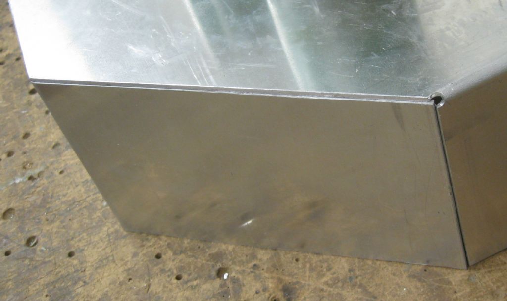

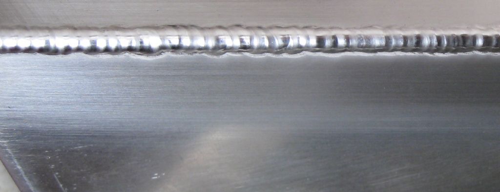

        The electrical/electronics box, ready for tig welding
        Some tigging done..

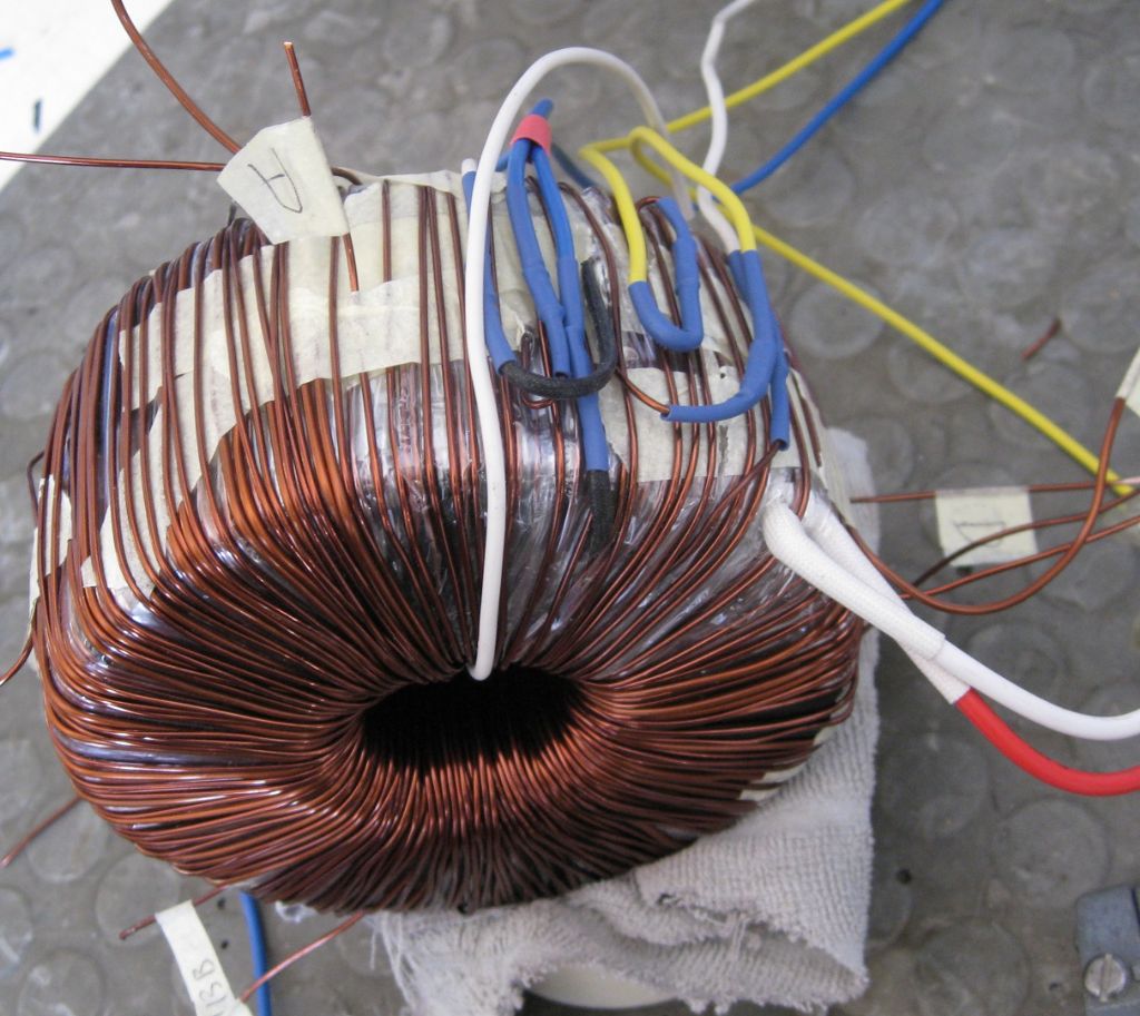

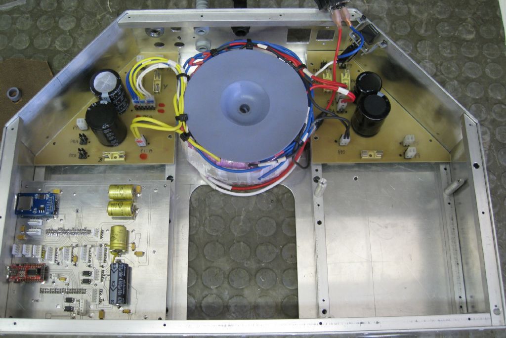

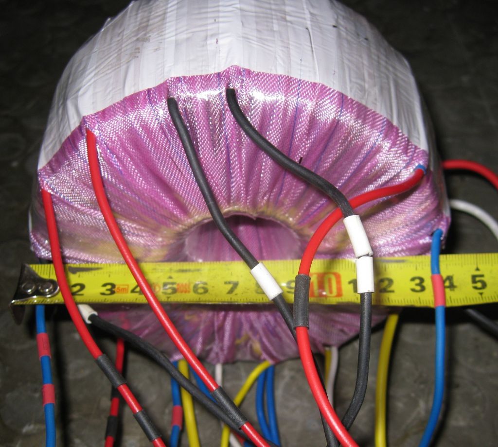

        Re-winding an old Amplifiers toroidal txfmr to suit my voltage needs:
        All Wound:
        Trial wiring before stripping and painting:
        Ready to strip and paint:
        Painted:
        Starting to test things:
        Electrical box wired – Extruder control and induction heater still to go in at lower right.

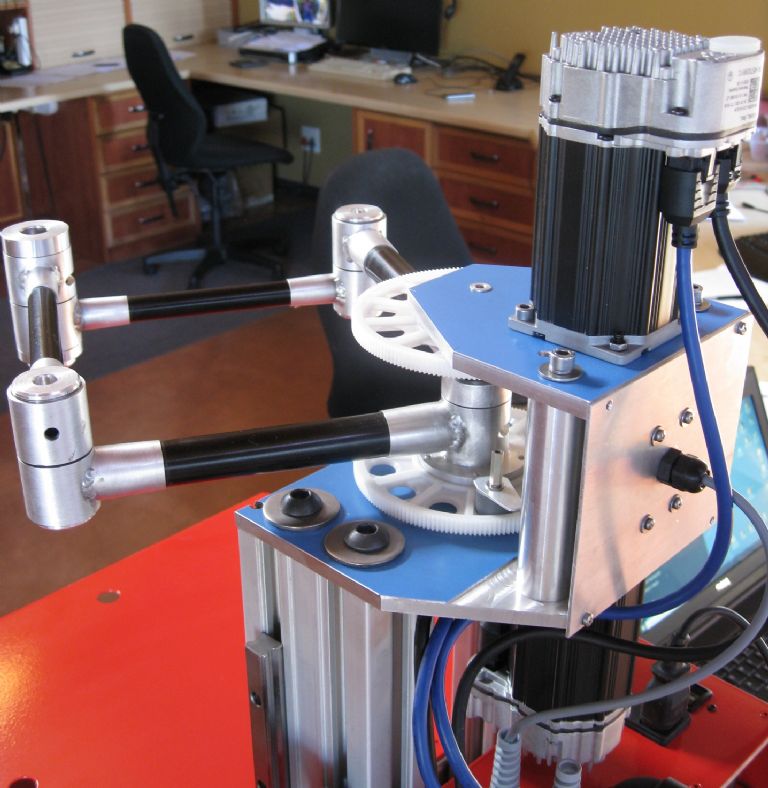

        SCARA Arms servos:

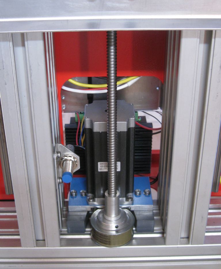

        Z Axis Stepper drive and leadscrew:
        Next installment when the thing moves about and draws stuff…
        Joe

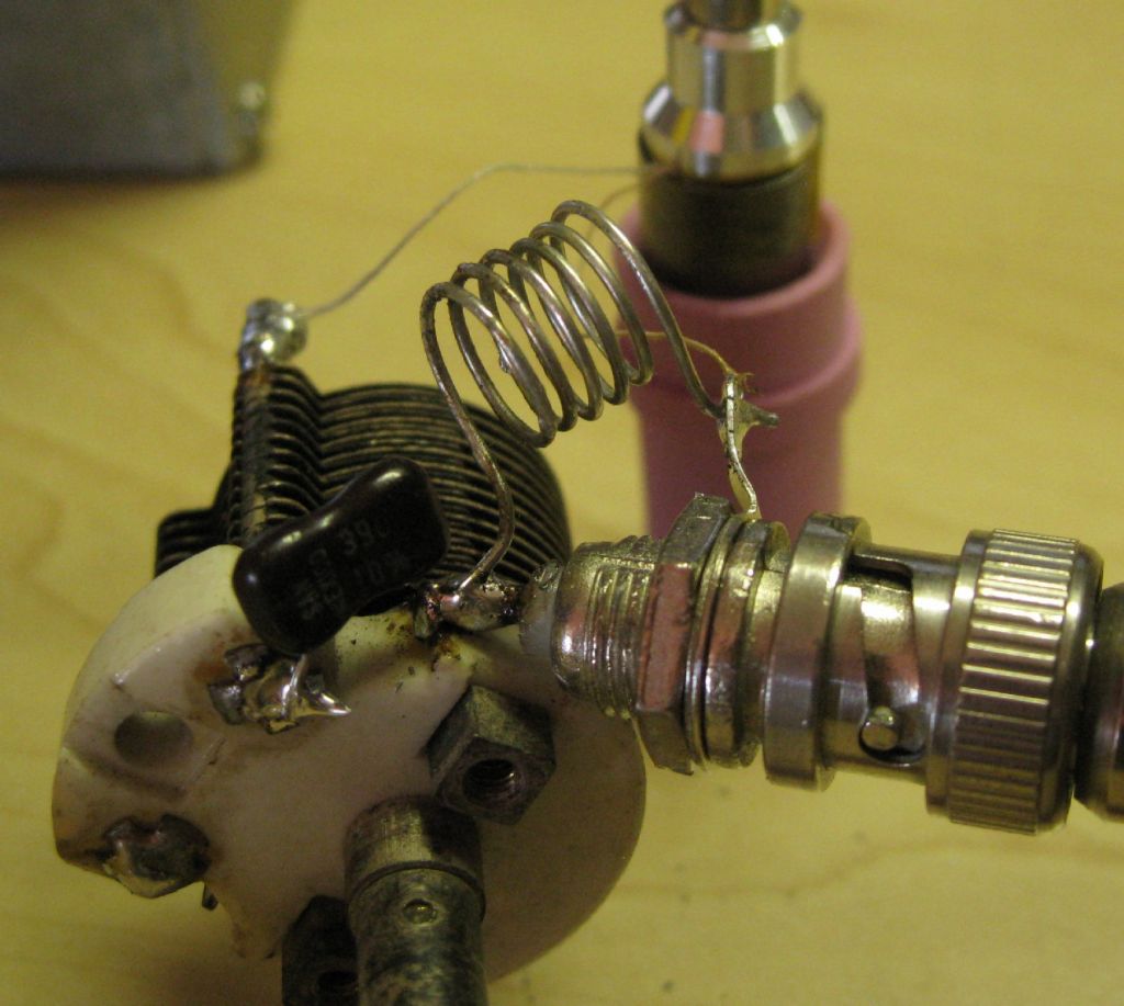

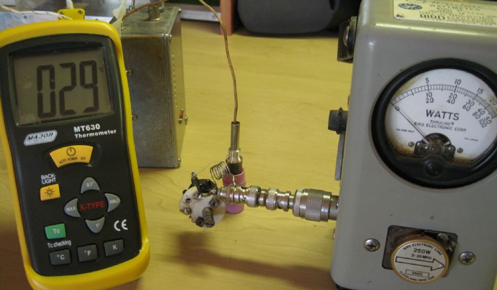

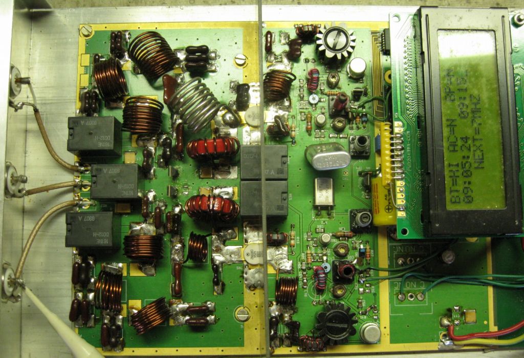

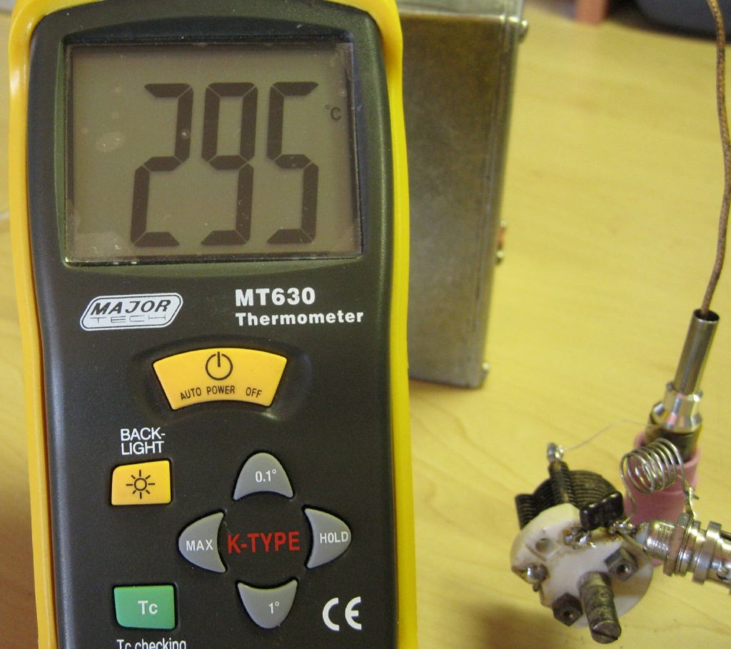

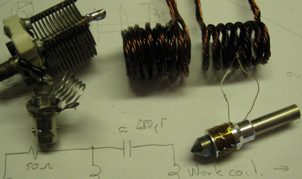

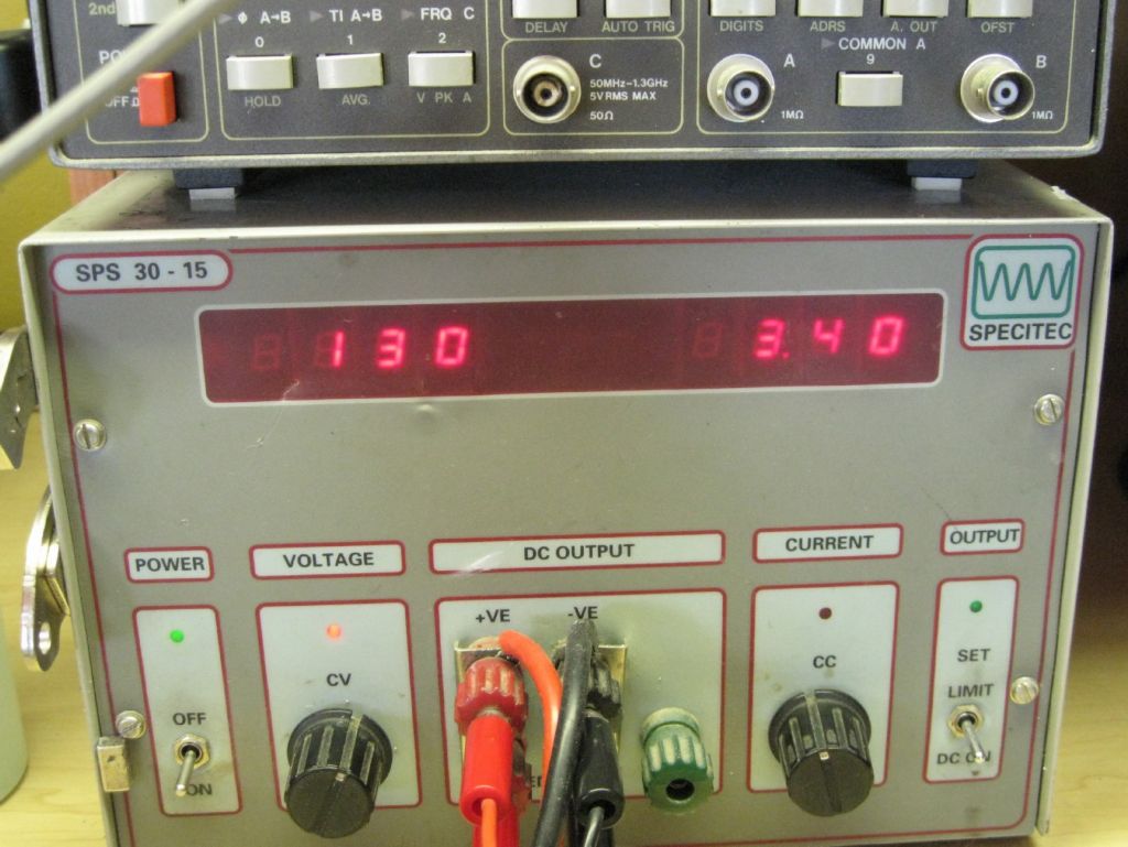

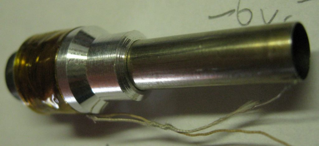

                                    I have progressed a little on the Induction Heater for the printer Hot End. I tried various options, Class D switcher, Royeur, and a few others. The Royeur worked well, is simple, and was quite efficient, but failed as all these topologies did, because they are all 'low frequency' – that is, typically below 500Khz, and mostly around 80 to 200KHz. I am trying to heat an aluminium shaft, which holds the hot end nozzle ( non-magnetic stainless steel) and for that the frequency needs to go up – way up – to the 7 to 14MHz region.
                                    So to test this theory , before starting on the RF source design, etc, I dragged out of the store room an old 50watt solid state CW transmit brick ( was used as a variable power output HF CW beacon, for NVIS tests, long, long ago..). I knocked up a test hotend, with the nozzle attached and a 6mm thin wall St/Steel tube as intended heat break.
                                    The body is aluminium, with the heating coil of 16turns, diameter 10.5mm. This measured out at 3.5+j20 ohms.
                                    The RF source was set to around 35 watts, and a 50ohm matching network kludged to match to the work coil.
                                    The results were indeed very pleasing!

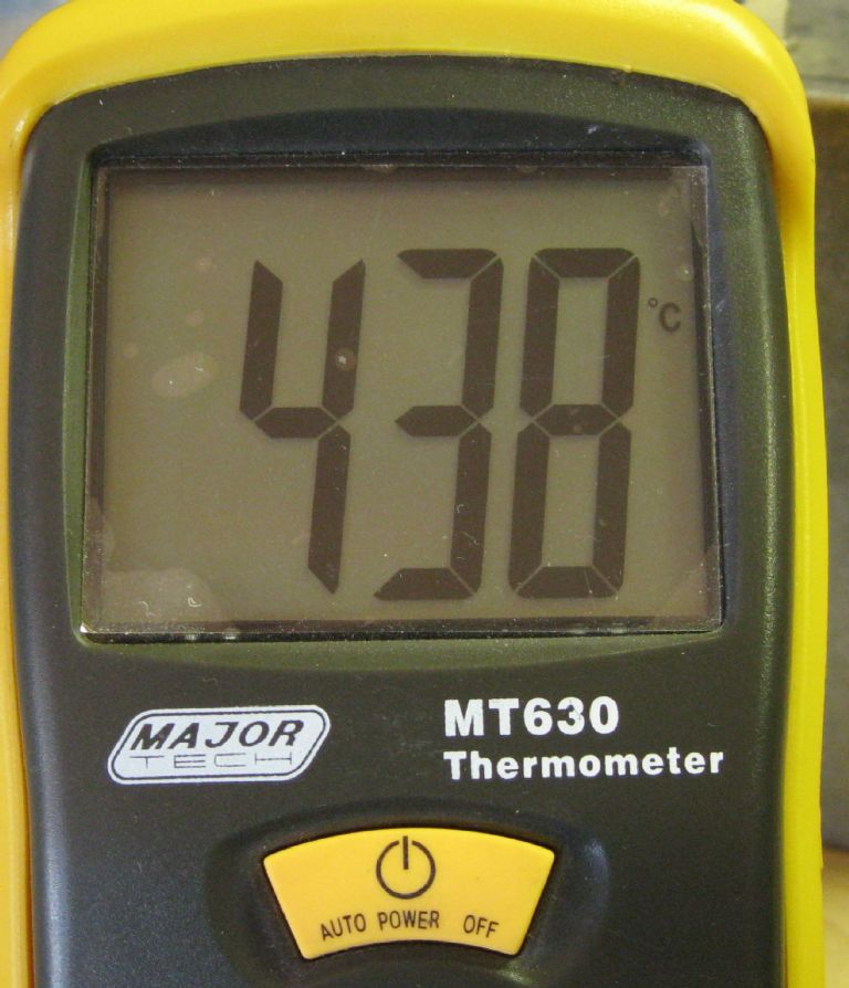

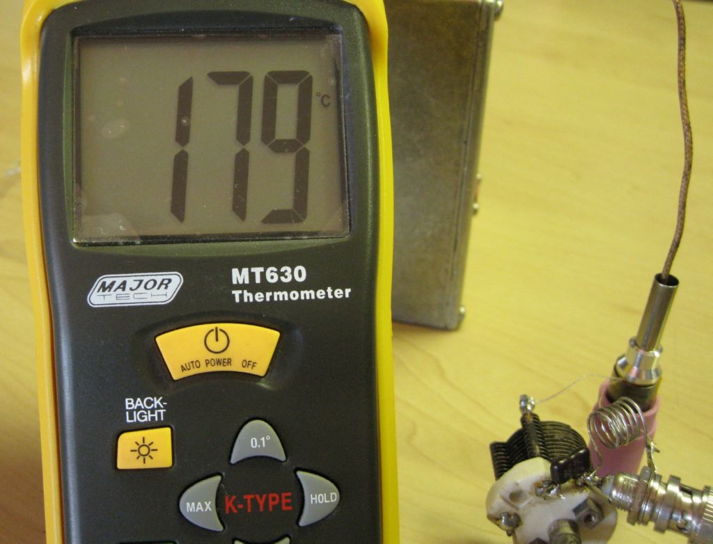

                                    The hotend heats from 25degC ambient to 180deg in 15sec, to 295deg in 20sec and to 440degC in 50sec.
                                    Some non-linearity there, mainly due to the heated material eddy currents behaving differently at the climbing temps.
                                    Some pics :
                                    Test setup – The hotend is the device sitting atop the pink ceramic thingy..The wire entering is the thermocouple

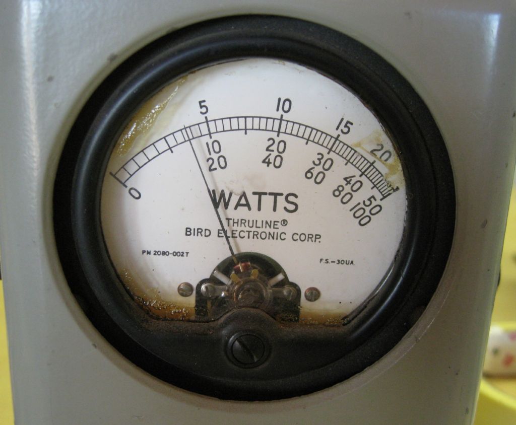

                                    Top scale = 250watts FS – abt 38 or so watts in. (Reflected pwr = nil..)
                                    Around 45watts in ( amp is class C so fairly efficient)
                                    After 20sec
                                    After 50sec
                                    The RF signal source – Two amps in one – 7MHZ and 10MHz, latter changed to 13.5MHz for this test
                                    The test Matching network.
                                    Matching network, some copper coils used with the low-frequency inverters – just cooked the coils due to skin effect and high currents needed to heat aluminium or stainless – insulation burned.match_coils_nozzle.jpg

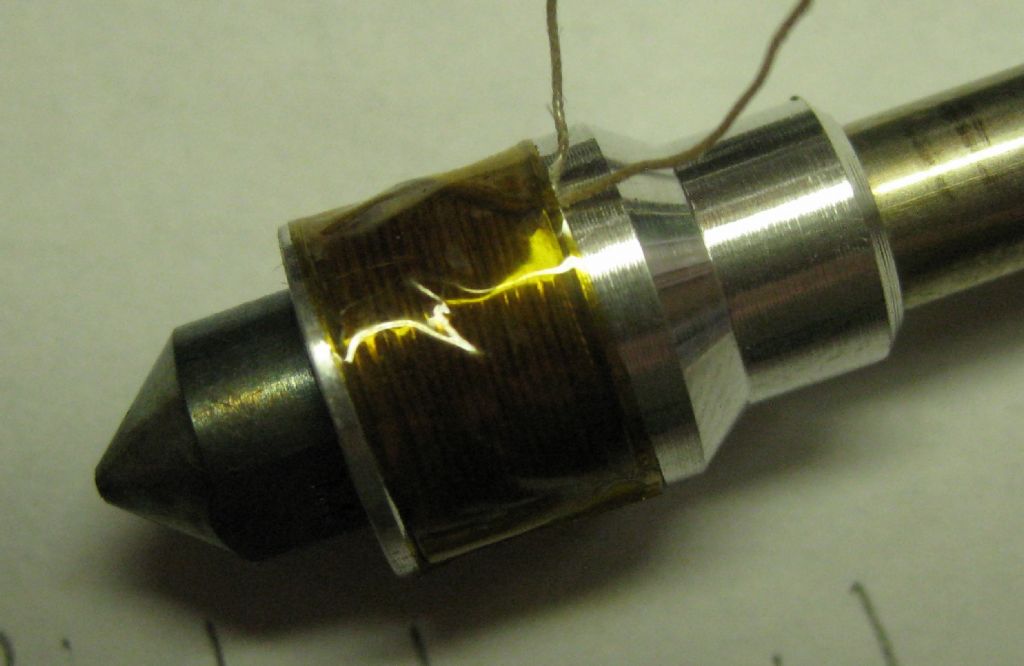

                                    The test hotend- Wire is silver, 0.35mm diameter, 16turns 10.5mm diameter.
                                    uMetal shield for EMI mitigation..
                                    The heat break end.
                                    All in all a resounding success! Now to turn it all into a solid design..
                                    Joe

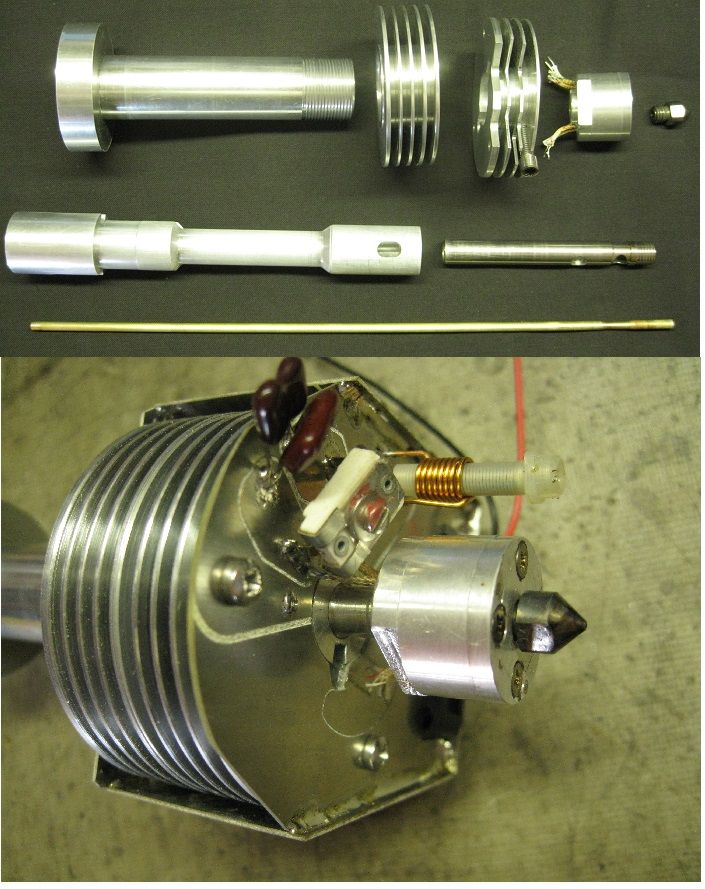

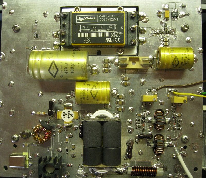

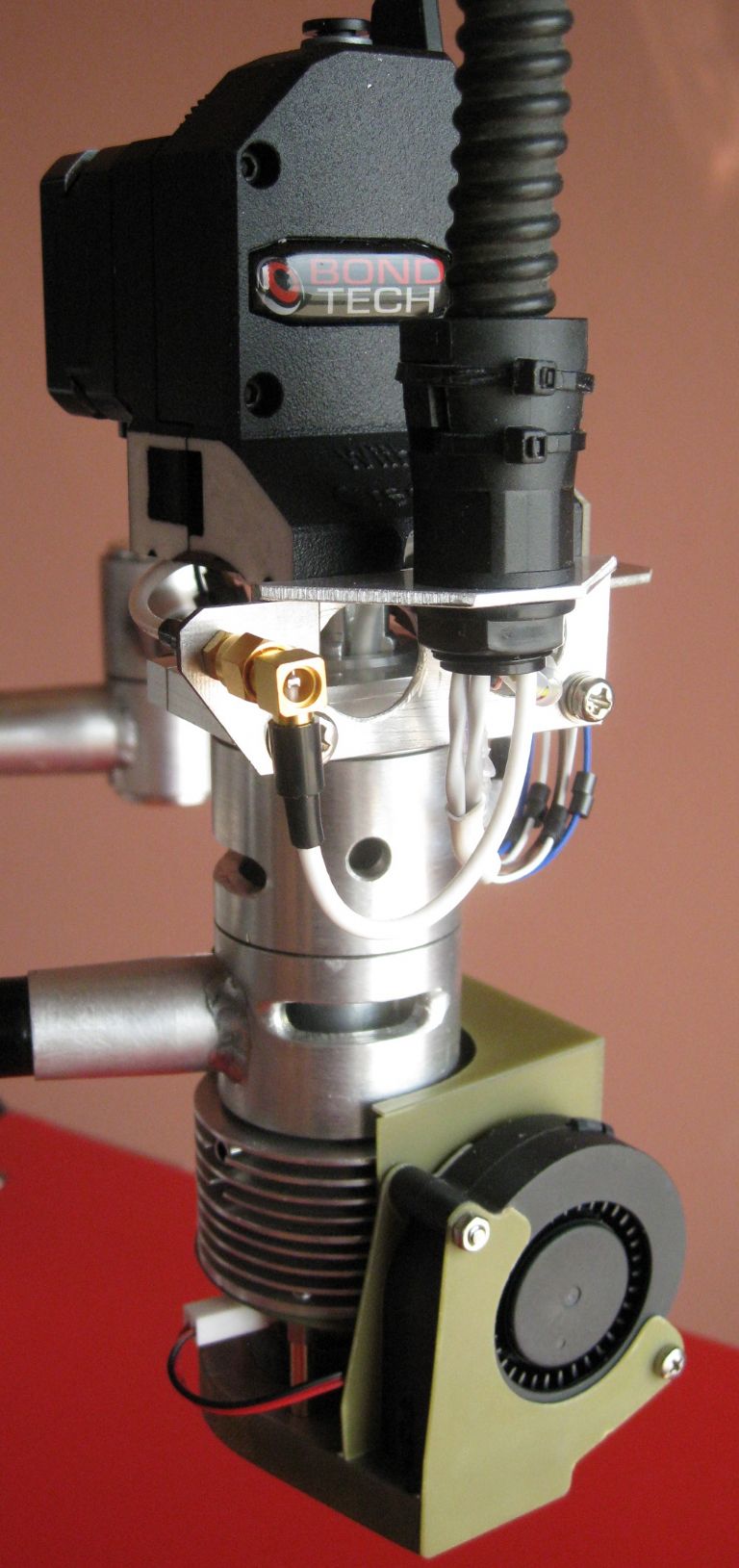

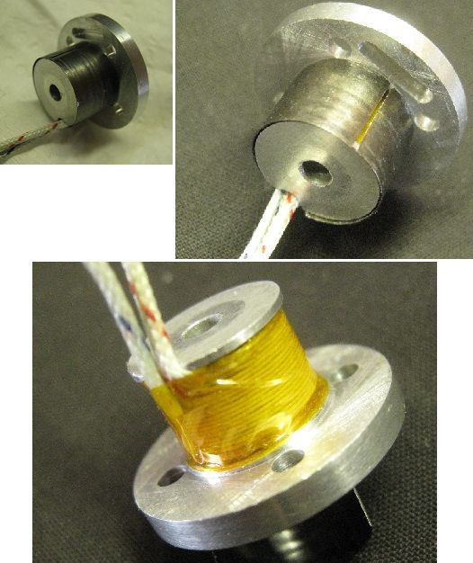

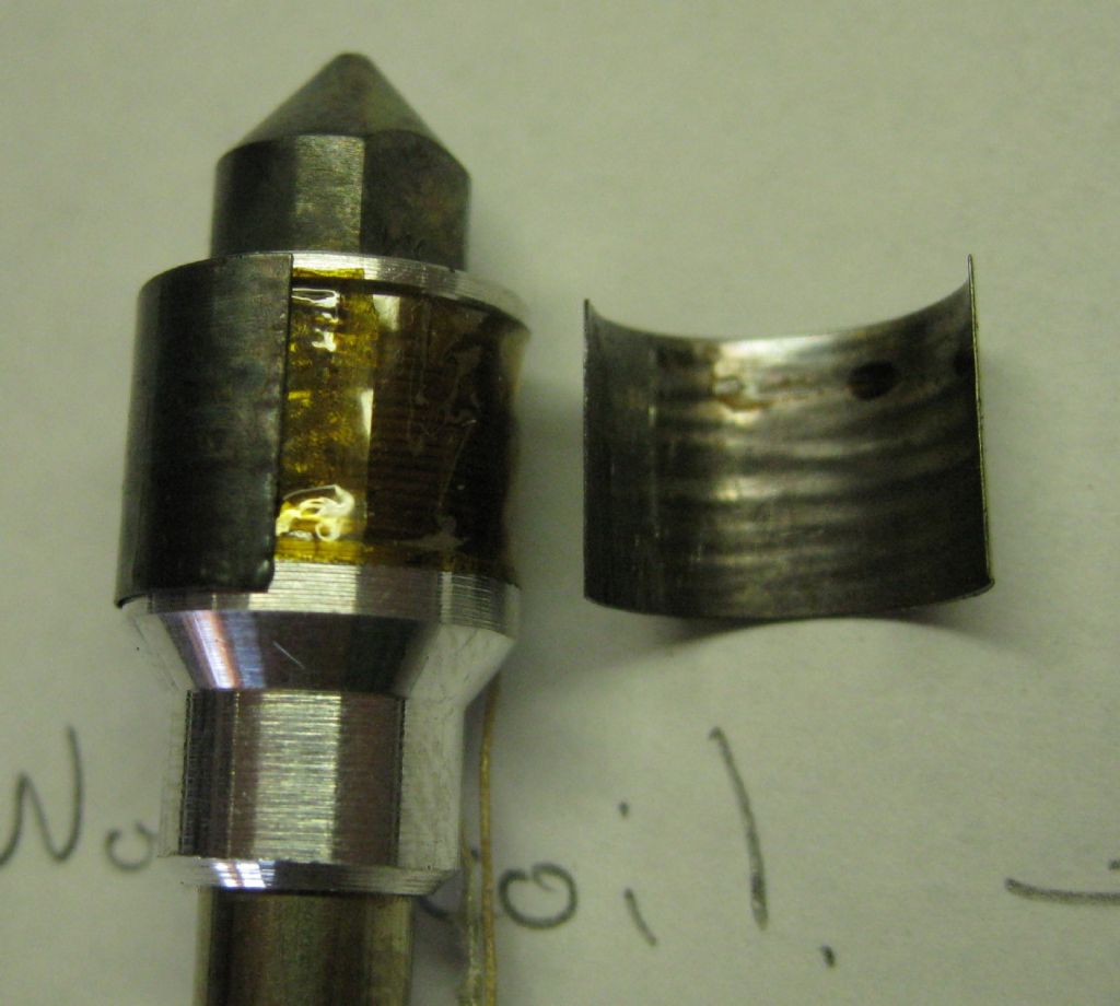

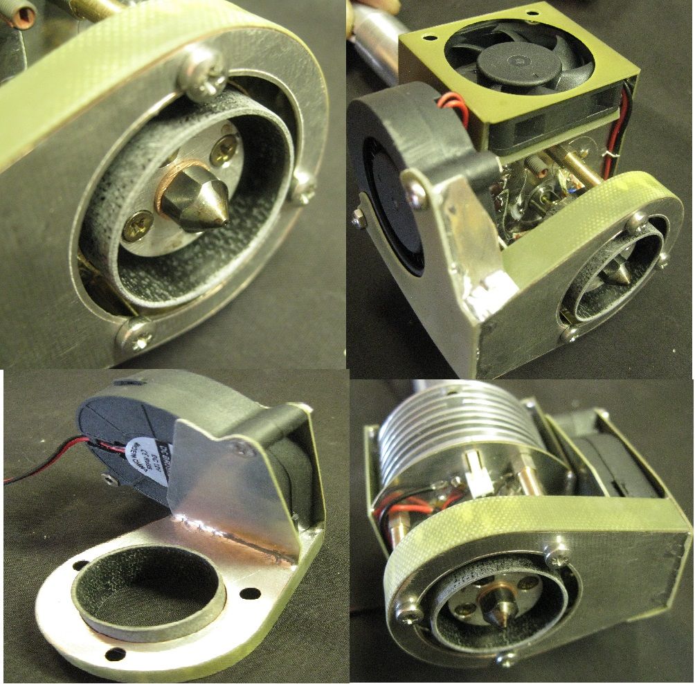

                                      Most of the effort of late has been on the induction heated hot-end. The previous tests showed promise, so a 'proper' hot end was designed and built, and a functional RF energy source made up and all tested. The PID control loop for temp control implemented and everything worked very well indeed. The RF source provides from 5 watts to 75 watts and heats the nozzle end from 25deg C to 200Deg C in 15 sec, and to 350deg C in 35sec. Set to 250Deg C , the PID keeps the nozzle with plus/minus 2 deg with a 40mm 12v fan wafted back and forth across the hot end and nozzle.
                                      Very happy with it all, but like the rest of the printer, a mission, and some much over the top…
                                      I was going to build a dual gear extruder as well, but am now impatient – hobbing the plastic filament drive teeth is too much for now! So looking to get one of those Bondtech extruders.
                                      Some photos:
                                      The RF energy source – power (2watt) oscillator source lower left, power amp transistor to its right, forward and reflected power measurement far lower right. The latter used in a feed-forward loop in the PID to calculate when to back off full power as setpoint temp is approached.
                                      The induction heating coil on the Aluminium hot-end.

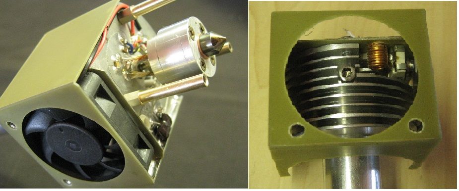

                                      Coil assembly with thermistor. The long tube is the hot end mount and heat-break
                                      Below images:
                                      top – various parts of the assembly, cooling fins, etc.
                                      Bottom – hotend fitted and RF matching being done to match the impedance of the induction coil to the RF generator output. The matching is via LC networks – these will be fitted internally later.
                                      parts and tuning.jpgHeat break cooling fan, and the matching components now fitted internally, behind the cooling fan.
                                      Housings made with 0.4mm FR4 PC board material – a favourite for housings, boxes, etc.
                                      The completed assembly, with layer cooling fan fitted as well.

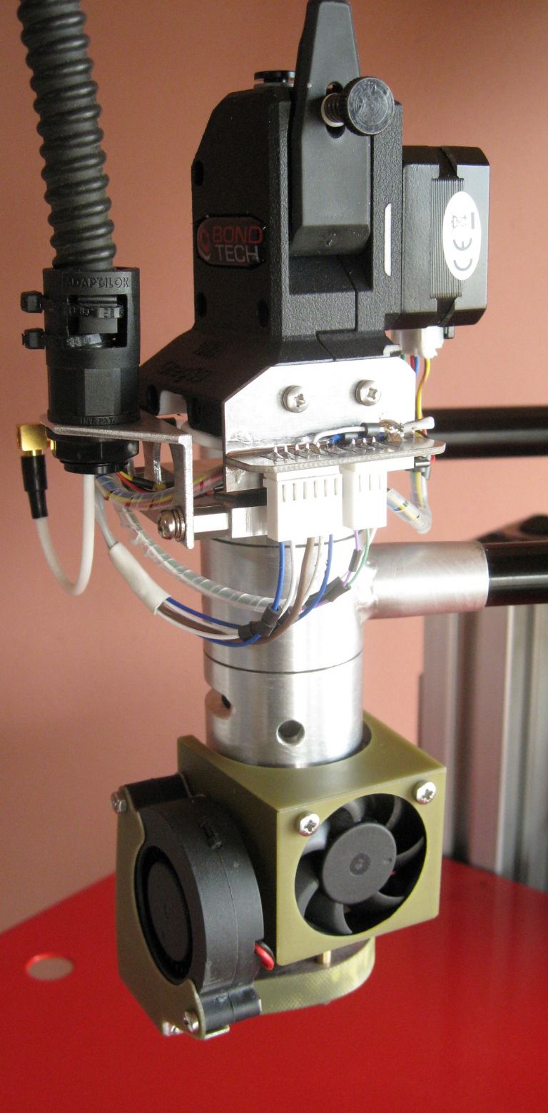

                                      Now for an extruder to be fitted, and to get this lot into the printer cabinet and see what the thing can do!

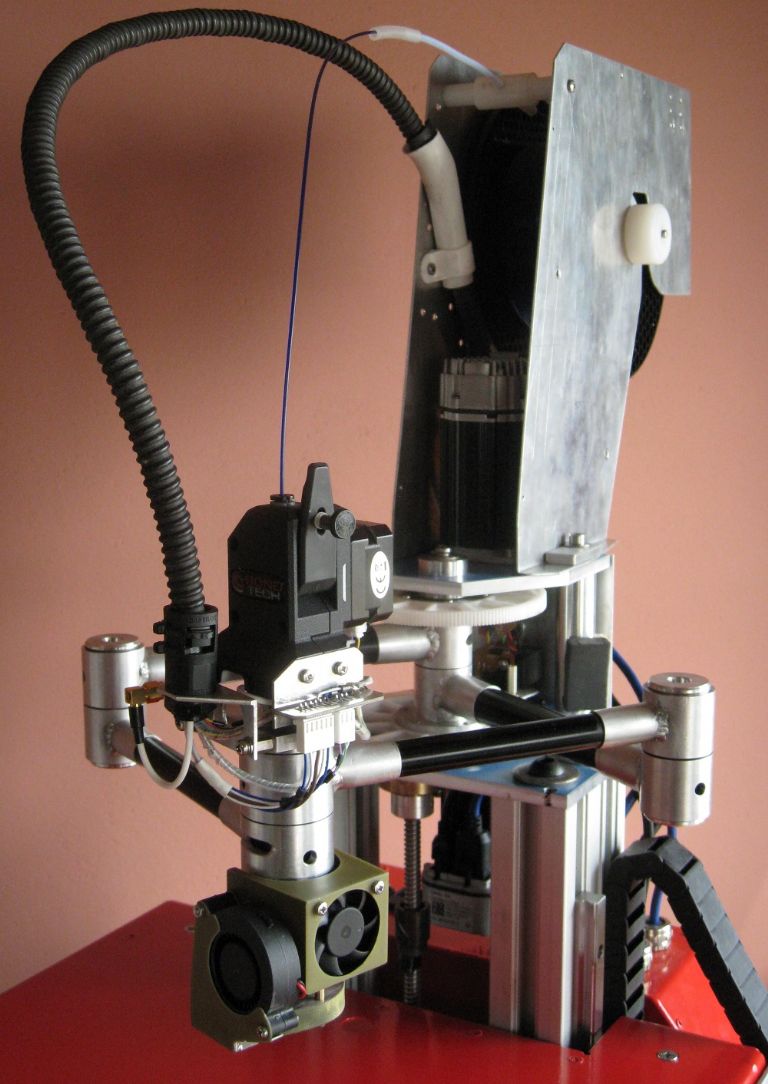

                                      #494340
                                      Joseph Noci 1
                                        @josephnoci1

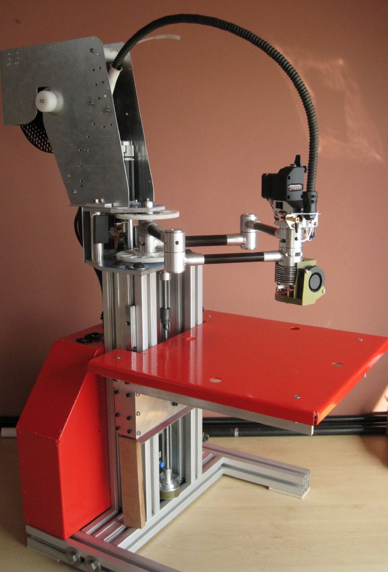

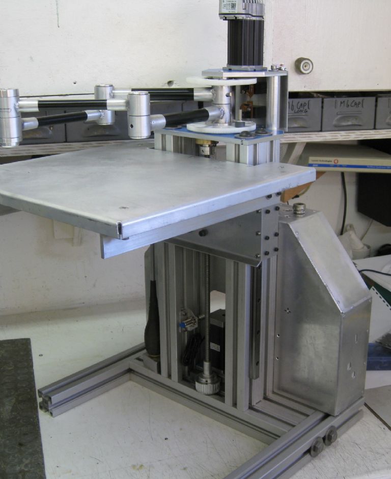

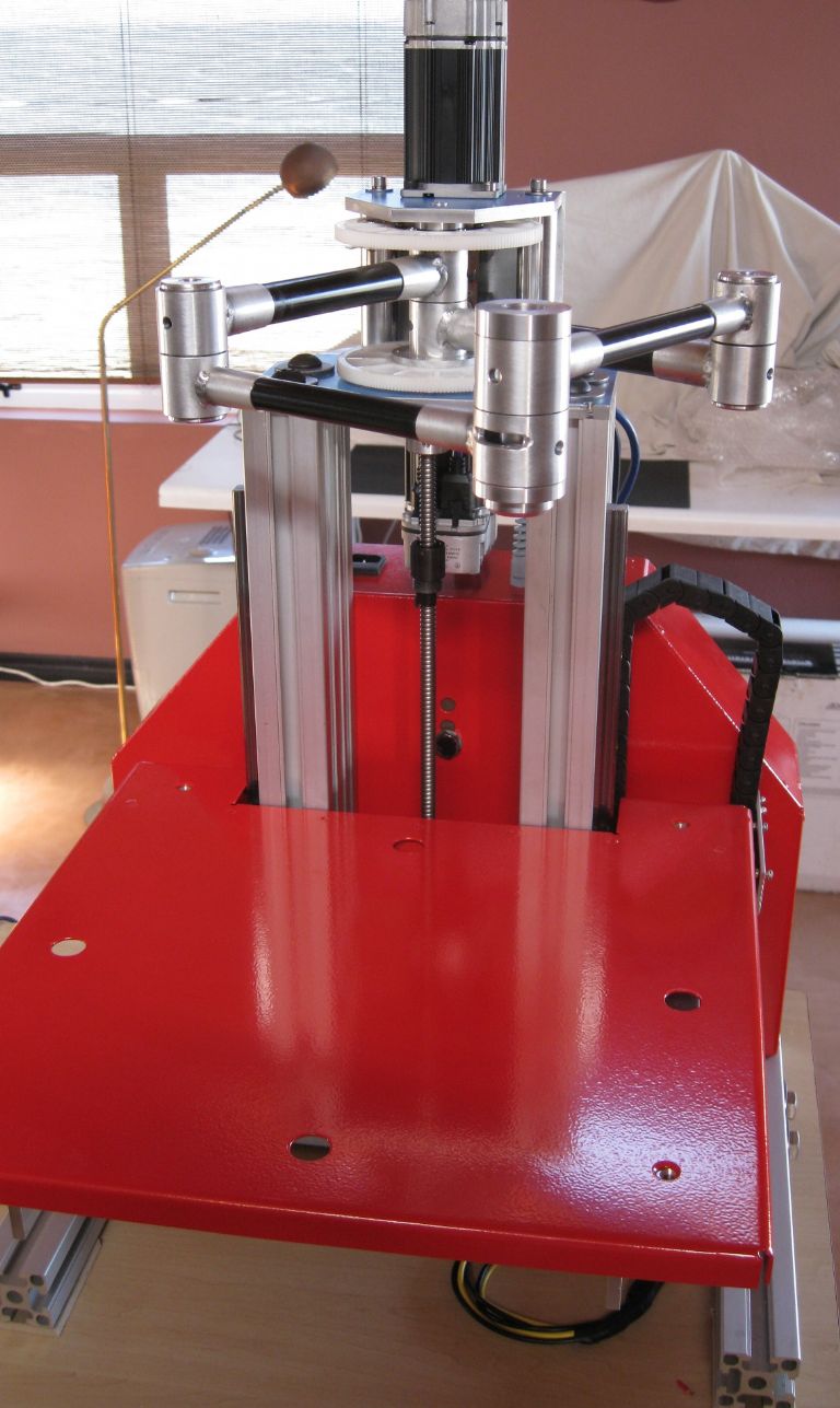

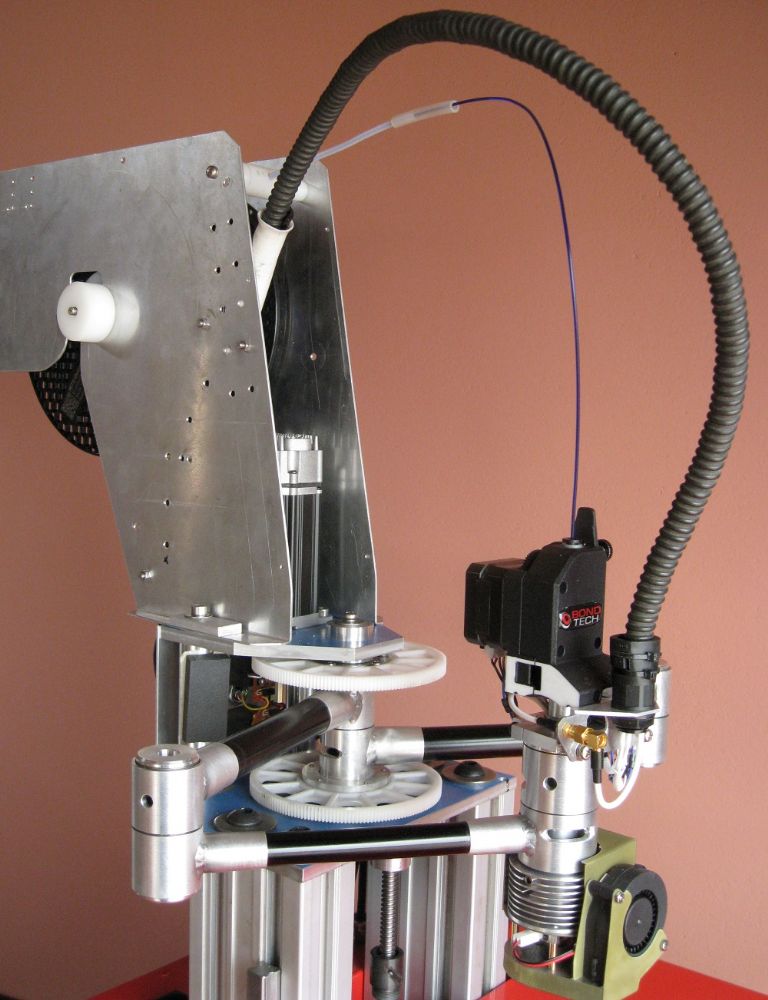

                                        Got to stop feeding Swarf to this thing…else this happens…ready to paint.jpg
                                        Wiring and Coax cable to the induction heated hot-end, the fans, thermister, extruder stepper, etc.
                                        Everything moves, drawing squares and circles with a pen in the hotend position looks very very good, hotend induction heating works fantastically well, extruder is a butchered Bondtech unit from a big creality printer.
                                        Next step to fit the bed heater, bed leveling sensor, and a Nextion based control panel so the PC is not needed.
                                        The leveling sensor to use the Texas LDC1101 – a very neat induction measuring device which will use a sliding ferrite rod ( 1mm diameter) that contacts the table and moves into the sense coil. The change in inductance ( a 24bit value) is easily converted to a distance measurement with 20um accuracy, with 5um resolution, from 40degC to 120degC
                                        Just another over-done sensor excercise…
