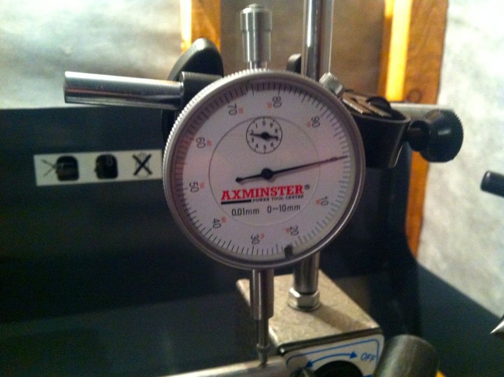

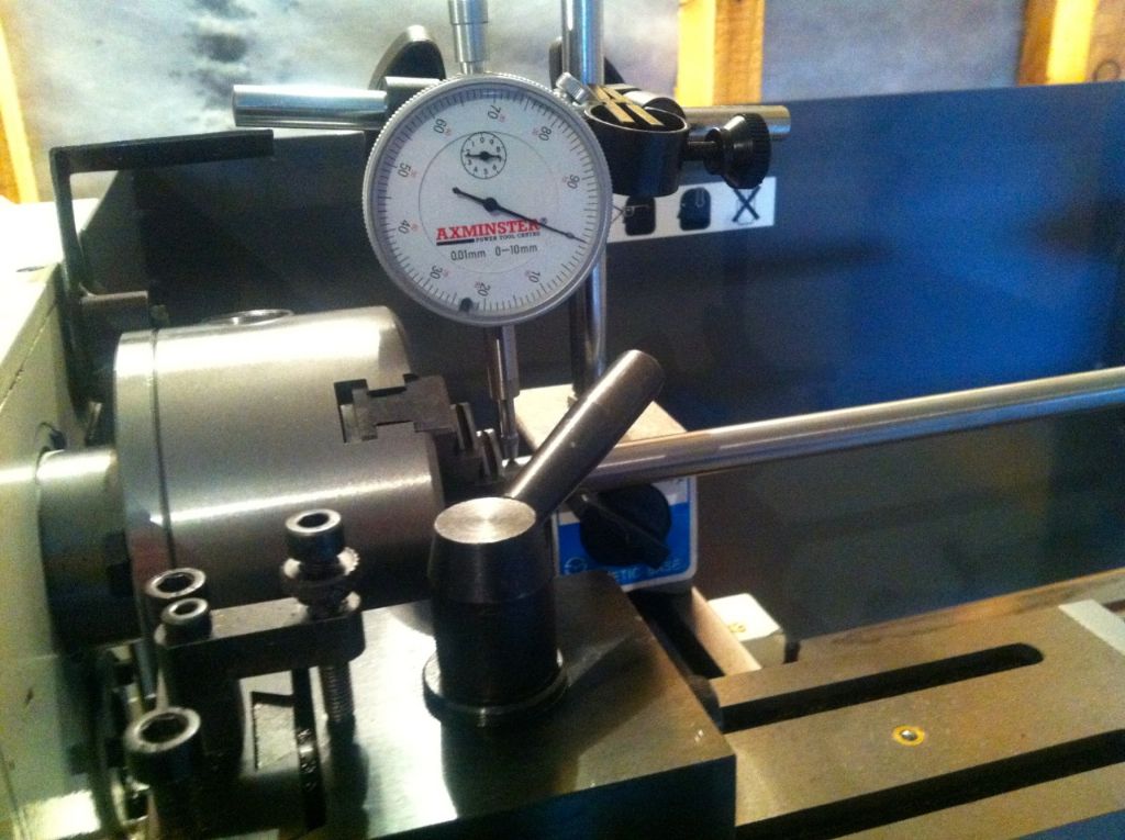

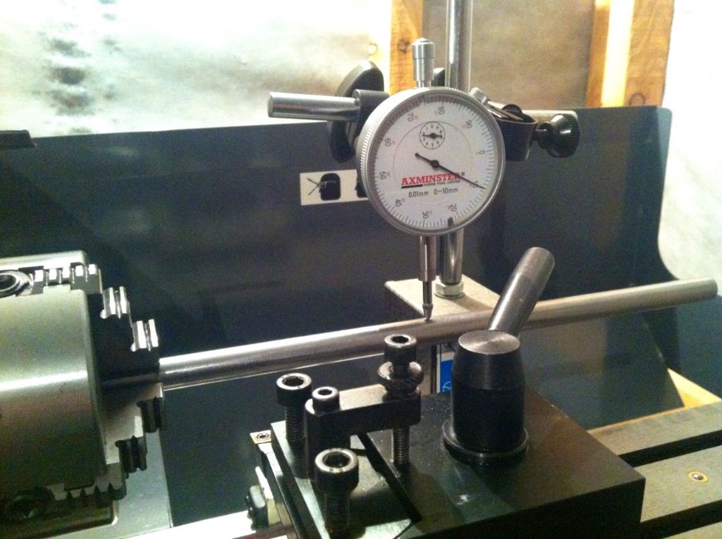

      I was interested to see what my Chucks were like.
      My 3 Jaw Runout figures with the PGMS 1/2" x 12" bar.
      Next to chuck – less than 1 thou
      Middel of the bar – 4.5 thou
      End of the bar – 15 thou.
      That didn't seem too good to say the least although when I took the chuck off there was some tiny bits of swarf on the 'back' fitting surface which may have made a difference.
      The 4 Jaw setup with the same bar using the dial test indicator and same 12" length bar.
      Next to the chuck – about 1 thou – my digital iphone converter won't convert to less than 1 thou..
      Middle of the Bar – 0 thou.
      End of the Bar – 4 thou.
      I could have may be got it a little better, but not much I think.
      Anyways it may be interesting to look back at these figures. As I don't need to turn the complete shaft it's maybe irrelevant here really…

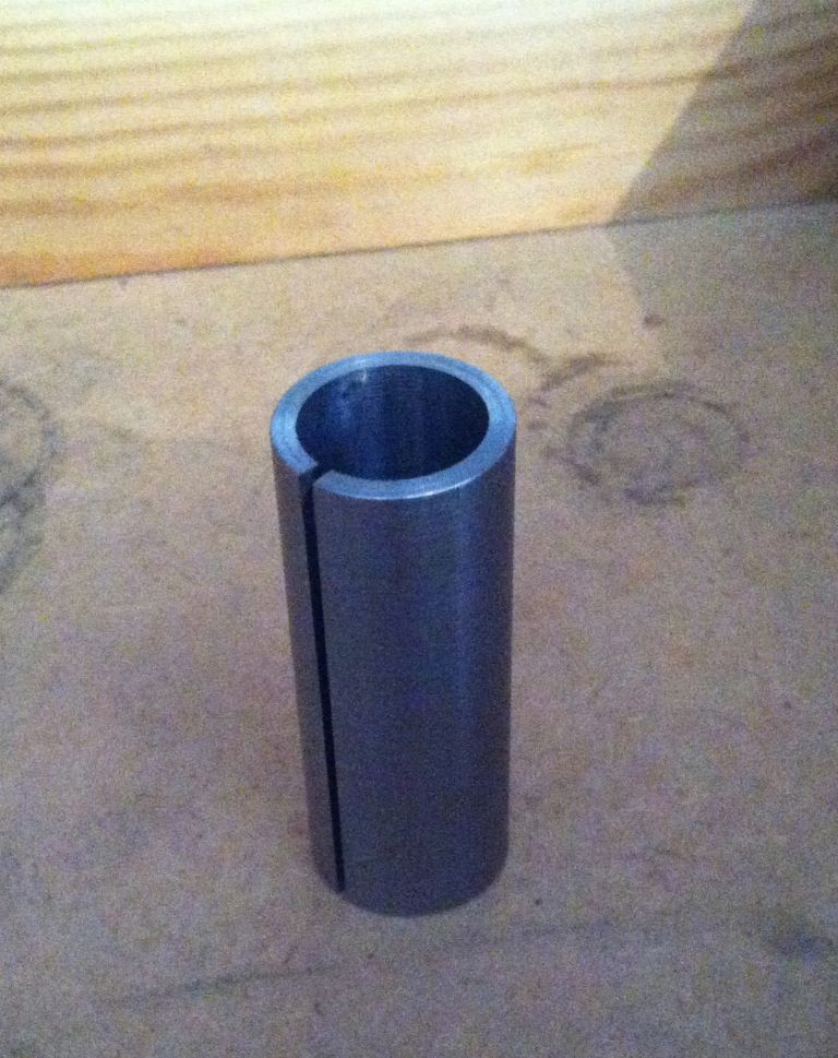

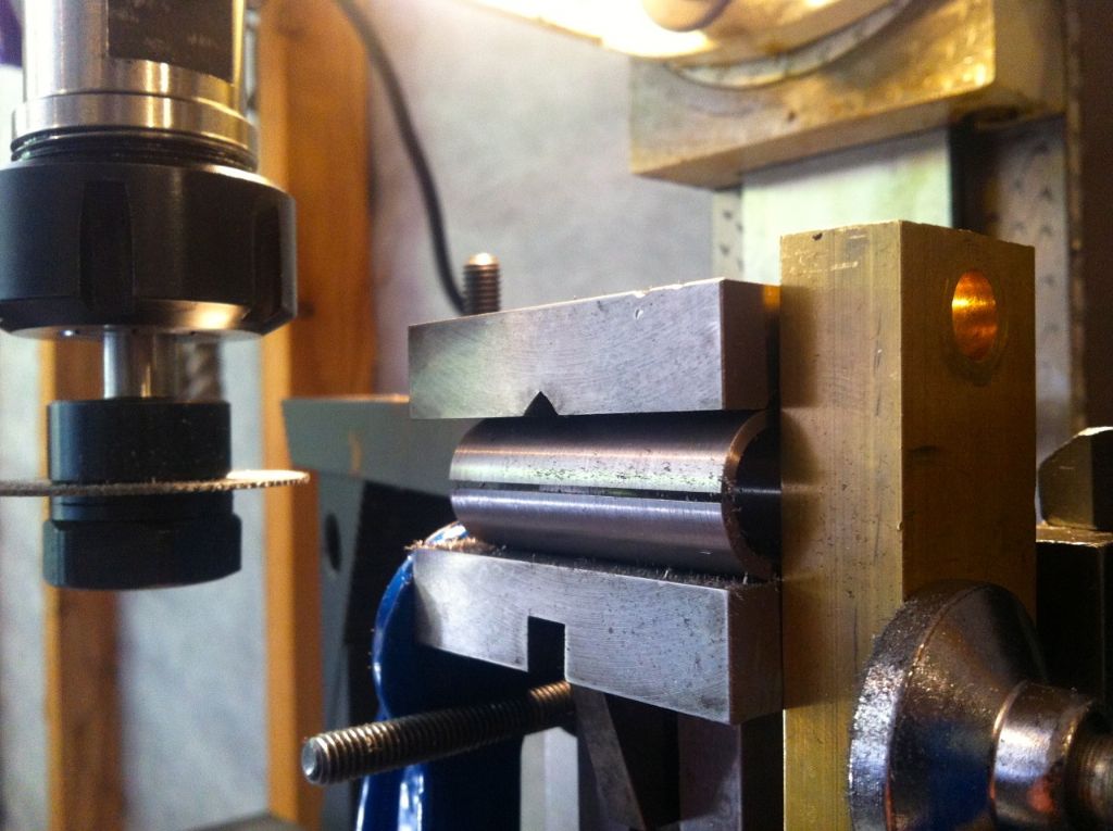

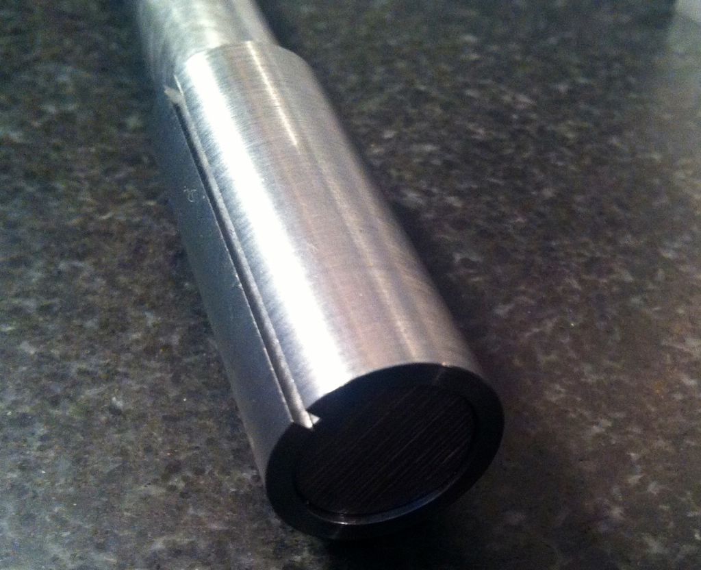

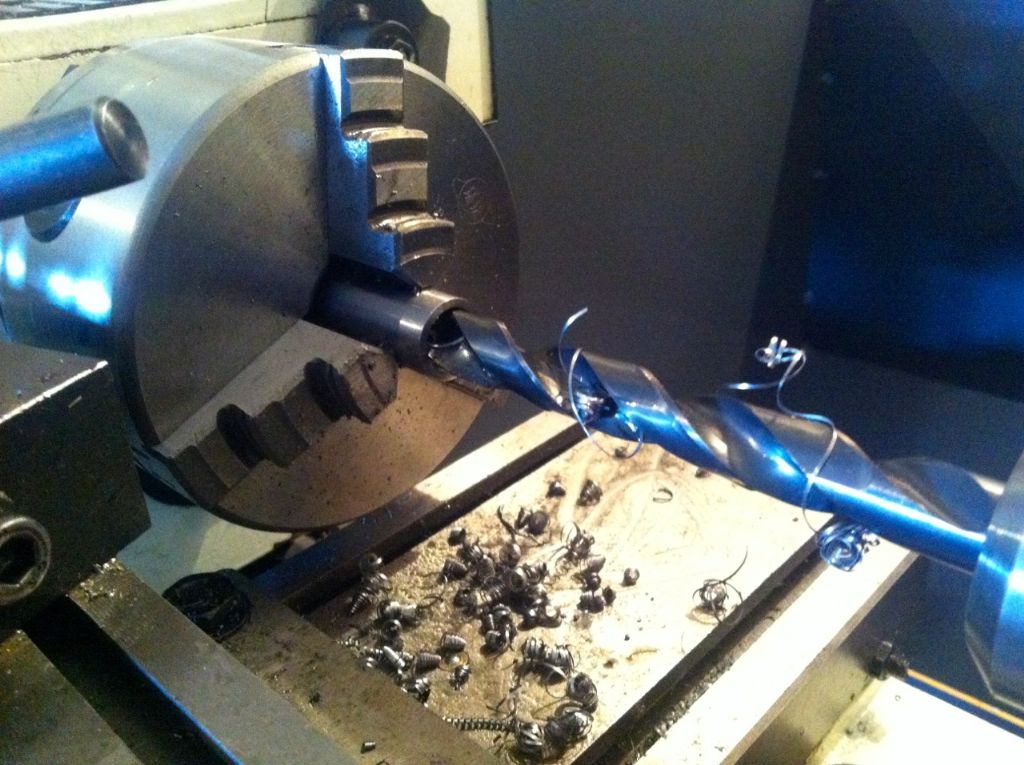

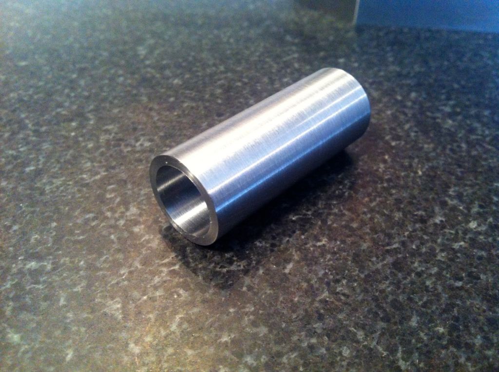

                              Just a little record of making a 'Split Sleeve' for holding and protecting the Crankshaft while making it ..
                              Drilling out the Sleeve after turning down some mild steel bar…..
                              The Sleeve ready for splitting..

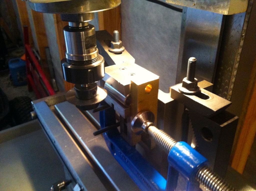

                              Setting up to split the Sleeve with the Splitting Saw.. I'm sure I over complicated this, but it did the job..
                              The Sleeve after splitting..
                              Test fitting the Protective Sleeve on the bar to be used for the crankshaft. With hindsight it may have been better to have made it a little oversize as its a close fit, I wont be using it to turn any diameters, just for protecting and facing out the centre holes – but its a good fit and will do the job as it is – and importantly doesn't mark the shaft..
                              The finished Sleeve.
                              Apologies – if i've used too many photos' for such a simple thing…
                              Regards
                              Allan..

                                      As a point on work holding, that is not the best way to hold a tube when cutting through the tube. When the cutter cuts through the tube it can collapse slightly come loose while grabbing on to the cutter. In this instance it has worked but it would have been better to clamp the ends.
                                      #154650

                                        Again, thanks very much for this – reading your post it's obvious that you are right, why I didn't think to do it that way at the time I don't know, I even thought to clamp very lightly for that reason and was worried in case the work shot out the end of the vice as a result. I'll definitely do as you suggest in future.. Sometimes the brain just doesn't work!

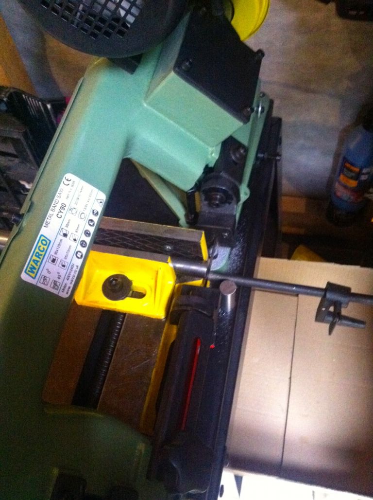

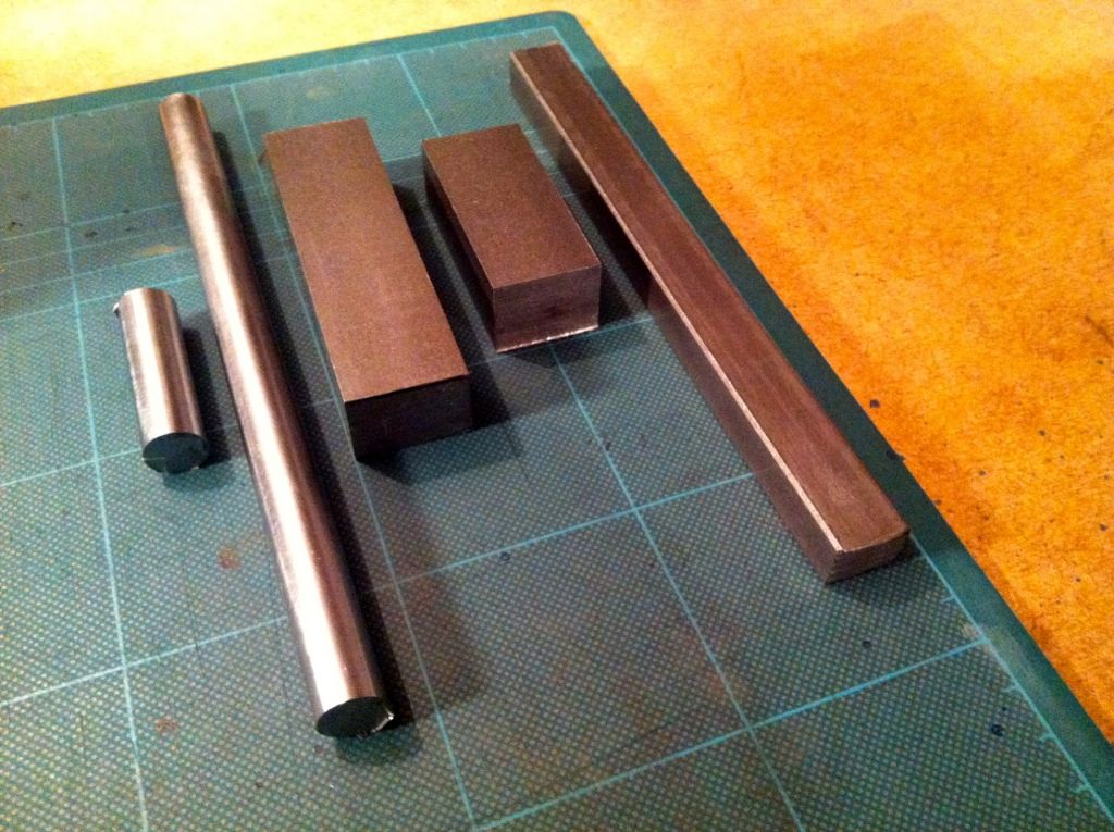

                                        I did get some bits cut to approx length to make up the Crankshaft this morning – the Bandsaw doesn't get that much use but I was glad to have it to cut this lot earlier..
                                        edit – I forgot to say that I had to take a skim (0.1mm) with the boring bar off the sleeve that I made – it was too tight, I had initially used the reamer. Now it seems perfect and slides, tightens and releases easily. Something I will know (0.1mm oversize) to do in future when doing similar..
                                        Regards
