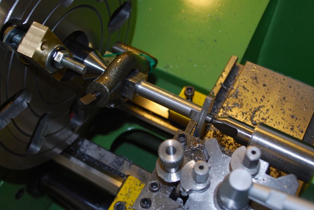

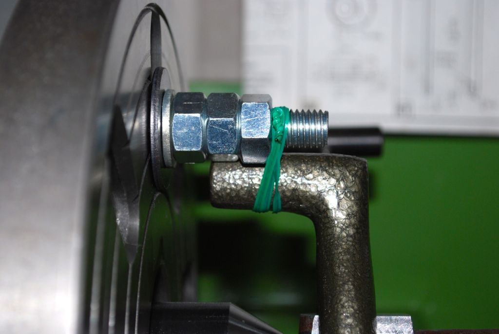

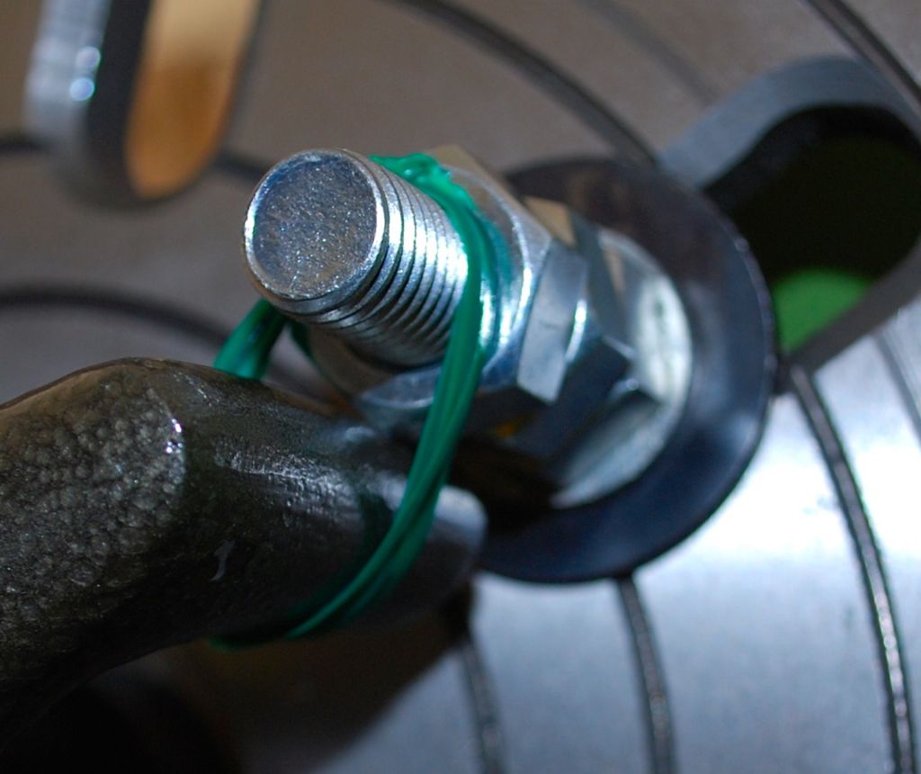

      Garry,
      Regarding your pic showing the driving dog. When the faceplate bolt is driving the dog is there direct metal to metal contact between the two or are you relying on the drive going through the tie? If it is then I would be worried that this could be a source of chatter. To my mind the tie ought to be just holding the driver and driven in metal to metal contact, but I'd be interested in the views of the more experienced on the forum.
      Steve
      #191398
      GarryC
        @garryc
        Hi Steve
        Its not very clear in the photo but yes there is direct contact with the nut and leg – the dog cannot get through..
        This photo is not that clear either but you can maybe see a little better (the dog's leg is oval in shape).
        You are quite right to say not to rely on the tie for driving..
        Thanks for continuing to follow along…
        Regards
        Garry

          Garry
          Do you not have a straight leg driving dog rather that the one you have there; it looks a though there is very little contact albeit they are touching, you need a positive contact rather than the corner contact you have now…
          Cheers
          George
          #191410
            Looks like you are pulling the dog round by the tie, should be on the other side of the stud so it is pushed around.
            I tapped a couple of extra holes in my faceplate so a drive peg can be screwed in nearer the middle. You can also just use the spindle flange with a stud through one hole and a nut either side to drive the dog.
            J
            Edited By JasonB on 27/05/2015 18:34:07

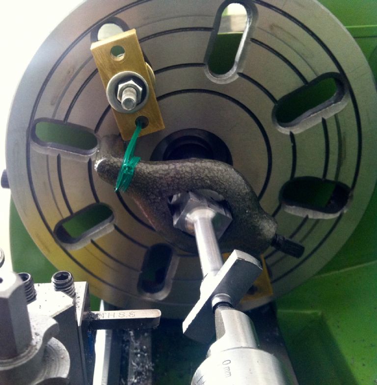

              Hi George and Jason
              My fault with a bad camera angle which is not helping – this is probably a better one below – but after your concerns i'm going to change it…
              Thats a good idea Jason to tap the face plate, my holes always seem to be a bit further away from the centre than I need when I try to drive it, my last lathe was even worse – also a good tip driving directly off the flange. I'll remember that, think that will come in useful.
              Many thanks to all of you – and its good to know someone is looking at the photo's!

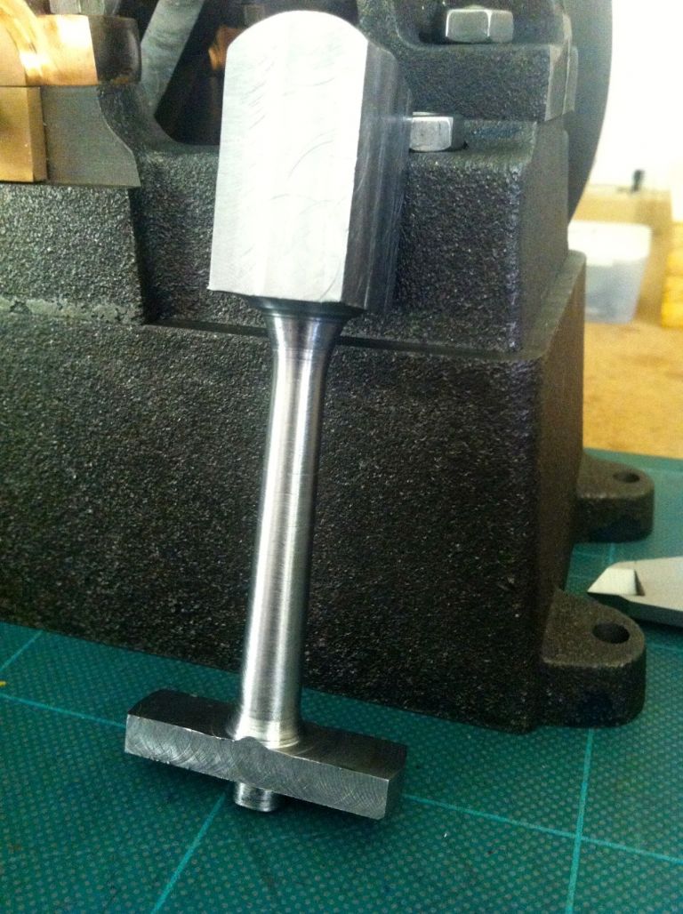

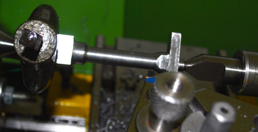

                        Just a quick photo of progress this morning.
                        I haven't got much further, been very enjoyable (and challenging) today and to be honest I've been struggling! Biggest problem is using the round nose tool in order to get the radius's on the shoulders and to turn between them – I'm using a piece of tool steel I rounded myself and its not very good! I have got an indexable button tool that I put away somewhere after having trouble with it digging in last time I used it – can't find it now of course. I'm getting the same problem with the one I'm using as well, this one is much smaller so I thought it would be less of a problem..
                        I have done the Bearing register and foot and almost have the rod diameter parallel – and my compound slide does at least have enough travel so that I can use it to do the taper..
                        At the moment though I'm having real trouble though just getting the tool into the material to put even a tiny cut on to finish getting it parallel before starting the taper..
                        I hadn't released the material to come off for sizing the foot would need to be off the top otherwise I wouldn't yesterday have put in the small flat on the diameter, thinking I needed to for the fillet – should have left it alone it would have sorted itself out in sizing the foot.. So my fillet is going to be a big one I think!
                        Cheers.

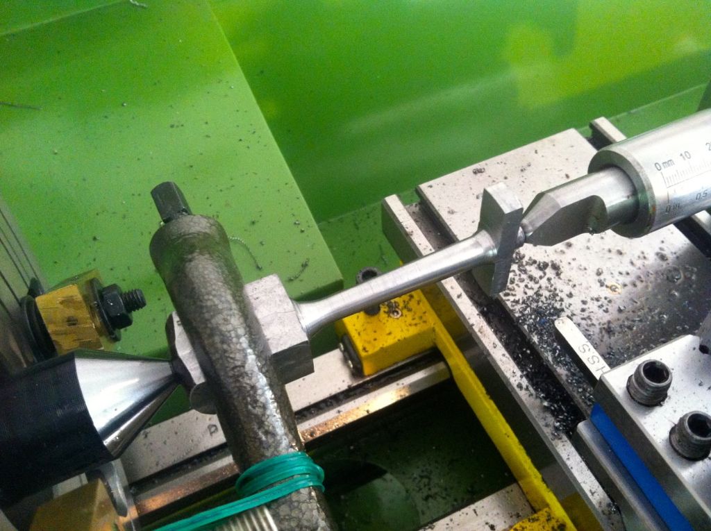

                                                    Just a quick session today..
                                                    It was definitely much easier and quicker to use a normal tool for most of the bar and then to switch back to the round nose to sort out the rest and then with just a light cut to the entire length. I didn't have a 'straight' tool so couldn't get very close in to the shoulders.
                                                    Only had chance to do the one corner but at least the radius is beginning to show. Still finding it difficult to stop the tool digging in and so went at it very slowly and lightly. Once the other corner is done I can try the taper. My compound slide is a bit stiff to use so no idea how that will turn out yet! it felt like it was good practice today though as most of it was done manually (i.e. not auto feed).
                                                    Cheers.
                                                    Garry.

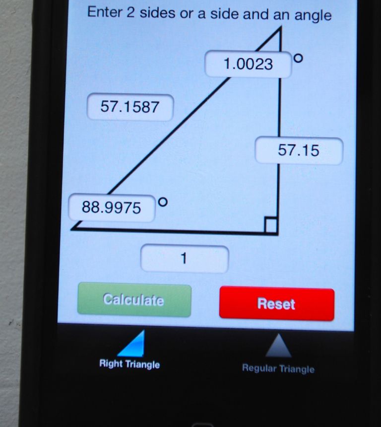

                                                      Managed a bit of mess up this morning – and its been bugging me all day as I couldn't understand why, but its just sunk in now I think – or at least I hope I'm understanding correctly.
                                                      Its come down to me missing the fact that my cross slide dial is one that takes off exactly what is says on the dial 0.04mm (ie. you don't need to half it, as I did on my last lathe) – its meant that I was starting the taper too far in (25 marks on the dial instead of as it I should have 50 marks on the dial – idiot! I thought I had simply worked out the wrong angle but no I think the 1 degree on the compound slide was correct and it should have taken me from 10mm diameter down to 8mm over 2.1/4 inches – if I had realised I needed to account for the cross slide dial being as it is..
                                                      Sorry to waffle on I bet I'm not explaining that very clearly. Anyway the upshot is that my taper looks not too good, it was too late before I realised the mistake to sort out properly! I hope though that I can still use it, I've gone about 14 thou undersize on the little end (Big End is ok) – hopefully not weekend it too much, and to me the real thing still looks just about ok and again better than the photo, but thats only because I don't know what it should look like I guess. Does anyone think I need to start over with it?
                                                      The figures that I used..
