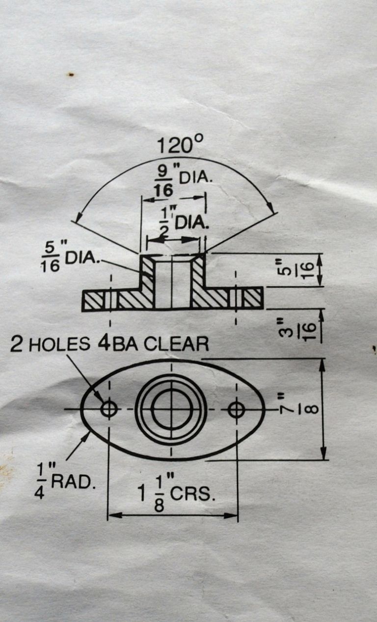

        My transfer punches set has turned up and I now have the column fitted – I can see they are going to come in very useful, should have got some before.
        Next the Piston Rod Gland. These are pretty much the same as I did for Victoria but much larger. Think I did the fixing holes on Victoria by eye as they were so small. As they are bigger this time I wondered how to do the them more accurately. The glands are elliptical and whereas I know how to find the centre and axes for an ellipse on a flat sheet of paper this is different of course. Setting the boss to run true on the lathe and drilling means you loose the centre to aid in finding the axis for the fixing holes later? The boss would seem to be in the way for marking out on the 'front' (parallel sets of chords etc) and if marked out on the back – well you need to turn from the boss side? Sorry I'm sure I'm being very stupid again. If anyone has any tips I would be grateful. Maybe I will have to do them by eye again.
        The Piston Rod Gland Drawing.

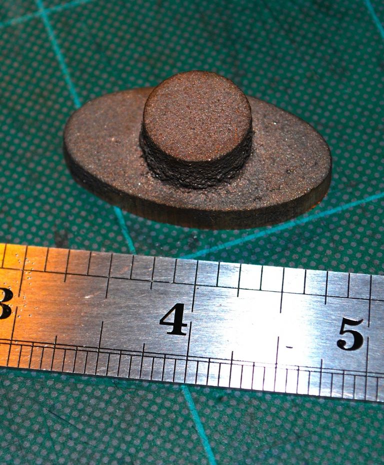

        The Piston Rod Gland casting.

          You might try placing 2 vee blocks in a mill vise, and put the small end radii of the gland casting in the vees. The centres of the small radii (and hopefully the boss) will then be aligned along the long axis of the casting. After you find the centre of the boss along the long axis with wiggler or centre finders, the boss and side holes can be drilled accurately using the mill handwheel dials or DRO if you are lucky. No markup required – best kind of layout job!
          If you want to machine the side radii the easiest way is to make up a plate jig for the lathe and bolt the part to it via the side holes. The drawing does not note the dimension of the side (larger) radius so you'll have to calculate it of do a drawing on paper or CAD to figure out the centre and offset distance to mount the part off centre to the chucking shank on the back of the plate jig.
          The small radii will need to be done on a mill with a dividing head or just filed to shape.

          #189863
            I really would not worry about the geometry.
            Hold in 4 jaw and get the spigot to run as true as possible then machine that to 9/16" dia and 5/16" long. Drill and preferably bore the hole and finish with a reamer, add the chamfer.
            Turn it around and hold grntly by the spigot to take it back to 3/16" thickness. Now while its still in the lathe blue the end and set it by eye so its as horizontal as possible and use the lathe tool to put a couple of hoizontal lines. Pop a bit of 5/16 rod into the hole and touch your tool against it then wind out 0.406" and gently rotate the chuck by hand so you swing two small arcs at 1.125" dia.
            Punch mark the two holes. Now you can drill the holes followed by making a couple of 1/2" filing buttons to shape the two ends and then just blend into the sides.
            An alternative way to mark out would be with a height gauge or scribing block first at ctr height and then with the point raised 9/16 a bit like I described here
            There are a couple of other ways to shape a gland either by offsetting in the 4-jaw or with a boring head but a bit of file work is all this needs for this one, the other methods are better if cutting from solid rather than using a casting, I'll find a photo or two later.
            J

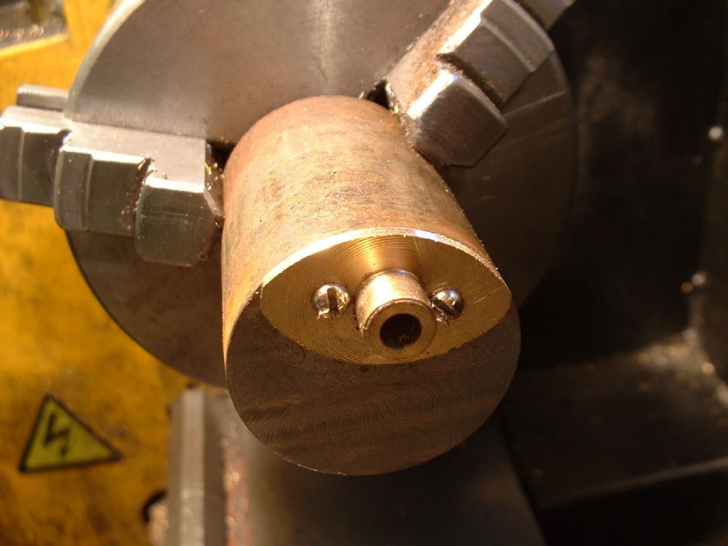

                In the past I machined the glands thus, grip spigot in the 3 jaw chuck and take a clean up skim,
                then drill and ream to size, mount on the end of a short piece of brass rod with Loctite, the diameter
                and face can now be turned.
                If the lathe speed is now dropped to its lowest a smooth file will clean up the ellipse edge, with care
                of course, If you know your lathe centre height the gland can be set by eye and your height gauge
                set at lathe centre a line can be scribed across the gland, then turning the chuck thru 180 degrees
                scribe with the height gauge set to the hole centres.

                  I forgot to mention that gentle heat applied to the brass rod will soon free it.

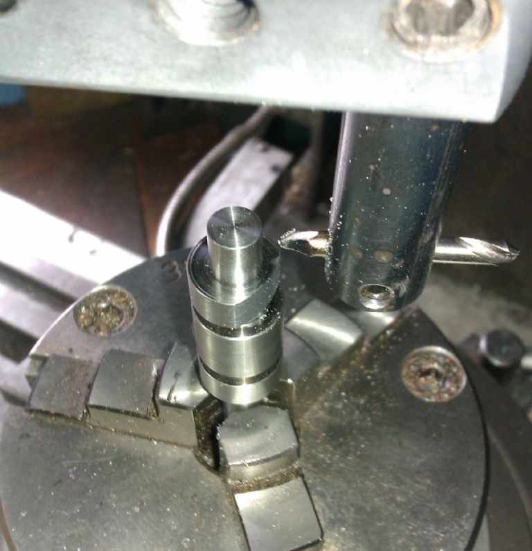

                          And two completed "castings" and glands done with a boring head

                                                      Bit late but I found this photo of the boring head being used to do a gland, the washer is to save catching the chuck jaws
