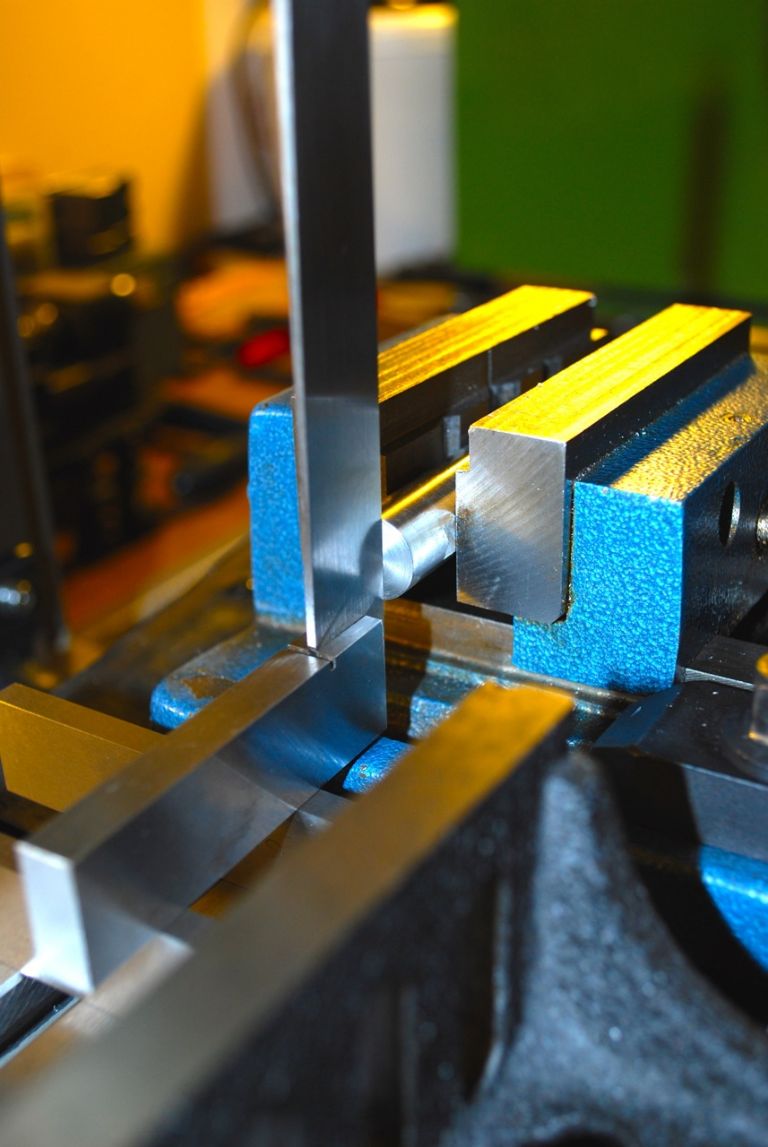

          Nice work Garry.. Just a couple of observations… you shouldn't need lubrication on cast iron, especially oil, it should always machine / drilled / milled dry, it has self lubricating properties to a certain extent, as I could see, the cuttings were clogging the parting off tool due to you using oil, not helpful. the chips / CI dust should be falling away freely. From the sound of it was your parting tool dead centre height as it seemed as though it was rubbing along with cutting action?. you can safely up your speed next time -150 – 200 rpm wouldn't hurt, personally I would have supported the initial cutting with the tail stock centre until you reached full circumference contact as the hammer effect at your speed may have knocked the eccentric out of the jaws… fortunately it didn't.
          Like you ( & no doubt a few others ) parting off under power had always filled me with trepidation, even at my advanced years until I got this machine where I practiced & practiced until I feel a lot more at ease with it now. No doubt some members will disagree with my comments but hey! what are the forums for. Never the less well done, super write up thumbs up.
          George.
          #211203
          GarryC
            @garryc

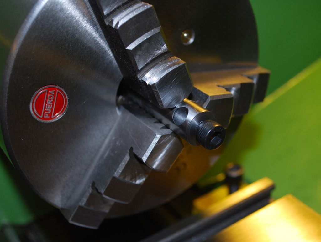

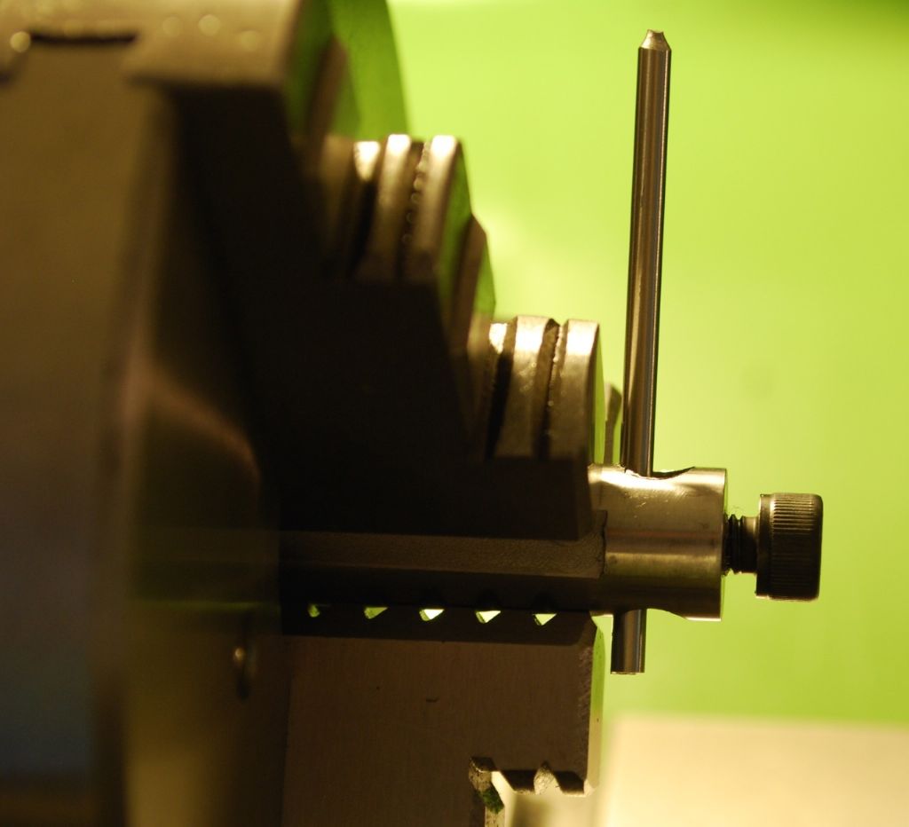

            Hi George
            Many thanks for this, all really useful and taken note of. You set me thinking about the tool height and after double checking I can see it was slightly too low..! As you can hopefully see in the photo below the carbide insert has a 'flat' spot just at the cutting edge and I hadn't set the height on it correctly beer smile I'l be more careful in future..!
            May need to enlarge this a bit as its not a very clear photo – the flat cutting edge is just tucked under the centre tip..

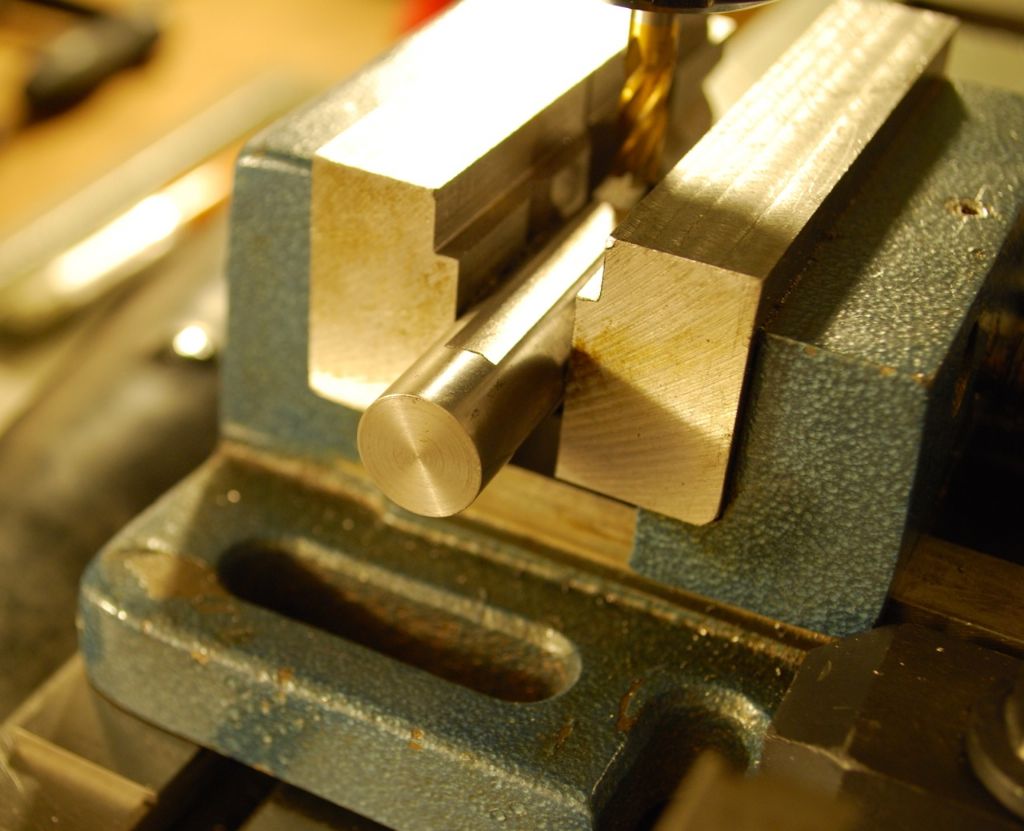

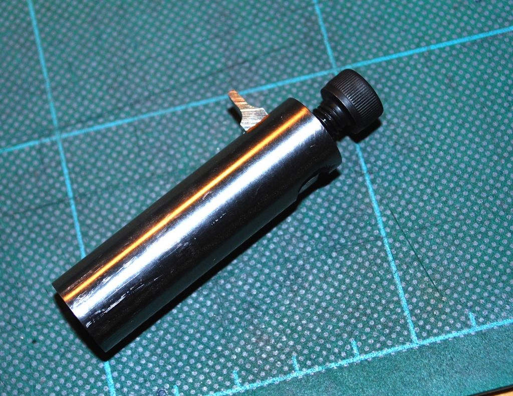

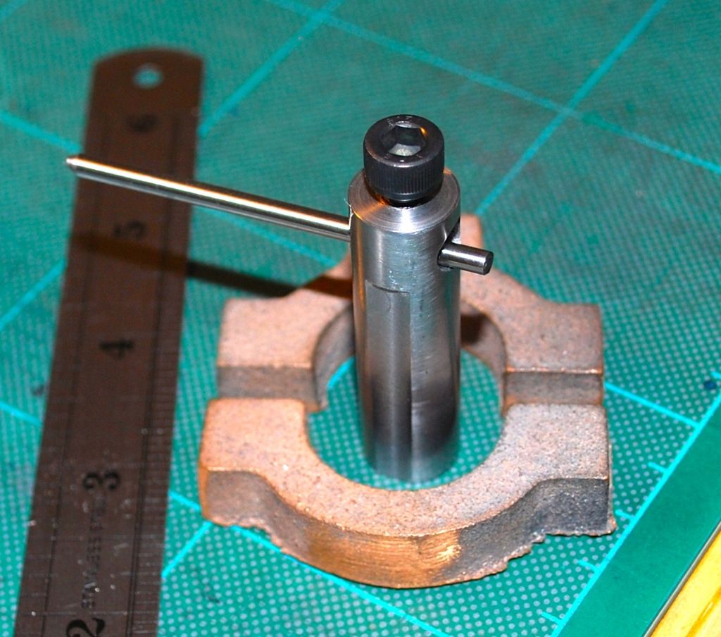

              The Tool Holder for the internal groove in the Eccentric Strap, (I've probably put too much detail here for this..).
              This I've not been too fussy over using a short left over piece of bar that I had – not ideal really but its saved turning down a longer 1" diameter, which seemed a bit wasteful, I've not even turned the outside diameter..
              Starting the Tool Holder by first putting on a small flat with the Mill
              Then rotating the flat through 90 degrees for drilling the cross hole for the tool piece.

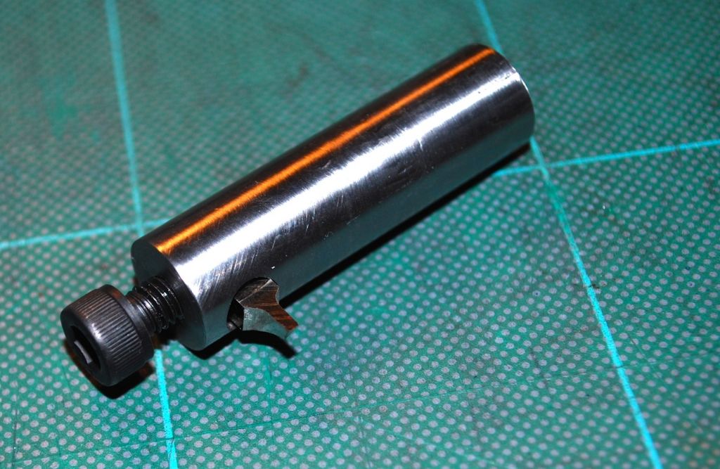

              and then onto the lathe for drilling and tapping for an M6 Cap Head screw
              it should enable a variety of tool bit thickness to be held – iI'll probably grind the tool for the strap groove from a larger and rectangular section of tool steel. Hopefully not too difficult to do just some front and side clearances and no top rake for the Gun Metal strap..
              it would have been more useful I guess to have made a longer one – I need to order in some more spare bar stock again..
              The finished tool holder and the Eccentric Strap castings as supplied – Gun metal. Hopefully it will work ok..
              tomorrow I'll have a go at making the tool bit..

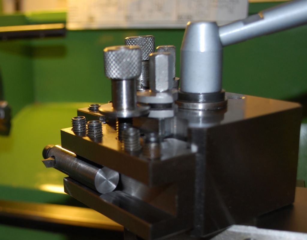

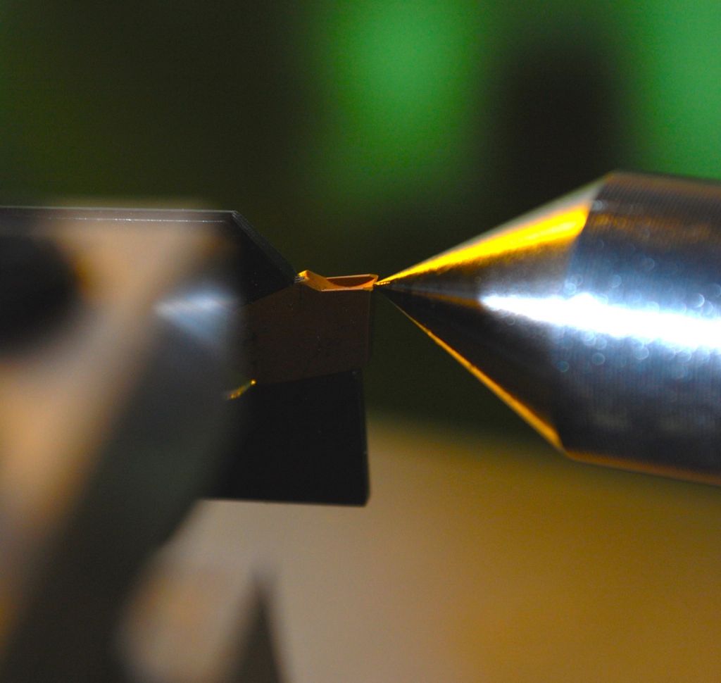

                  Thanks Peter, managed to make a tool bit earlier that will hopefully work for the eccentric strap groove so yes all going well smile
                  But as far as progressing here any further I get a pretty strong sense from your very useful and interesting 'build thread' that the build is really not wanted here at all – I've been assuming that building a model engine on a forum advertised for Model Engineering would have been as natural as seeing a F1 car driving around Silverstone – but hell no..!
                  My last sterile pics…
